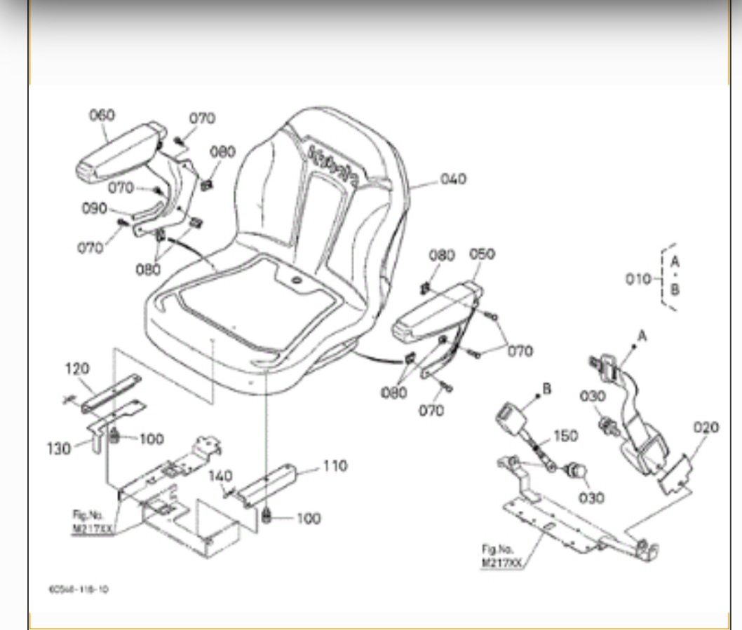

Seat bolted in on the B2601.. Yeah my long, old not so bendy legs, could us another 2 or 3 inches of foot room. So I was wondering if any one had a blow up of how the seat is set to the lower bracket. My thought is maybe a couple pieces of 1/8 flat stock or maybe just drilling some new holes in the existing plate. So I am asking before I begin with reckless disreguard

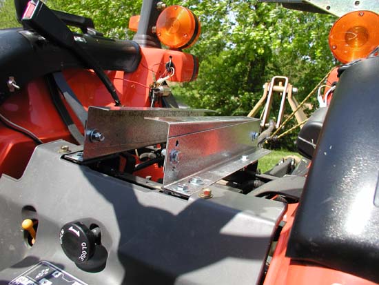

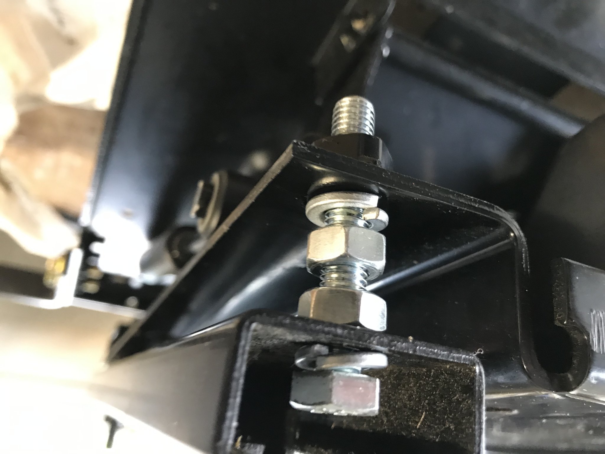

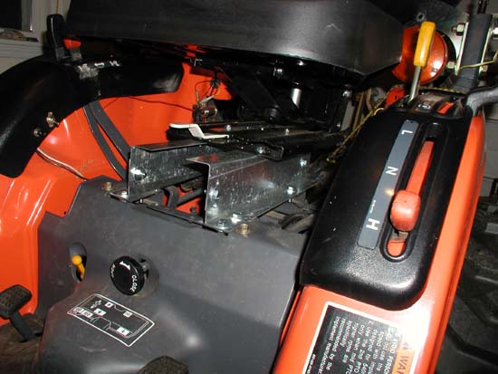

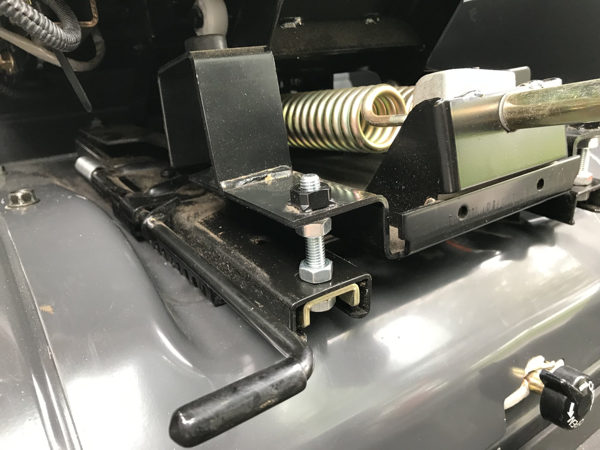

I've done something to the seat on every tractor I've owned. Could be none of this is directly applicable to your seat, but maybe it'll get your creative juices flowing.
Below are the mods for the B7500 and the L4240. The B7500 was kind of cramped. The seat wouldn't travel enough for comfort. For that one, it was a set of adjustable bent angles to remount the seat higher and back a bit farther.
The L3200 felt like the seat really wanted to dump me forward. The vinyl seat made it worse. I raised the front of the seat, similar to the pictures of the longer bolts pictured on the L4240.
The L4240 felt like it needed a slightly raised front. It was fairly easy to add longer bolts and adjust it to suit. The combination of the cloth seat and having it canted back slightly make it very comfortable.
