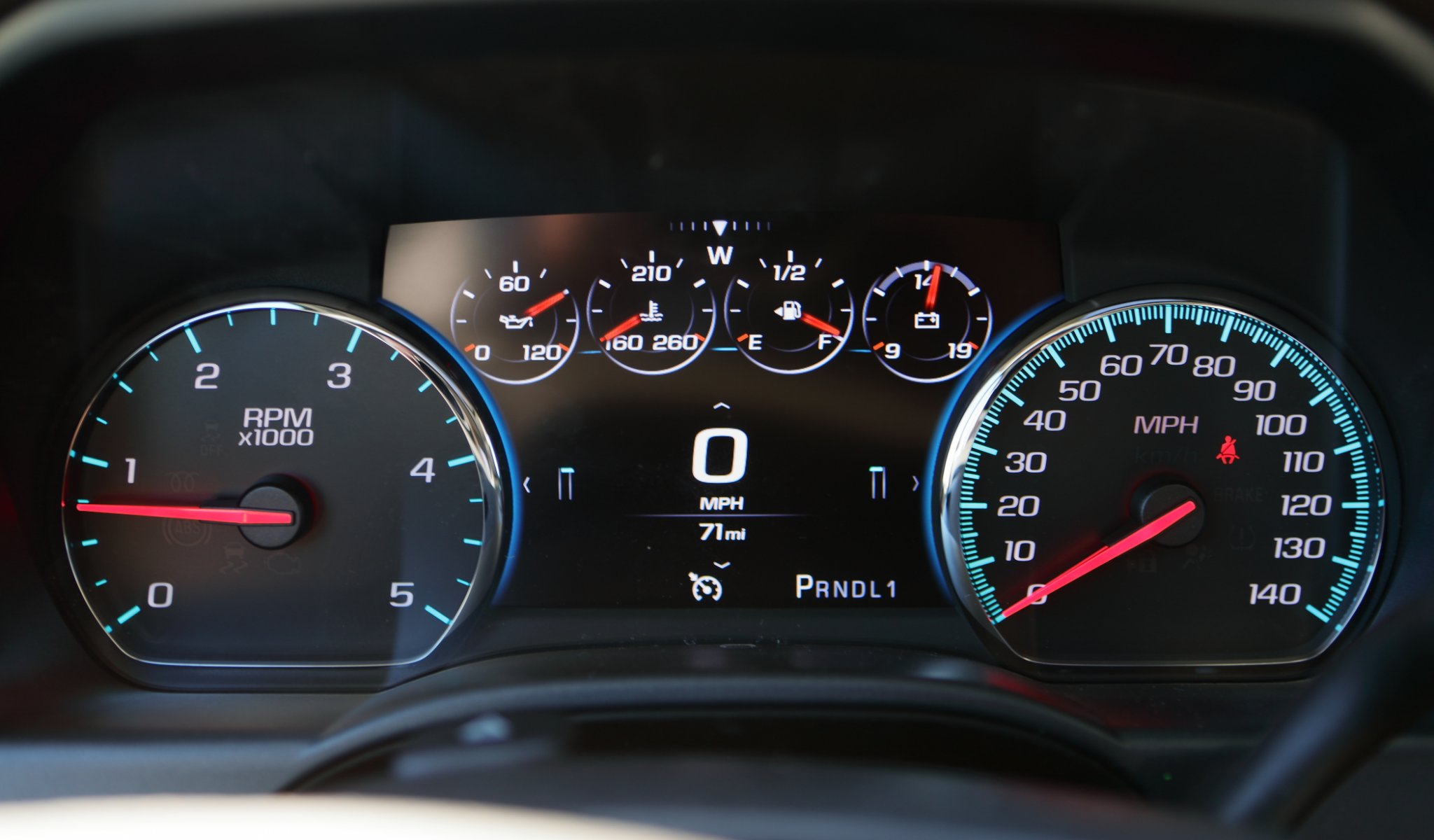

Or dummied down gauges. The oil pressure gauge on my 2018 GMC Denali diesel pickup is true and responsive but even though the coolant temperature gauge markings would lead you to believe it provides a linear readout from 160 to 260 degrees, once warmed up it will indicate 210 even with a +/- 10 degree variance in temperature. Somewhat surprisingly, when set to tow/haul mode the Allison automatic fluid temperature replaces the voltage display in the instrument panel and unlike the engine coolant temp it provides an accurate real time display that tracks with OBD II reported data.

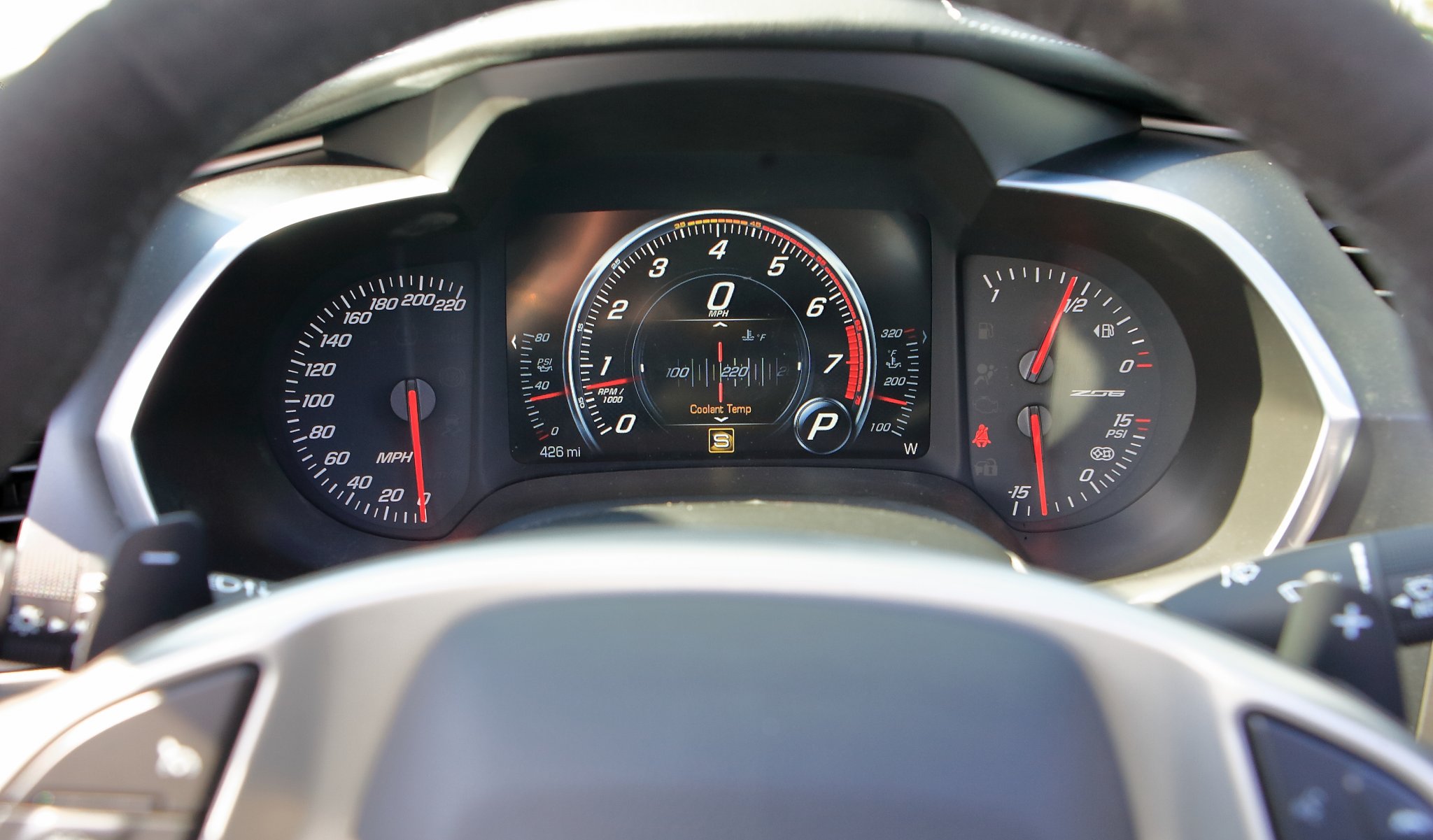

At least my Corvette C7 Z06 provides true reading responsive gauges even though they are via a LCD panel.
Equipment should have calibrated gauges that respond in real time, not idiot lights or gauges that are basically "analog idiot lights".
