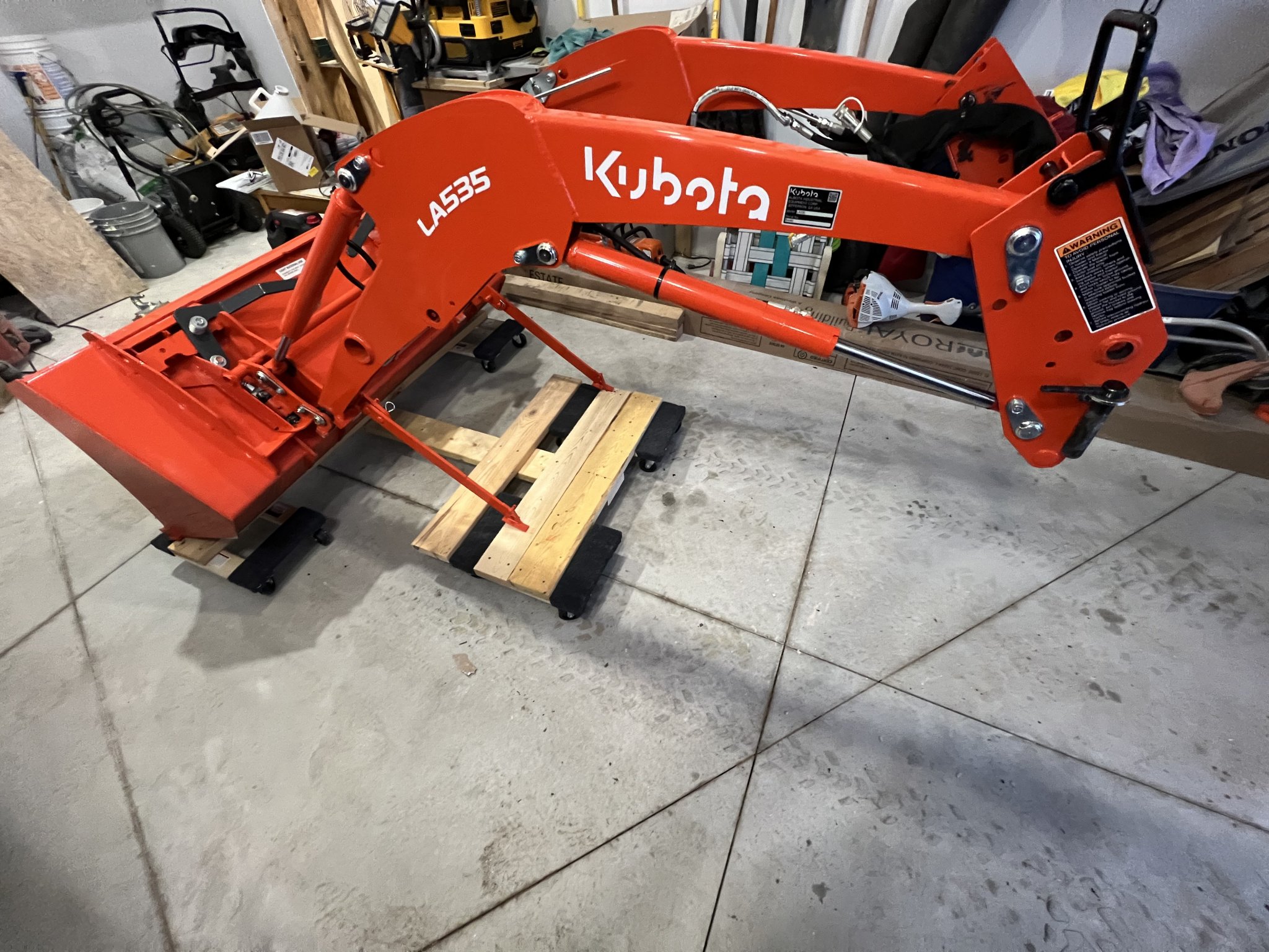

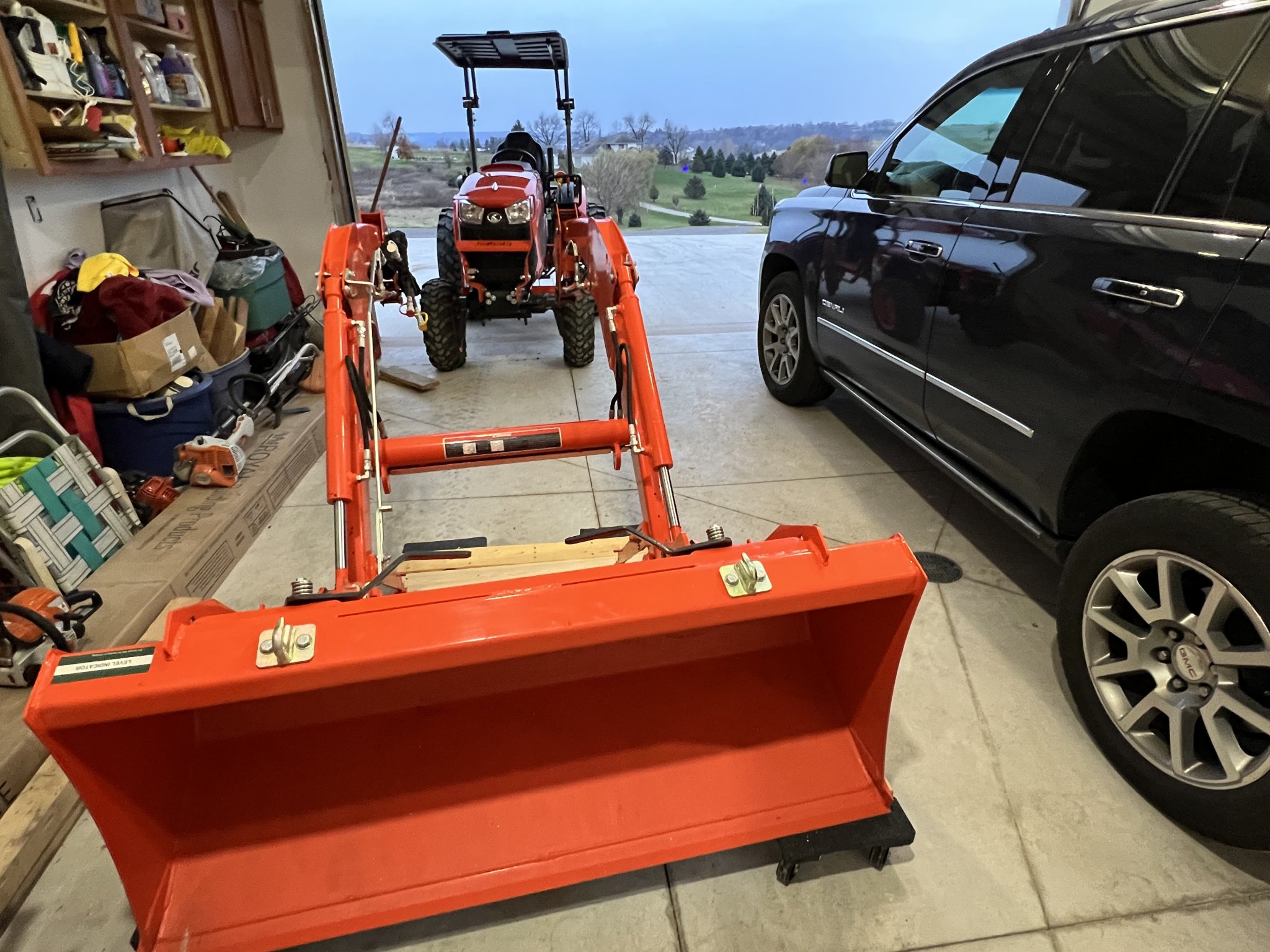

With the loader on the concrete in the shop, I measured the base, and cut a piece of plywood slightly larger. Placing two of the larger dollys under it with supporting 2x6’s, screwed it all together. It’s only about 4” off the ground, so it’s just about like putting it on the ground.
Only problem I have run into, while moving the loader around, if you get a little aggressive pushing it around, the loader can slide off the wood. I added a 2x6 in front of the blade, so I can’t push the loader off the home made dolly.

Well done. Can you install loader back onto the tractor from there or do you need to get it off first?
Took it off and back on and then off again, no issues. The dolly is only 3" off the cement floor.
