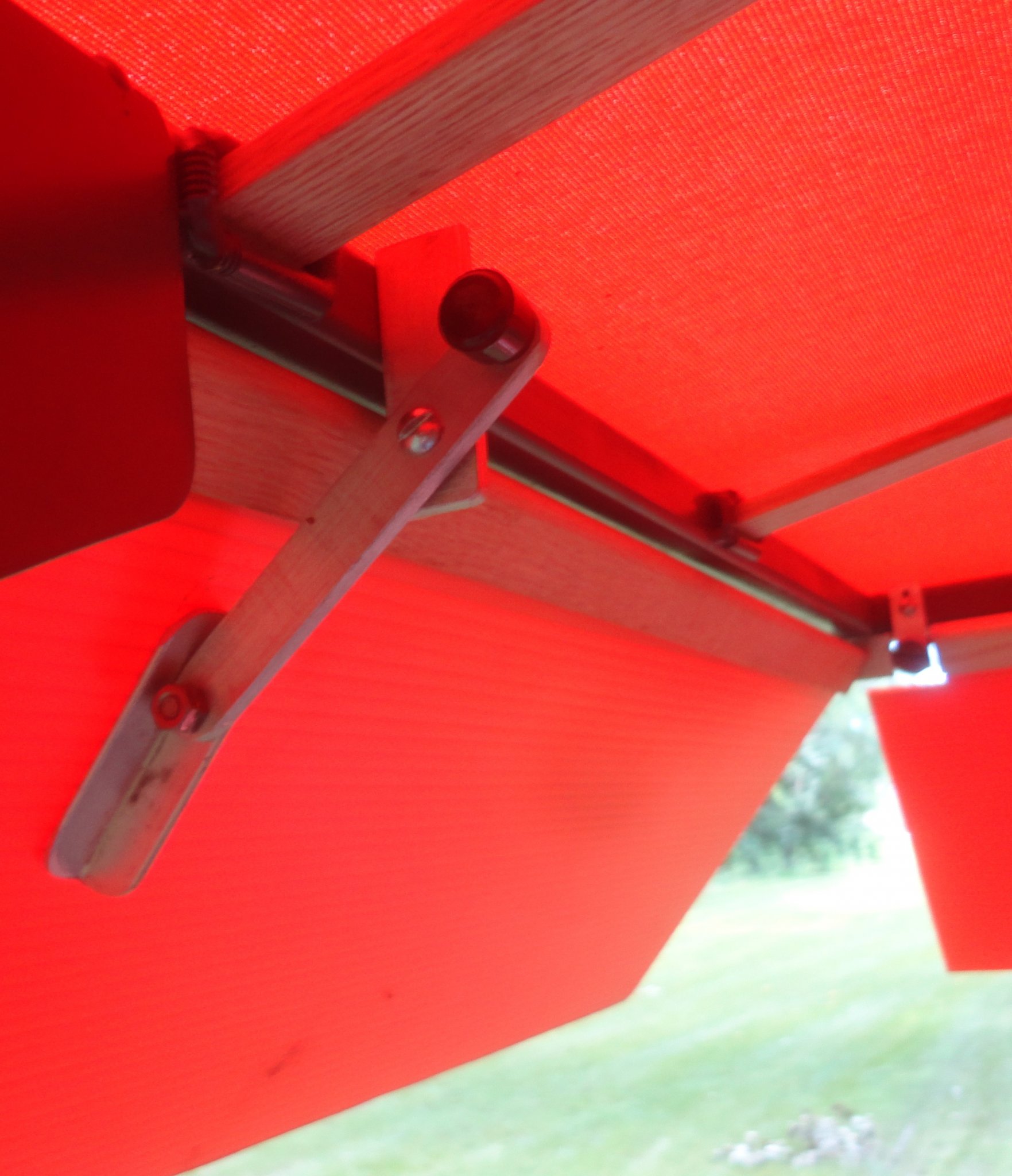

My Coroplast (plastic carboard, essentially) arrived and my visor addition finished. After the front visor was done the improvement was drastic so I made visors for the sides and rear also. the front and side visors are adjustable. the rear visor is fixed. All are quickly removeable for trailering if need be. The side visors can be adjusted straight down (or removed) when working in the trees or mowing along the edge of the woods.
The Coroplast idea worked out quite well. It's glued into a slot cut in a thin strip of oak. Short metal pins in each end of the wood act as the hinge points in the brackets. Now that the bugs are worked out
the next job will be to stain or paint the wood and fittings. Keeping the sun off your bod is sure nice!!

Look at these custom brackets and levers. You keep out doing yourself !
