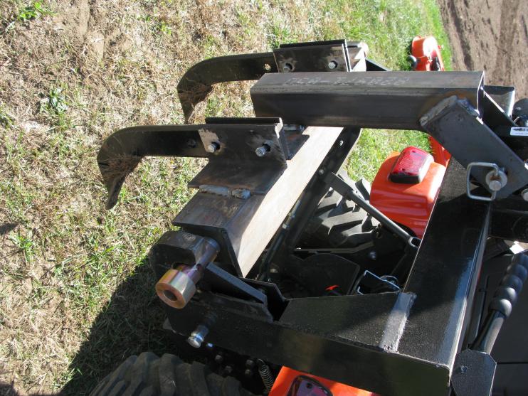

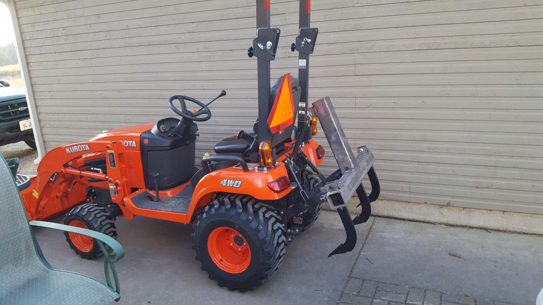

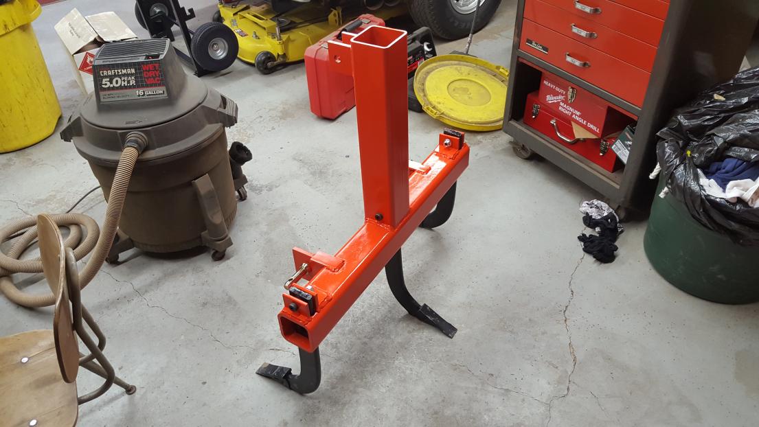

I made this for my BX2370 this morning. It took about 3 hours. I had the steel on hand from other projects. I purchased the shanks from Agri Supply PN 86635 @ $11.99 each. I only have the shanks held on with shear bolts right now because I wasn't sure what would happen if I hit a rock. I took it for it's maiden voyage and it works surprisingly well. Tractor has no problem pulling it. Really loosens the soil prior to rototilling. Next step, a spray can of rust oleum.

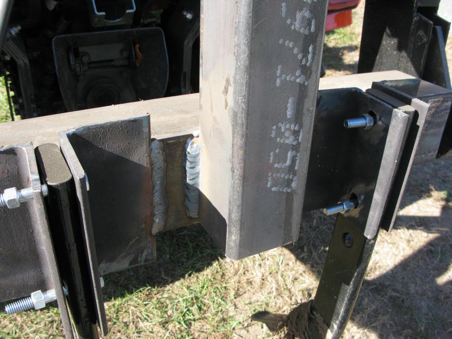

Thank's. I'm using a Millermatic 252 , 035 wire, and 75/25 shielding gas.
I weld all my heavy gage stuff at 19.5V at around 325 IPM. I just vary my
travel speed depending on the thickness of the metal.

It's just 2 pieces of 3" x 3" x 1/4 angle. I got lazy and made the holes with a Hypertherm plasma cutter and a template.
