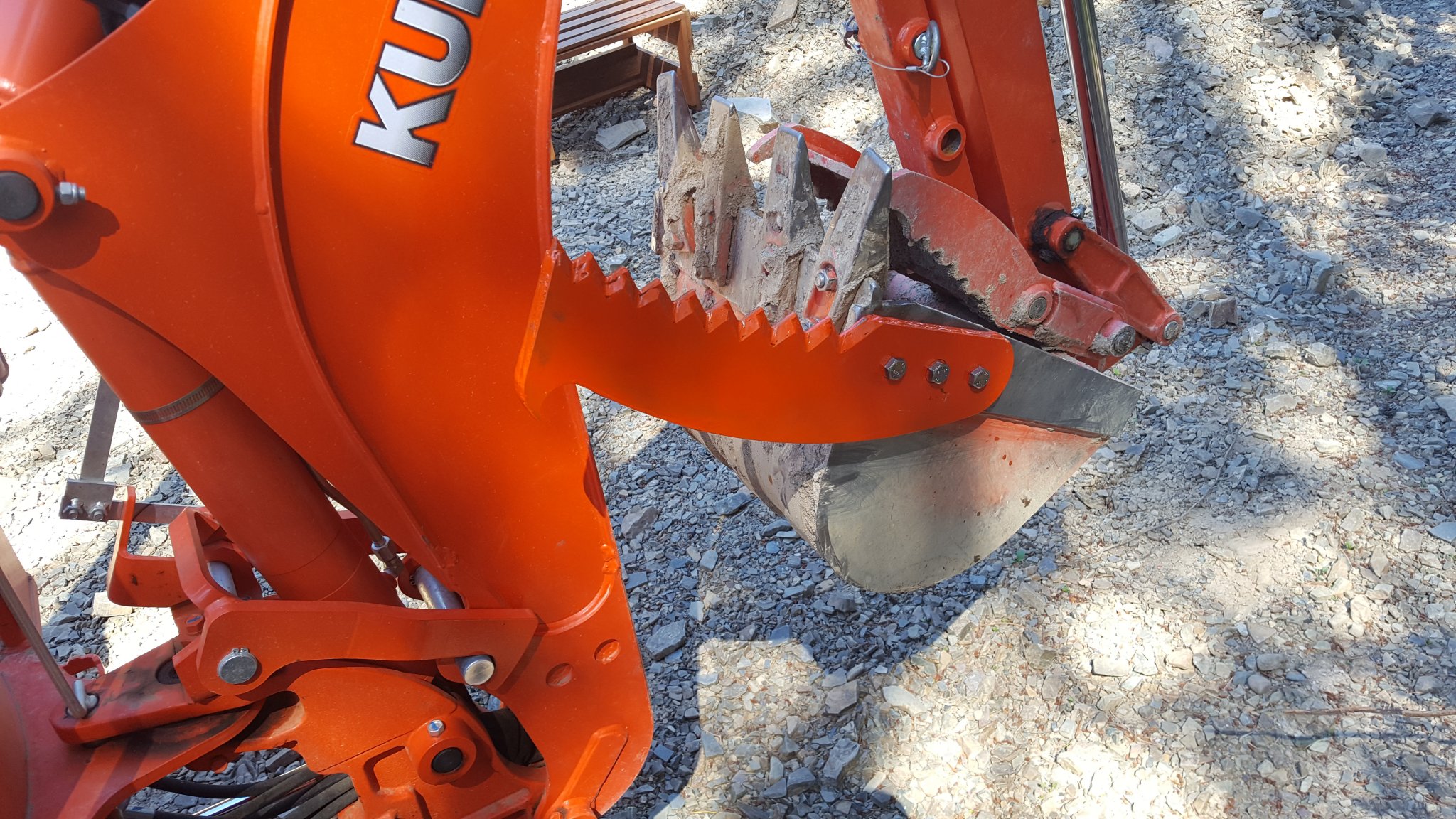

Got the Ripper mounted today. Will test tomorrow. Painted orange just because I can. I realize it won't last.

OK, I've removed 2 stumps since mounting my 'Home Brew Ripper' and I'm calling it a success. The more I use it the more I figure out how to best make use of it.
What it can't break thru with the bucket curl I'm learning how to 'saw thru' the thicker stuff.
Is it perfect, no. But has it sped up my stump removal? YES! Today's smaller stump (12-14" Dia.) took less than 2 hours from start to finish and finish means the stump is out of the hole and the hole is back filled.
