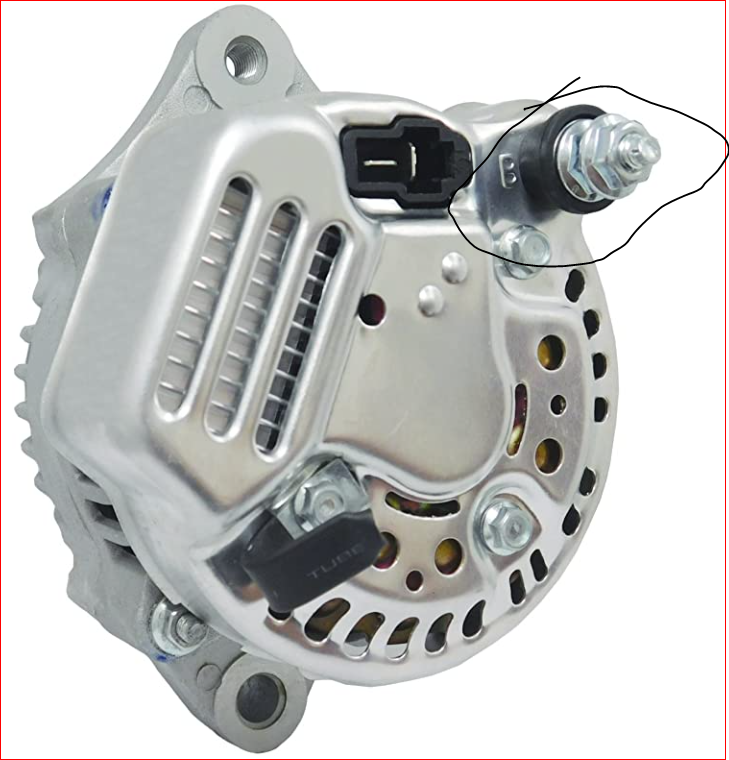

I'm trying to get info on testing "no charge" on my 2003 Kubota L3830. The battery icon on the dash is on. Just bought it
Battery is charged to full voltage, while running, no charge.

I just got home...I have fully charged my battery, at 12.90, with tractor running, 12.50. I have checked all connections and belt is tight, turning alternator. I read a post stating about a fuseable link 7.5V but haven't found where it is.
Now we are getting somewhere ........... if you can get a lead with the volt meter on the positive side of the alternator - then you could check THAT specifically - ( if the fusible link is blown)
Might be fun to do this with the machine running - get a alligator clip and use that before starting the tractor.
If that shows bad - then I would take the alternator off and take it to a auto parts store - they should be about to check it for free.
Report back what you find out on the OEM alternator
9,036
4,493
If everything is good and alternator is spinning. You should be getting 13.5 to 14 volts at the battery or post that hokie circled with the engine running.
Check voltage at the pin hokie has circled. If your seeing battery voltage then it's good. you need to next check voltage at the exciter side of the alternator. It's either a smaller wire connected to another post or more likely on newer tractors, it will be one of the wires in a quick connect.
The exciter side will only have power with the engine running, or key switch in the run position. It tells the alternator to start charging. If no power, then it's either a broken wire or blown fuse.
If your getting power on both wires, and your not seeing 13.5 to 14 voltage with the engine running then the alternator is bad and needs a rebuild or replaced.

Thanks, Daren. I will check this out when I get back home tonight.
