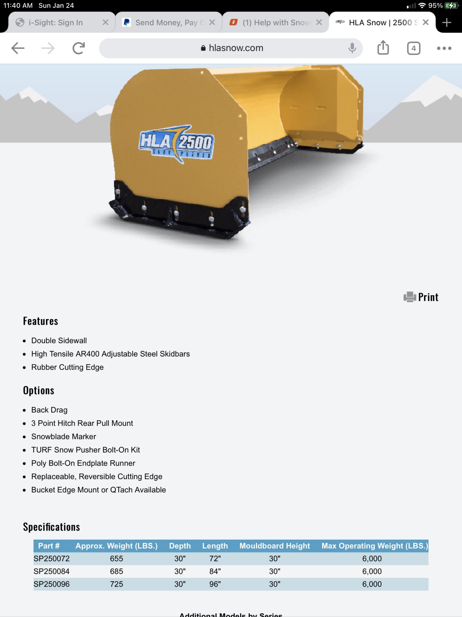

Hey, New to the tractor world and just picked up a L6060. I live up in Canada and decided to purchase a 7' HLA 2500 pusher with backdrag as it was in stock. Got home and in 5 mins realized something wasn't right. It can push but i have zero steer once its in float. Couple questions.
Is this to heavy for this tractor?
What is the best suited HLA pusher for this model?
Any help would be greatly appreciated.

Your 2500 pusher weighs about the same as mine. Weights shown are without back drag. My bare weight is 555# I figure my back drag of solid steel has to weigh at least 150#. IF you have a back drag on that model it doesn’t go full height.
