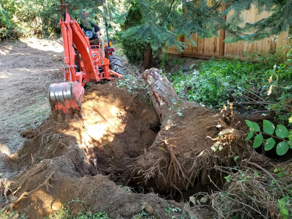

It's been a year now since I purchased my B2650 and I really like it!
I was used to my 72HP Deutz Allis 6275 4wd which is a power house and could move a mountain, the versatility and ability of the B2650 to do both small and medium duty work is perfect!
I installed the Piranha tooth bar which makes the cutting edge work great for many applications.
Graded a long driveway, ripped and graded new trails after clearing with the bucket.
Cleared and flatten 30X40 area, carried and spread gravel, have used my pallet forks many times.
Purchased the 60" MMM and works like a dream, glad I didn't go with the rear.
Have a posthole digger and and several other attachments.

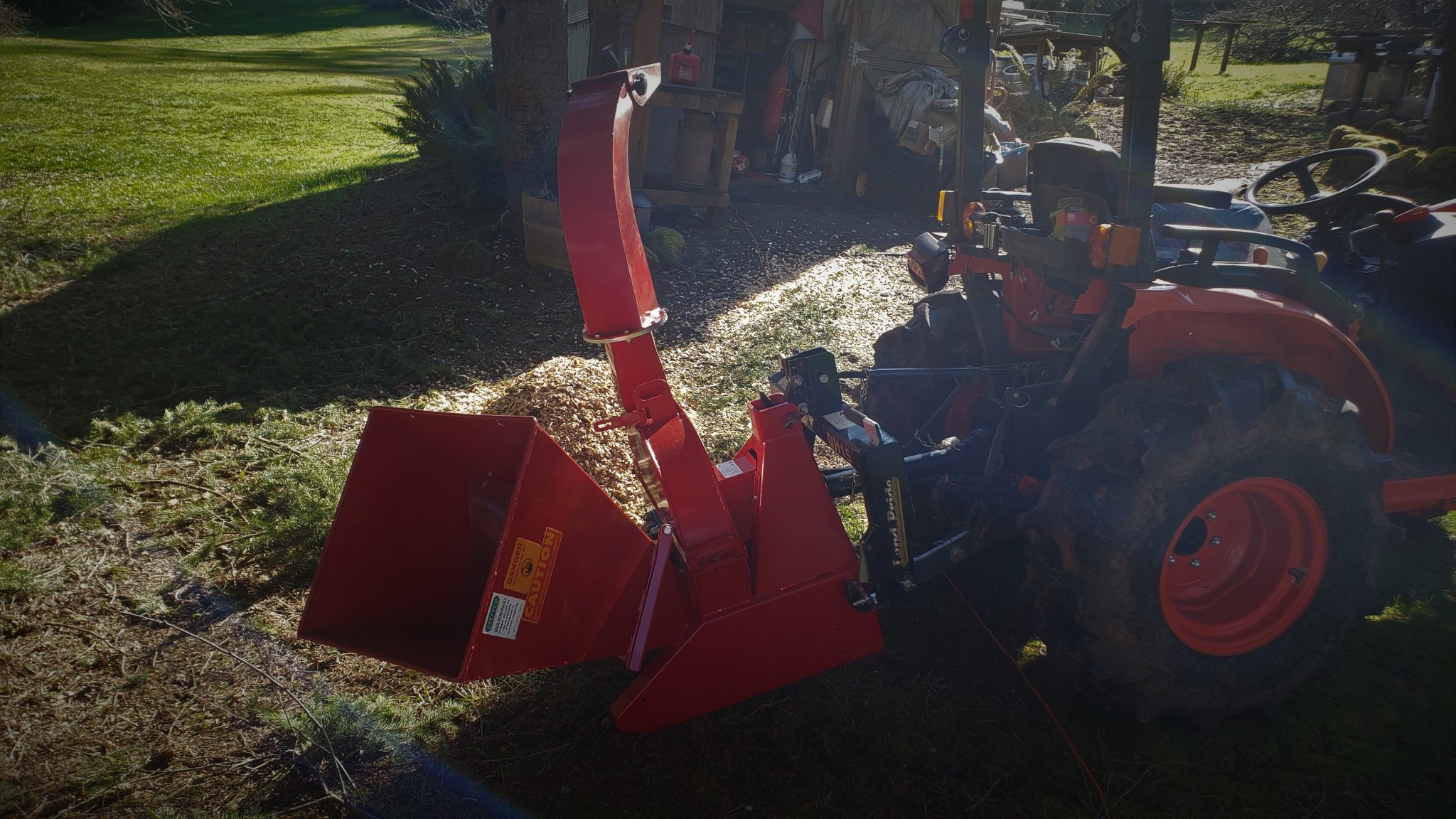

Just bought a Bestco 5" Chipper that I haven't assembled, I've read on arborist forums the work really good for the $$. The recent ice storm left a huge amount of damage on my 30 acres and I can use the chips!
Question, has anyone has purchased the Bestco backhoe?
They are self contained, no need to install a 3rd remote and the are about $4000 less than the BH77
From the looks and build, they seem to be just as strong if not stronger.
when you use this for a little bit, can you do a review on the forum detailing it and if you are happy with it
Will do that for sure.... should be soon.

Been putting the BESTCO VLWCX 5" chipper to hard work for several days and it's a beast, sucks in and spits out what it's advertised to do. One of the heaviest flywheels you can for the size get at 115lbs, most others are 90lb. The bearings are massive, and everything appears heavy duty and high quality.
