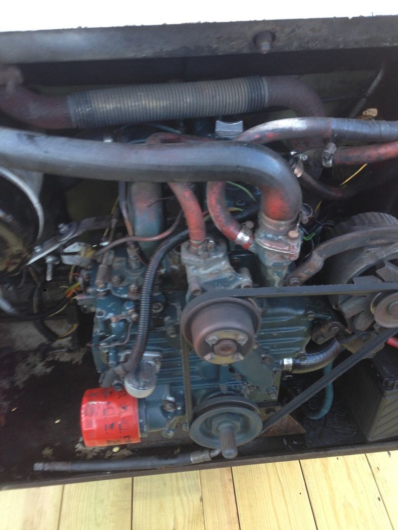

Hi my name is Charles and I just purchased a very used bobcat 743. The machine is circa 95. It has a v1702 4 cyl water cooled engine.
I was wondering if anyone here had worked on a similar engine?
This is the biggest engine I have ever owned when it comes to equipment.
Wonderful and amazing engine for sure. It needs some TLC that over time I will be able to fix.
I'm really enjoying the searches here.

Hey hodge/coachgeo!
Really cool forum here.
Today we are trying to take the creep out of the machine, while my buddy was doing that I was cleaning looking for hydraulic leaks.
Boy this is a dirty job when someone doesn't maintain their equipment.
