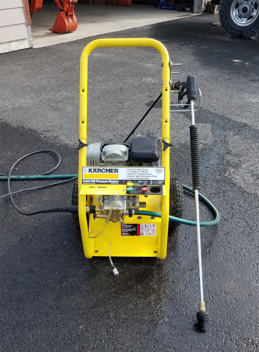

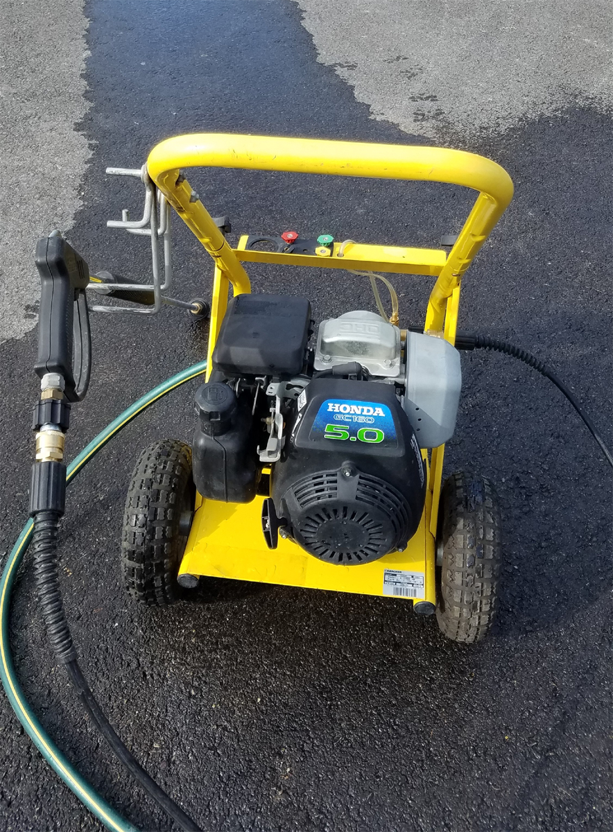

I've never owned a pressure washer until about a year ago. There's a local weekly online auction up here and last year I spotted what appeared to be a very lightly used Karcher pressure washer with a 5 HP Honda engine. Some research indicated that a new equivalent pressure washer would be around $450 so I placed a few bids hoping to get it for around $200. I ended up winning it for $165 plus a 15% buyer's fee. I was feeling pretty good about this deal, and felt even better when I got it home and the little Honda engine started first pull and purred like a kitten.
Now fast forward to this past weekend when I installed two frost-free faucets through the concrete foundation, one after the filters/softener treatment, and one off the well directly. My thought is that I can water the garden with well water and wash equipment, vehicles etc. with filtered and treated water. This is relevant because I hadn't tested the water pump due to the lack of an outside faucet (another story).
I was excited to test out the pressure washer for the first time but disappointed to discover that I could get as much velocity by putting my finger over the end of a hose. Something wasn't right so I ended up removing the pump to find a couple of issues. The oil in the gear housing (for want of a better word) was the color of a latte, and the spill valve which is Karcher's name for the unloader valve was stuck. In hindsight I could have simply replaced the spill valve, maybe, but I wouldn't have known about the oil in the gear housing which would eventually have caused a failure. Every seal or o-ring inside the pump was in a bad state so at the very least I needed to buy a pump rebuild kit.

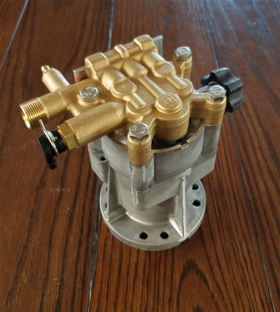

So after looking for parts online I decided to order a complete replacement 3,000 psi Karcher pump which includes everything that connects to the output shaft of the engine. Total cost was $130 with a free QD kit thrown in. A pump rebuild kit is $85 so I figured it makes more sense to spend the extra $45 for a completely new pump rated for 3,000 psi, a 600 psi upgrade. I might order a pump rebuild kit at some point so that I have a working spare pump but there's risk since I don't know if new seals, fresh oil and a new spill valve is all that it needs.
So now I'm $320 into my first pressure washer and rapidly approaching the cost of a new and possibly better one. I've learned a thing or two but what I thought was a really good deal has turned into an ok deal at this point.

There's no way to test the pressure washer at the auction house so it's one of those "as is" deals. My only concern with running a pressure washer without water for 10 seconds or so is that the pistons have no resistance from the water so that could possibly do some damage but I'm not sure. The oil was contaminated so the pump had issues long before I showed up. 😊 If the new pump works well and the engine holds up I'm still ahead but not by much.

The new pump came in yesterday and I got it installed this morning. I had changed the oil last weekend but checked the level, cleaned the air filter, put air in the tires and added gas with Stabil to the tank. I was able to test it this morning washing the F250, the Jeep and the underside of one of the trailers and it works extremely well. The "free" quick connect kit is a nice touch too. I don't know if it makes any sense to order an $85 parts kit for the old pump when a new one is $130. Having a spare pump would be convenient if the new one fails but perhaps not the best way to spend money. Here's the new pump and the now 3,000 psi Karcher.
