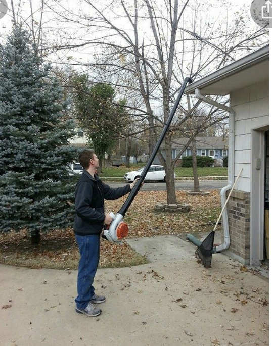

Instead of climbing a ladder, I use a pipe extension with a manually adjustable joint on the end to blow the leaves out of the gutters on the three houses on the family compound here. Highest point is about 25’. It looks like this: (not me, just some guy on the internet with pretty much the same setup). It’s better than climbing a ladder.
We thought about getting K-guard gutters or something similar but doing all three houses would be around 560’ of gutter so it just isn’t worth it. Clay soil plus basements, we have to have gutters and French drains. People east of us in sandy soil, doesn’t matter whether they have gutters or not.
