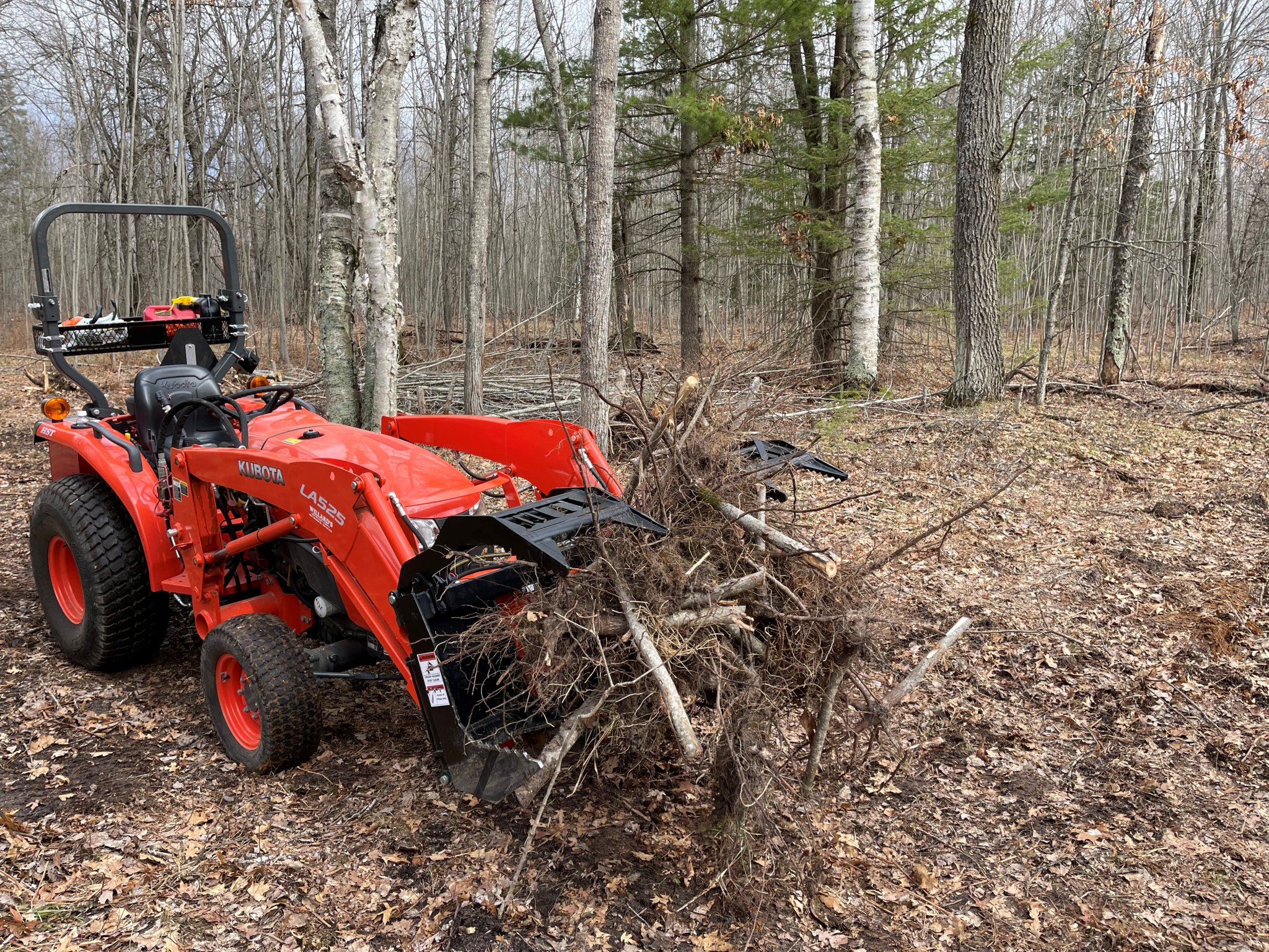

I have the LP SGC0660 root grapple
I also have pallet forks and may buy an add-a-grapple to haul more brush and other debris

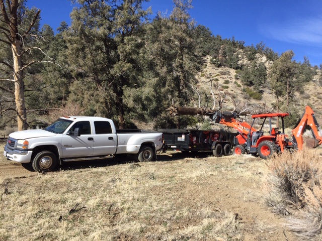

The Titan Debis forks were 1/10 the cost compared to getting a 3rd valve and grapple for picking up whole trees for firewood. Did break the bucket ears and re-welded and minor bending with their 5000lb model, I am happy with how they work and the savings.

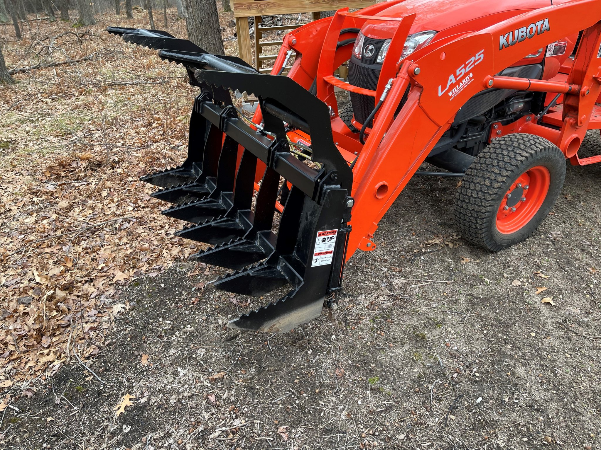

Take a look at an MTL CV 60, Total cost delivered $1,300, they currently have them in stock. It is a twin lid compact vertical grapple, I have one for my L series, it has to be the best value for the cost in the market place. It performs very well and is a great match for my L series, actual weight is more like 340lbs versus the 400 lbs stated on their web page.
Twin lid adjusts better to uneven loads, I like this design as cylinders are behind the frame rather than on top.
Good luck in your search.

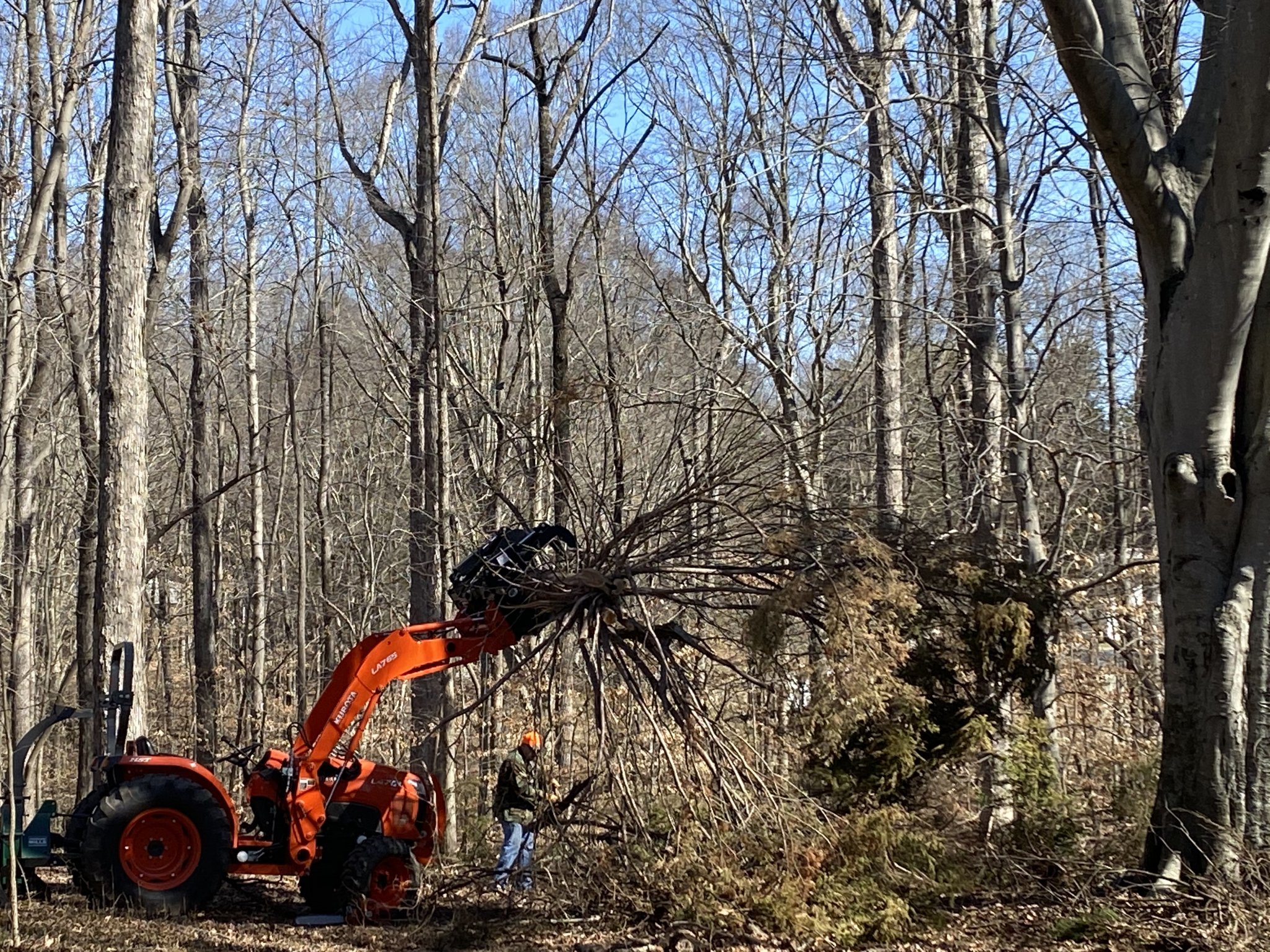

totally agree with everything @NCL4701 mentioned.
I think lower tine configuration is personal preference. I prefer the extended lower horizontal tines because you can easily hand load it if needed, and it's still effective at rooting, and grabbing piles.
I was moving construction debris that were right up against the house to a dumpster, I just hand loaded it for her, and she would drive off and unload. I sometimes hand load it for tree removal too, just depends on the situation. Having the option to do either is helpful.
still effective at scooping too
