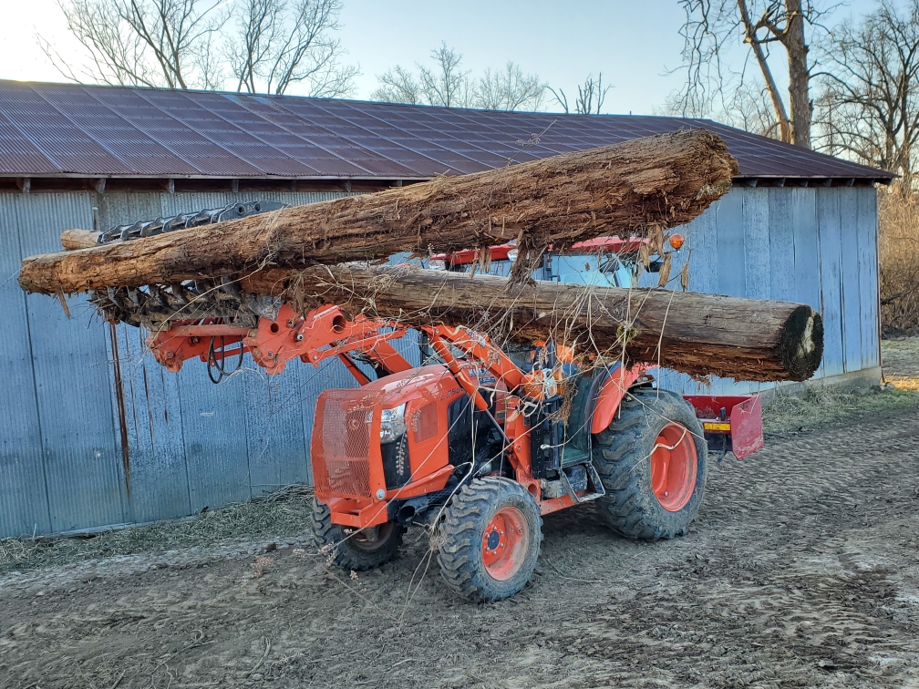

12,625
1,419
I have the LP and I can tell you,, the teeth DO BEND ! AR400 plate I think is what they are made of and yes it works, however there is a learning curve ,of which I am still on the back side of. It works super for lifting logs to cut, no more bending over and fighting with them. The gap between the LP teeth is pretty wide, but unless you are trying to move mulch or fine stuff it is no problem. For brush like wild roses or bamboo, or wild grapes if you can get a good bite you are good to go. Though I do find it hard to push the lower teeth into the ground to extract root balls, again the learning curve thing, Just MHO
Elliott in GA
LX 2610SU w/535,LP RCR1860,LP FDR1660,LP SGC0554, LP FSP500, DD BBX60005
Mar 10, 2021
322
290
North Georgia

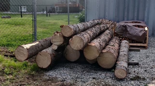

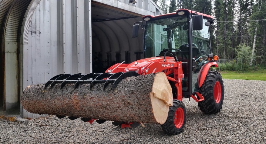

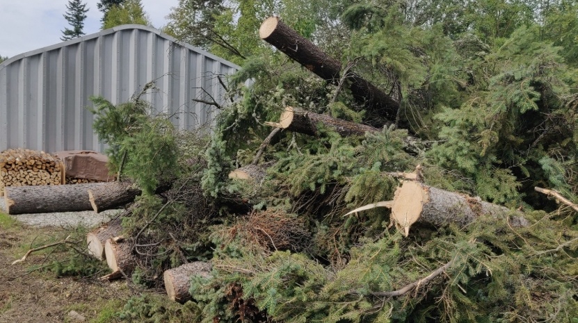

Worked the heck out of a SGC0554 on a LX2610 today and it works fine. Had a grapple crane cut down some large spruce that were between Powerline, house and fence. He made a big tangled pile out behind my shop and and went on his way. Trees were mostly 20" at the stump. I untangled the pile, stacked the logs and loaded the brush. Took some ripping and tearing to get the pile untangled so I know if it was going to break this would have been the time.
