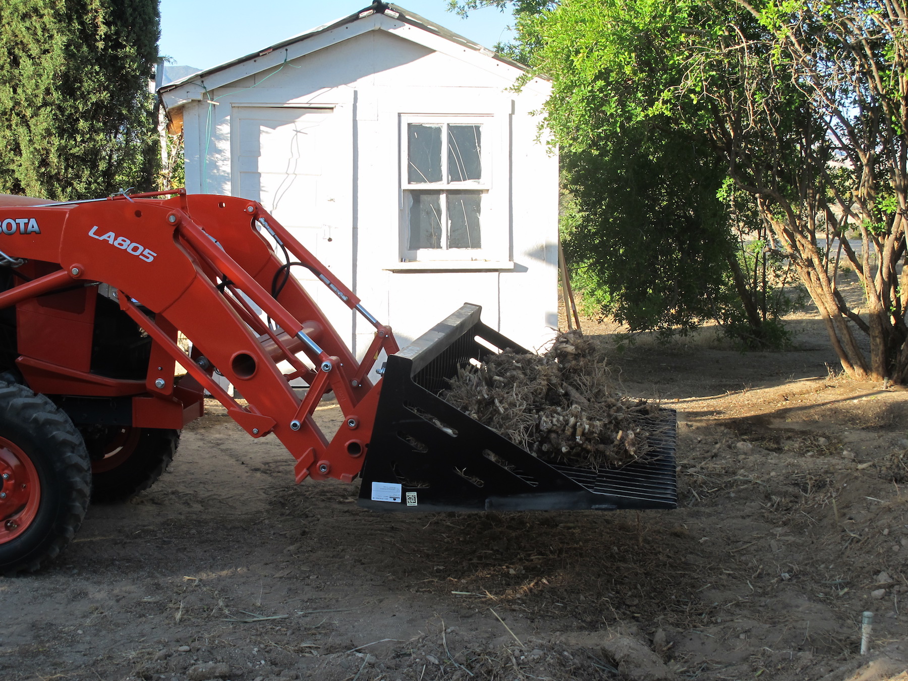

I have a skeleton rock bucket, you might try one. It worked well for scooping out bamboo roots for me. I have found that they tend to pick up a lot of dirt along with the rocks though.
Wifey already said "we need one of those" when I was watching a video about them, almost ordered one right then lol.
It will definitely come in handy when I'm clearing out areas for animals and gardens, I have a few other things to spend on first otherwise it would be in the yard by now.
