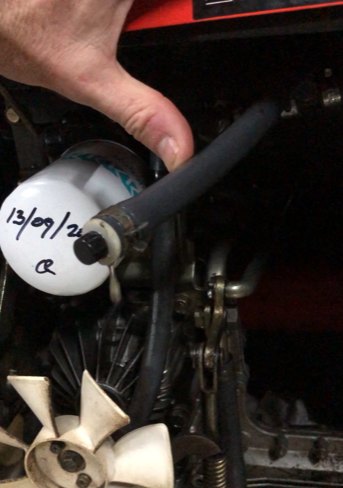

Hi everyone, i have a GR2100 that is leaking transmission fluid from the breather hose. Has anyone had this same issue and can offer advise? It has the right amount of fluid onboard, not overfilled. It starts leaking after about 2 minutes of operation.

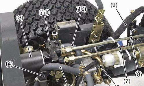

I think it needs to be upright in the cut of the seat base. That keeps it above the rest of the system so you don't get a siphoin effect.
Also, be sure the leak is the breather and not the small return elbow hose on top of the hydro. The hose is part 10 in this photo.
