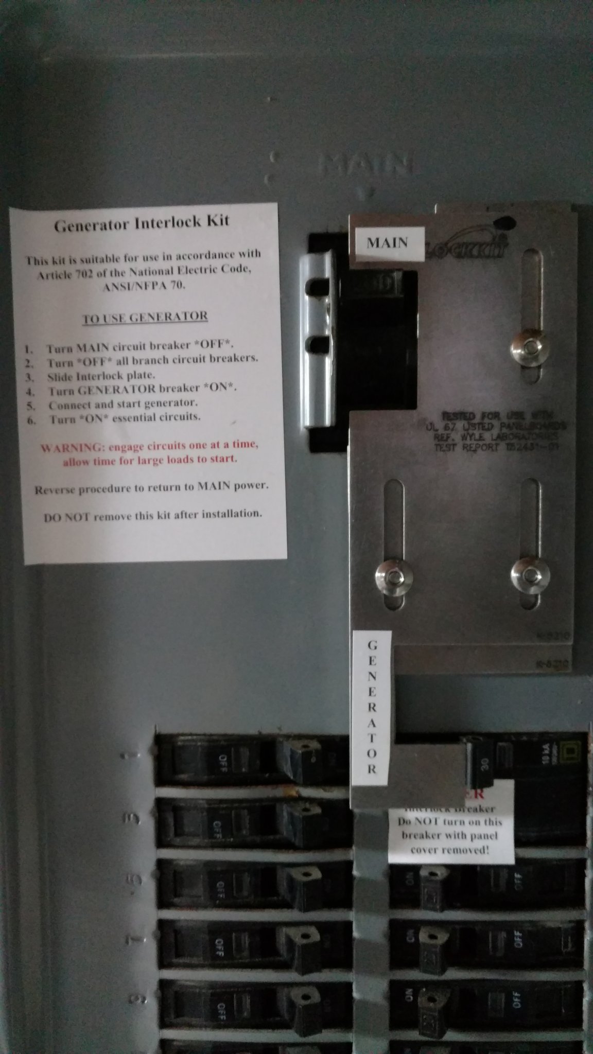

Since I have had the interlock kit, the cables, circuit breaker and outside receptacle for over a year now, and having to plug extension cords into wall sockets to get the generator connected to the house after the power went out due to an ice storm, I finally got it installed ready for the next power outage.
Now I can trip the main breaker off, turn on the generator breaker, fire up the generator and plug in the cable.

Well I ll be darned, back in the day we accepted that set up to lock out equipment in a plant. I dont have an old NEC any more but I thought for a set up like that it was required to have visible disconnect on the switch to make sure all phases cleared. I always thought this was a better way any how!
Now I can trip the main breaker off, turn on the generator breaker, fire up the generator and plug in the cable. View attachment 53148
This is what I have in house, barn and sugarhouse and had in mynold house too. Much cheaper than transfer switch box.

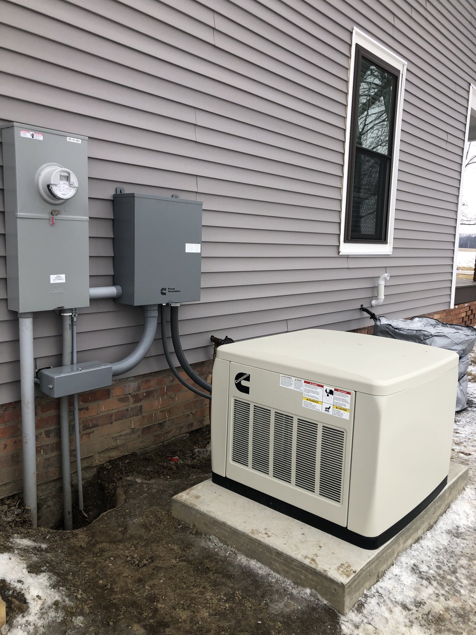

I completed my 20kw Cummins generator and 200amp ATS last week.
