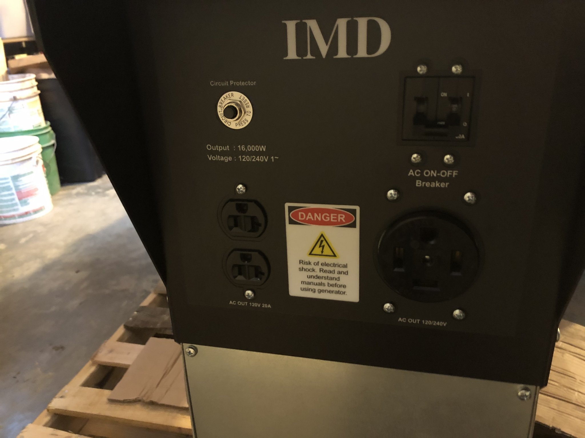

For better or worse this is what I ended up with. Electrician installed a transfer switch so I can hook it to my house when necessary (which isn’t often) and it’s clean enough power to use for a residential backup. AVR allegedly helps with that.
No plans to ever try to run 24/7, just off and on to keep water flowing intermittently, refrigeration units cold, and bump heat once in a while. Portable so I can keep the freezers and heat bumped every few hours on the unoccupied house. Long power outages are relatively rare here. Pretty decent amount of power in remote parts of the property as well. After these photos, put casters on bottom of the sled frame so the PTO shaft is level when it’s sitting on the ground.
Guys at IMD in South Carolina were great to work with. 3 point was a bit cheaper than trailer and takes up less room in storage.
Electrician said he’d never heard of running a generator off a tractor (I don’t think he’d ever seen a PTO before) and couldn’t imagine it holding consistent voltage and frequency like a dedicated generator so I told him to feel free to play with it, put loads on, take them off, start the well pump and A/C or whatever he wanted. He took me up on it and messed with it for a bit while monitoring the output. Finally said much to his surprise it works like the standbys he usually installs.
Glad to have some serious and highly portable power and also not have to do the prep work to move to the camper every time there’s a threat of power outages.

I would have seriously considered a natural gas dedicated unit with an automatic transfer switch for the house if we had gas lines to provide an unlimited fuel supply, but we don’t have gas lines so a dedicated standby would have either been diesel or propane with a big propane tank sitting in the yard. Neither made sense to me being I already own the motor. Portability was a big plus as well. I was tired of running a spaghetti bowl of cords all over the place and swapping between them and the camper with the little 5500 watt construction generator.
My electrician had a really hard time understanding my thought process until he saw it running. Told him if I bought a stationary diesel, good chance it would have a Kubota engine in it pretty much the same as was already in the tractor. He called me a couple of days after I said that just to tell me he didn’t believe me but researched it and found out I was right, genset manufacturers generally don’t make their own motors.
