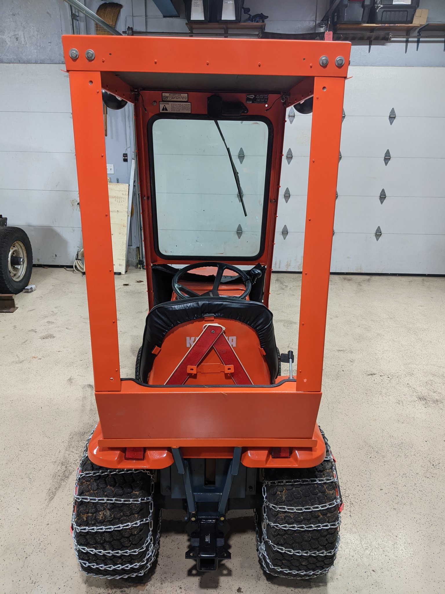

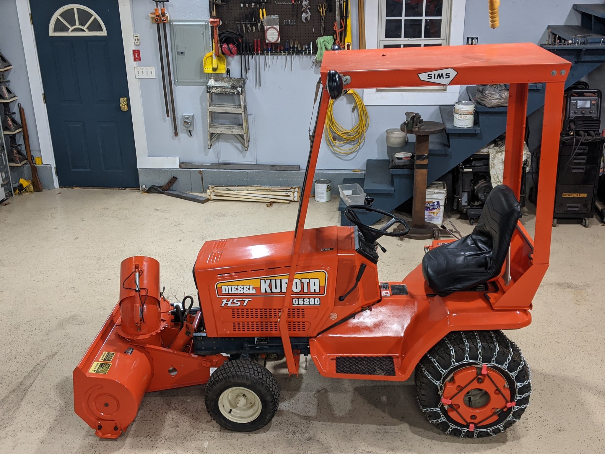

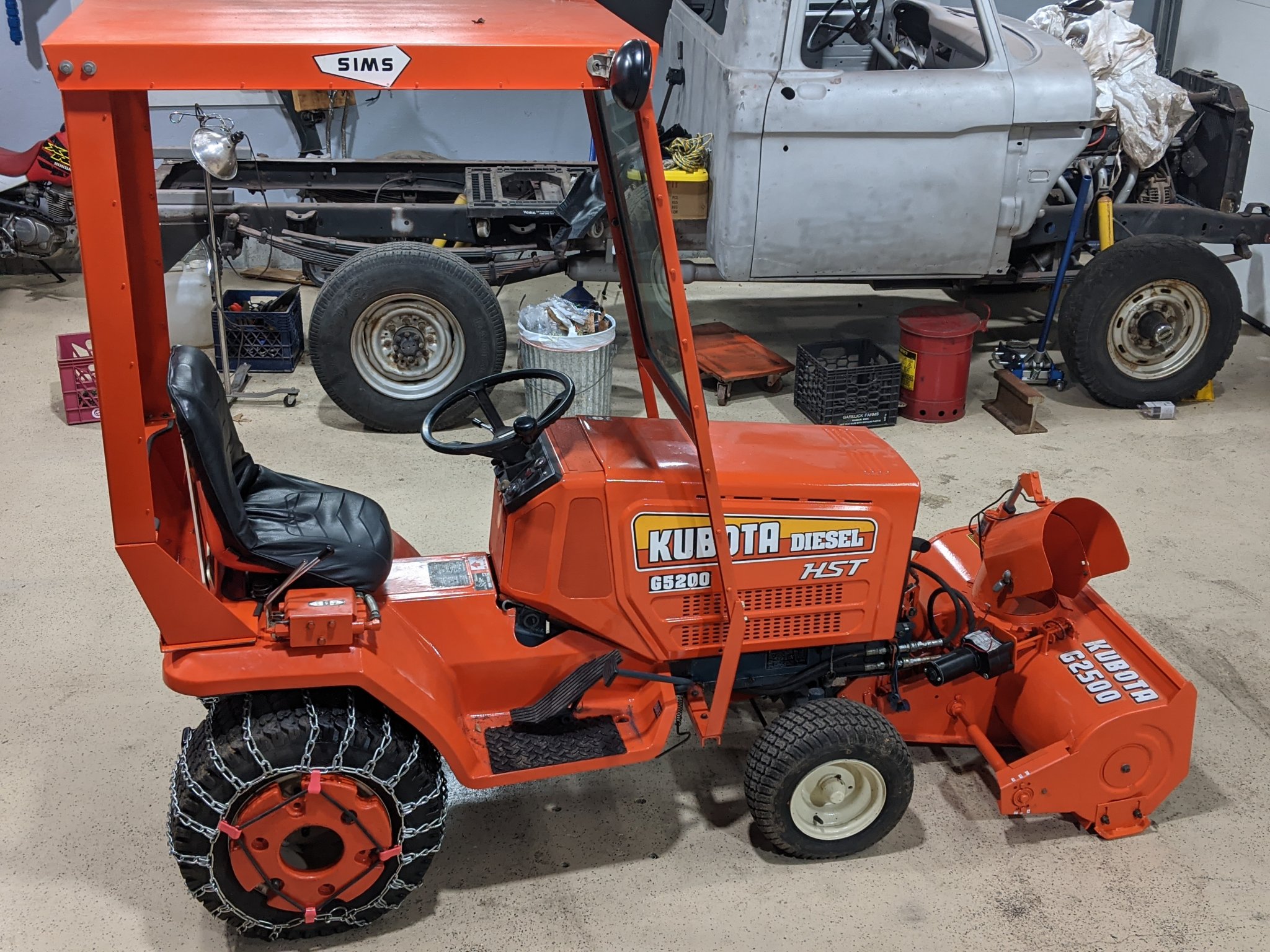

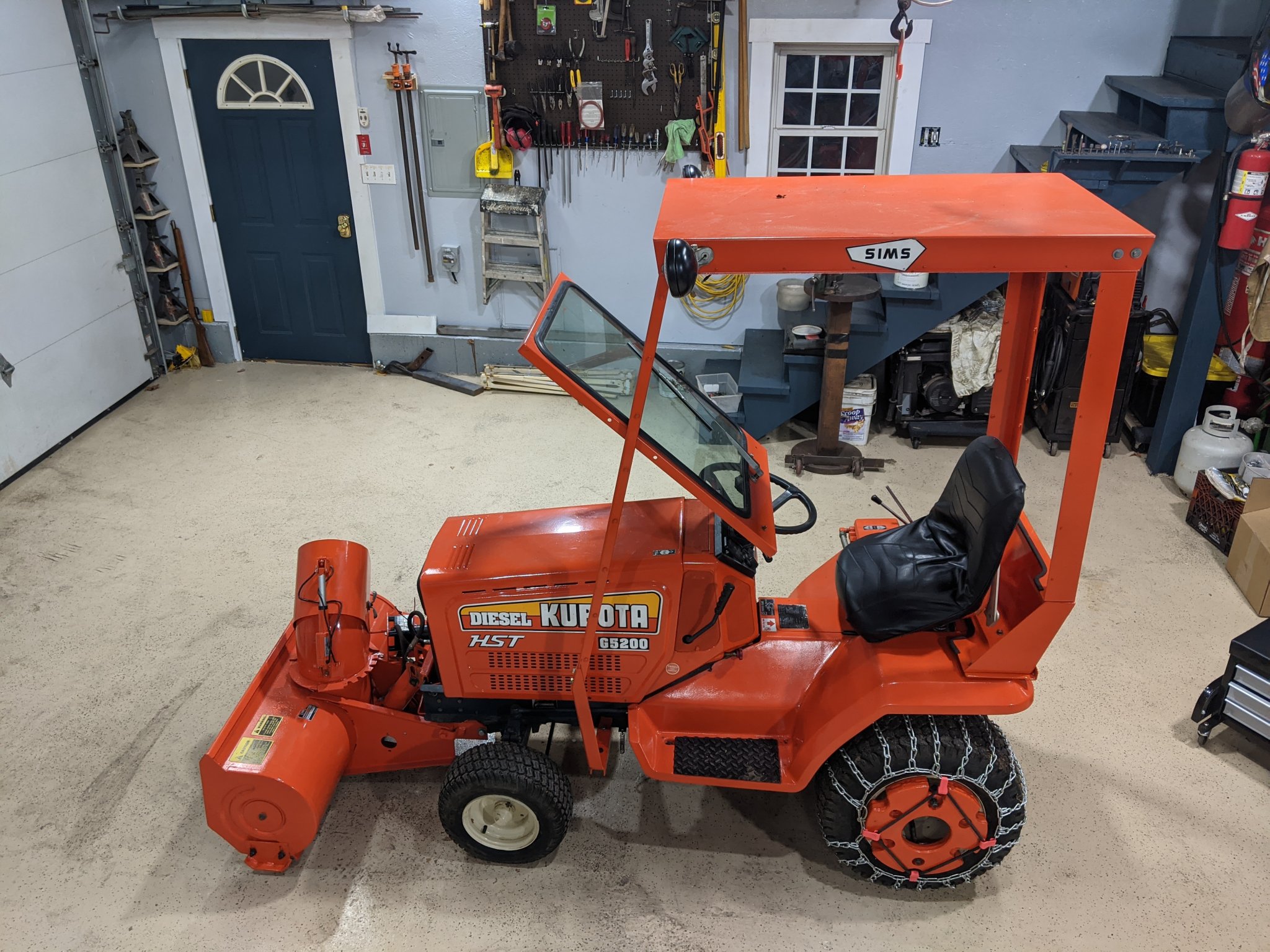

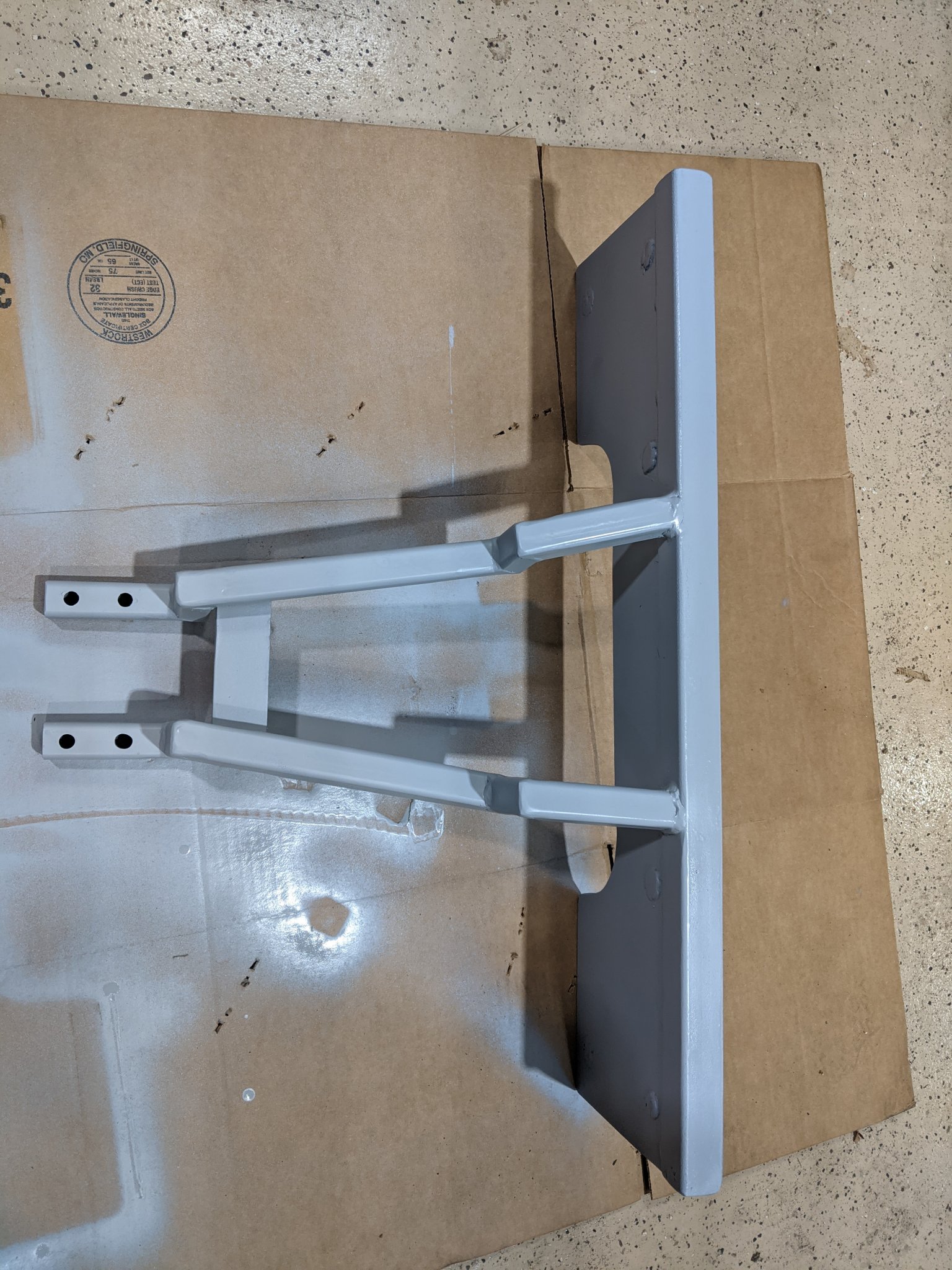

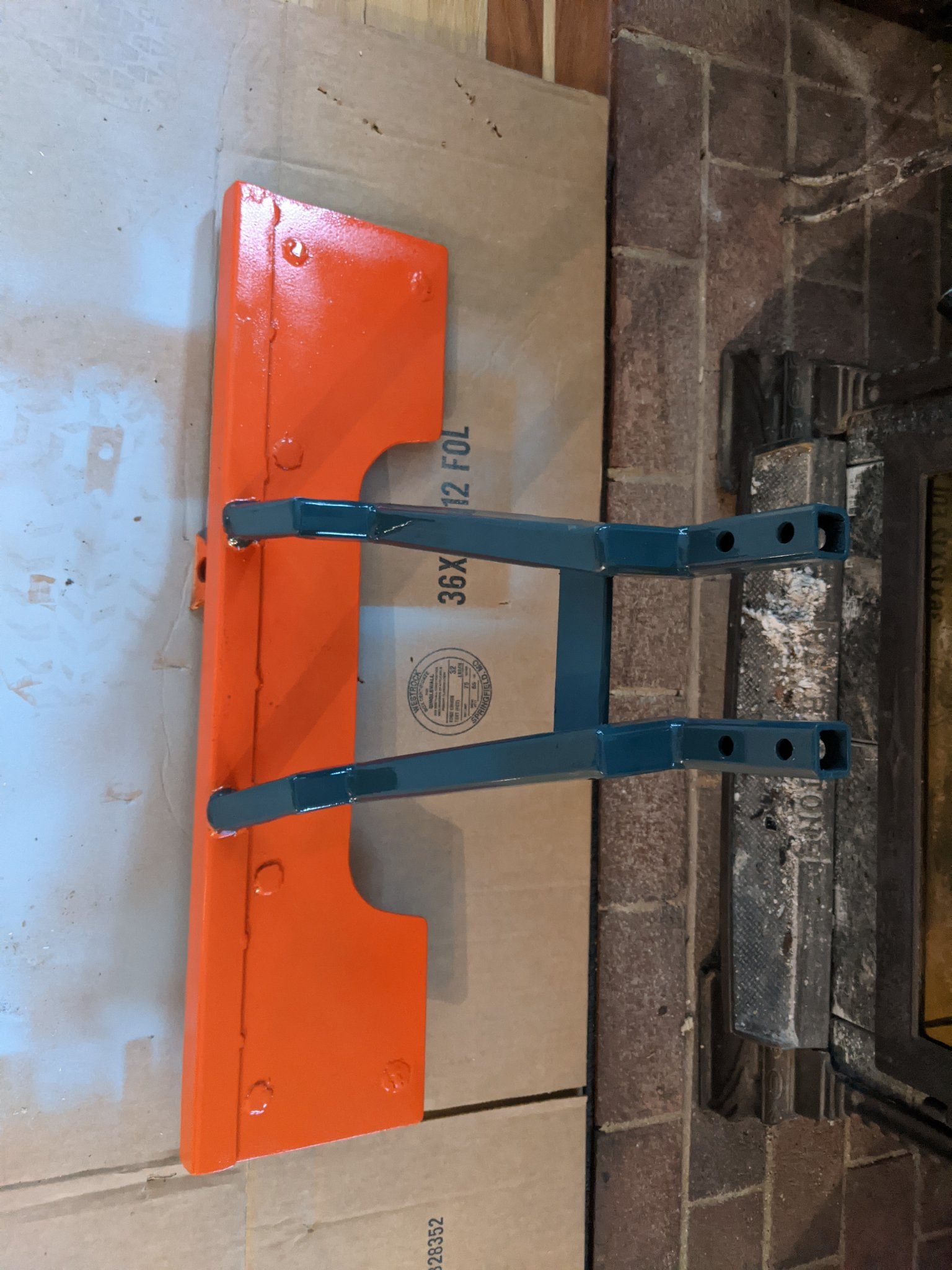

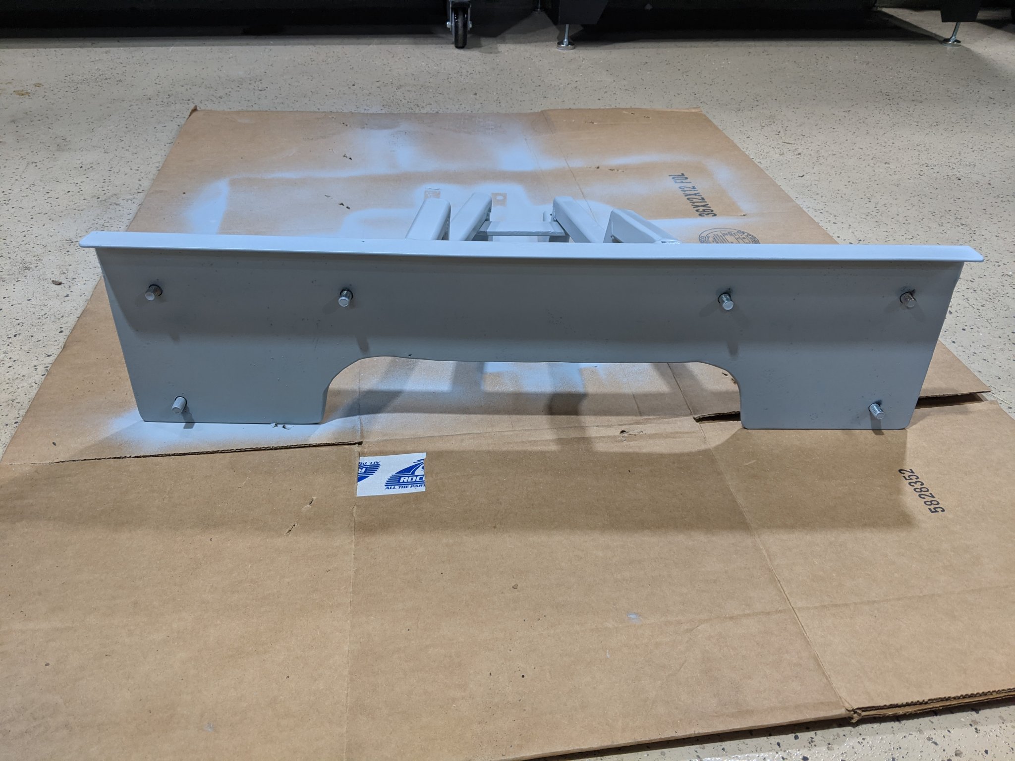

So when I bought my tractor it had a Sims cab with it, the only problem was that these cabs mounted directly to the fiberglass fender in the rear and the whole back of the fender was broken off. So after I had the fender repaired I was not going to bolt the cab to it again so I fabricated a mounting bracket that bolts to the rear end of the tractor. The metal cost me $15
So here are a few pictures of the bracket I made. I also included a few pictures of the cab mounted on the tractor. I installed the side curtains yesterday also (waiting for snow now.)

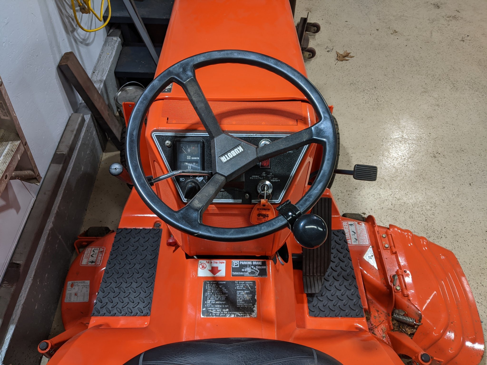

I also made new floor mats, I went to HF and bought 2 12x12 diamond plated sticky tiles and made a paper template of the floor boards, then cut out the tiles and glued them on. They cost me a total of $8

Was just about to ask how you open the hood...tilting window is ingenious!
