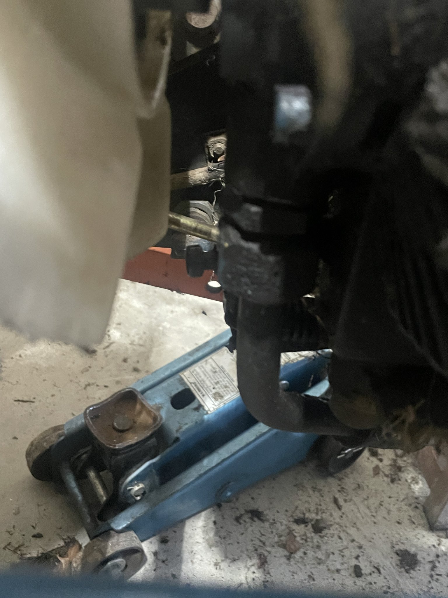

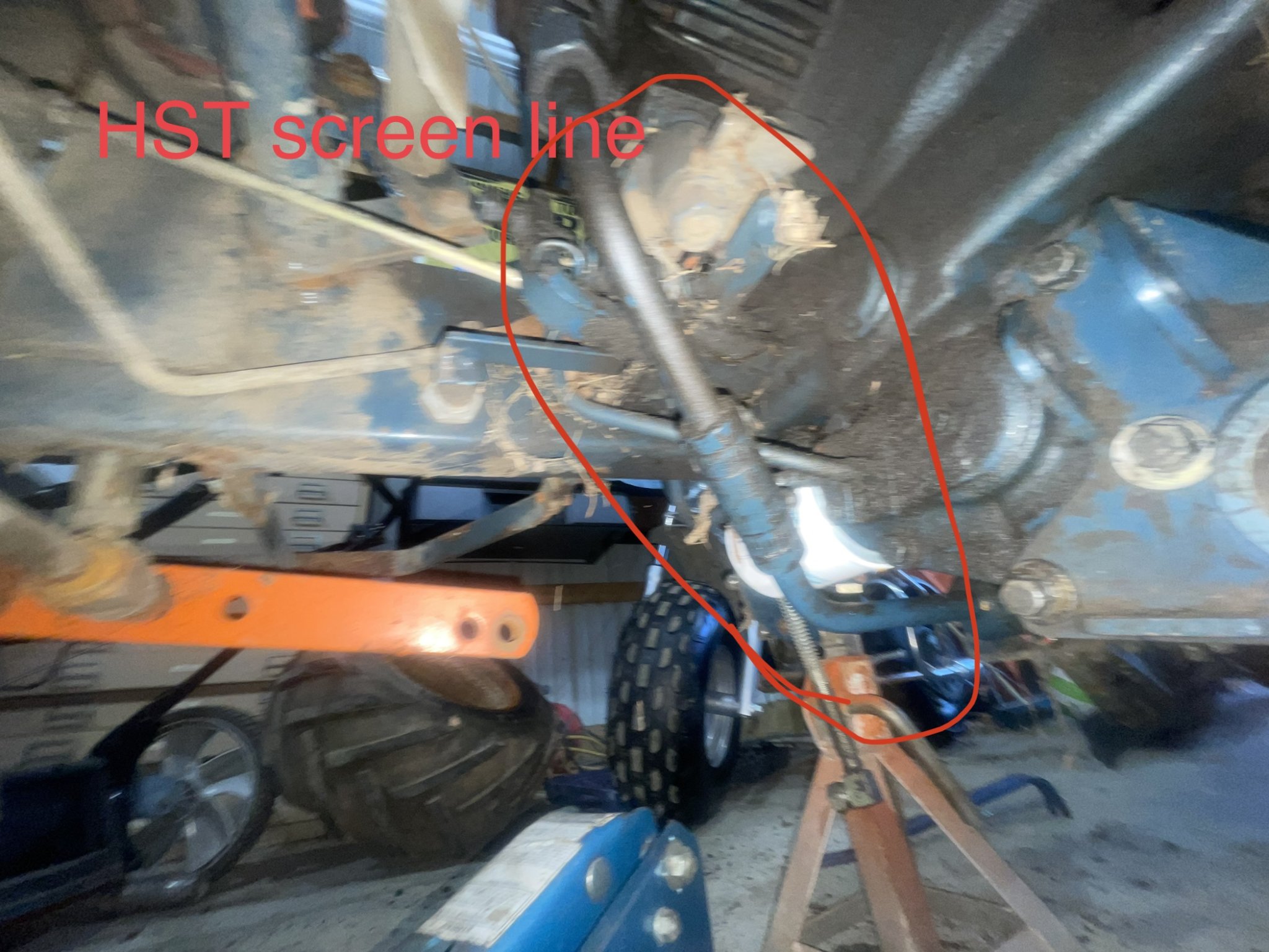

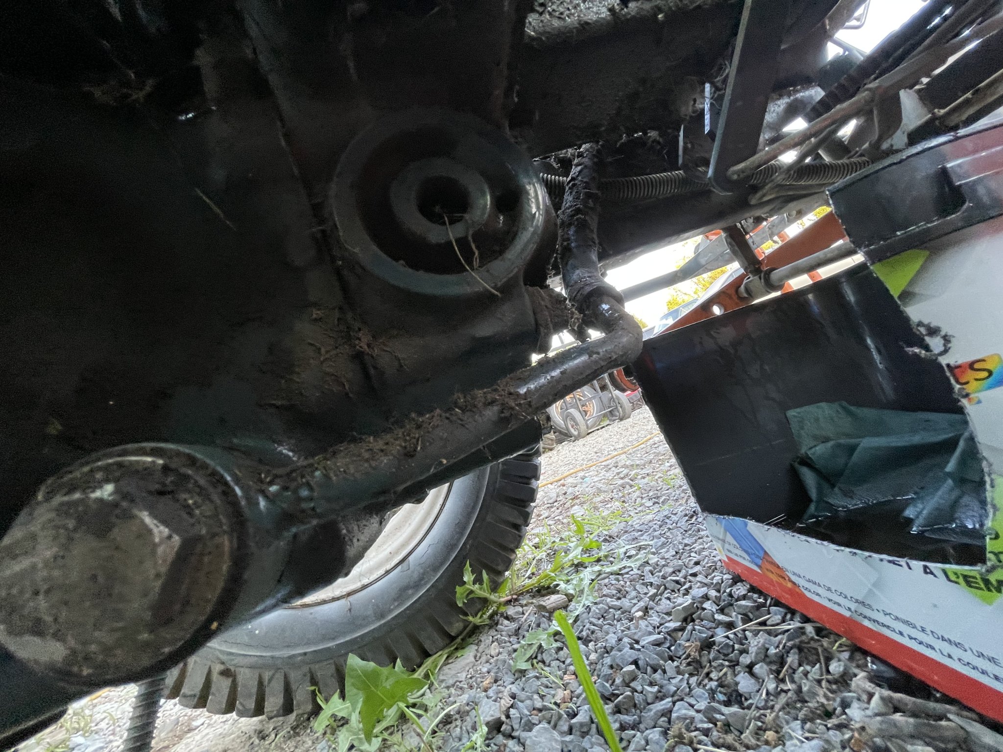

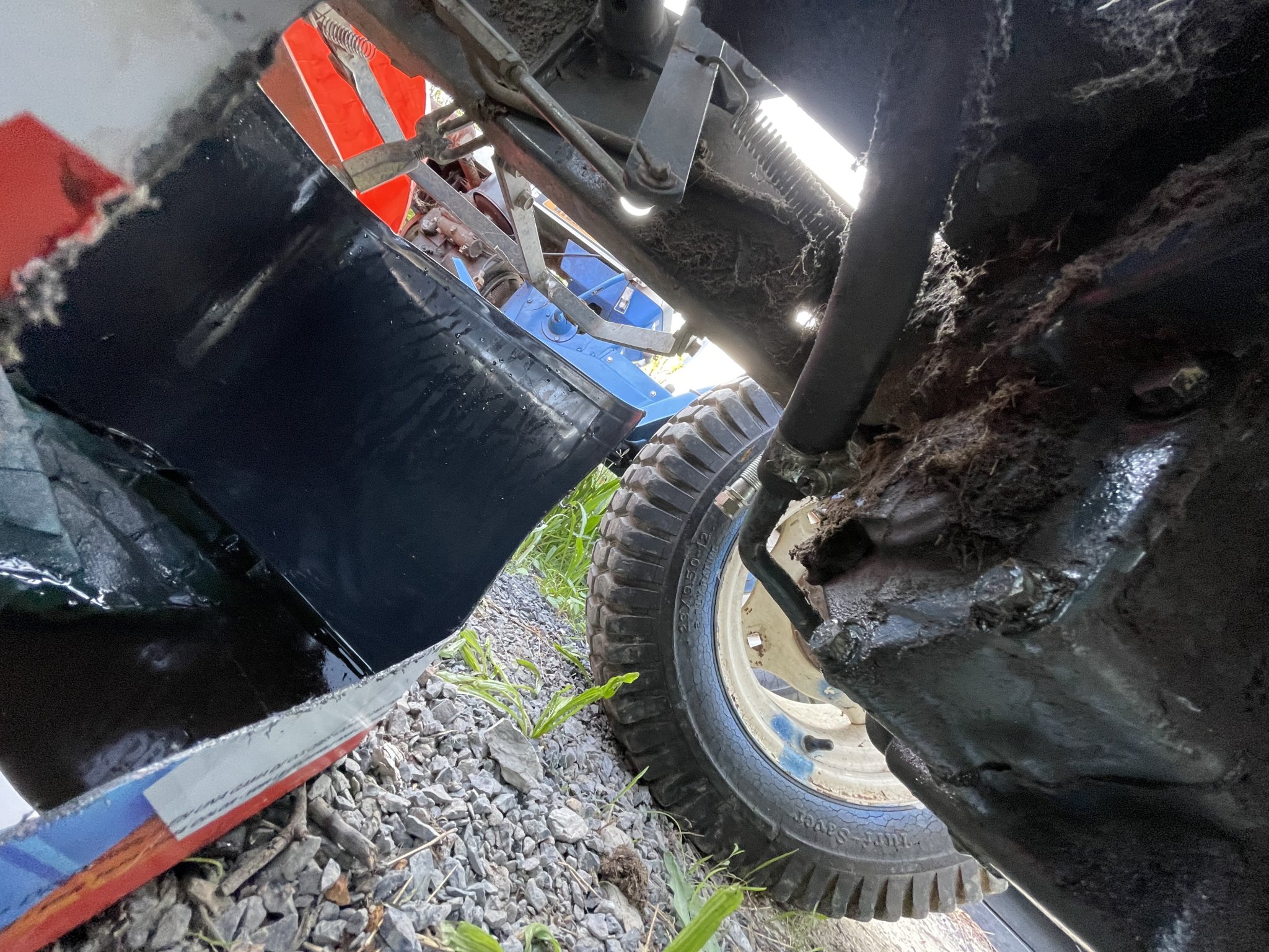

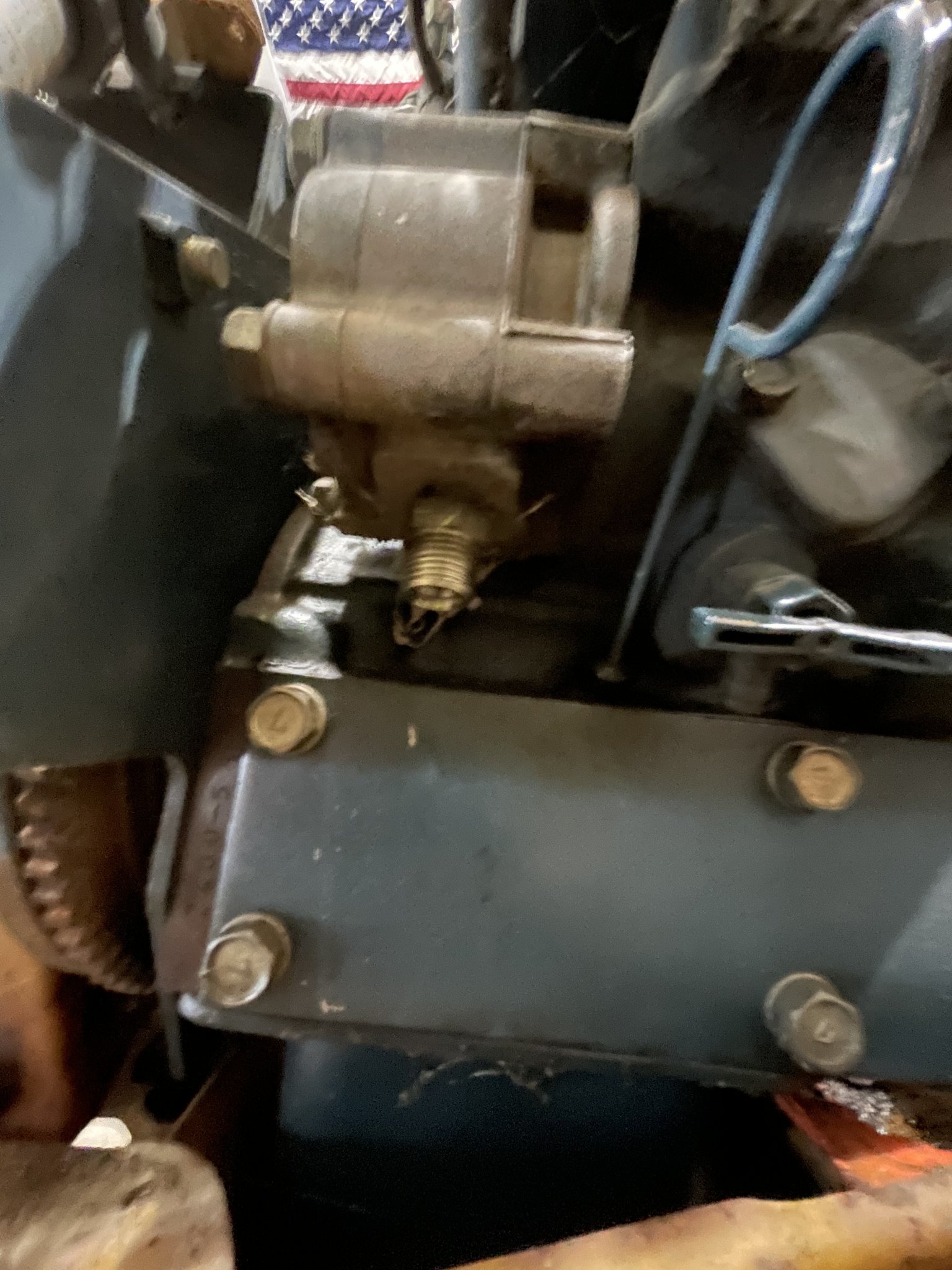

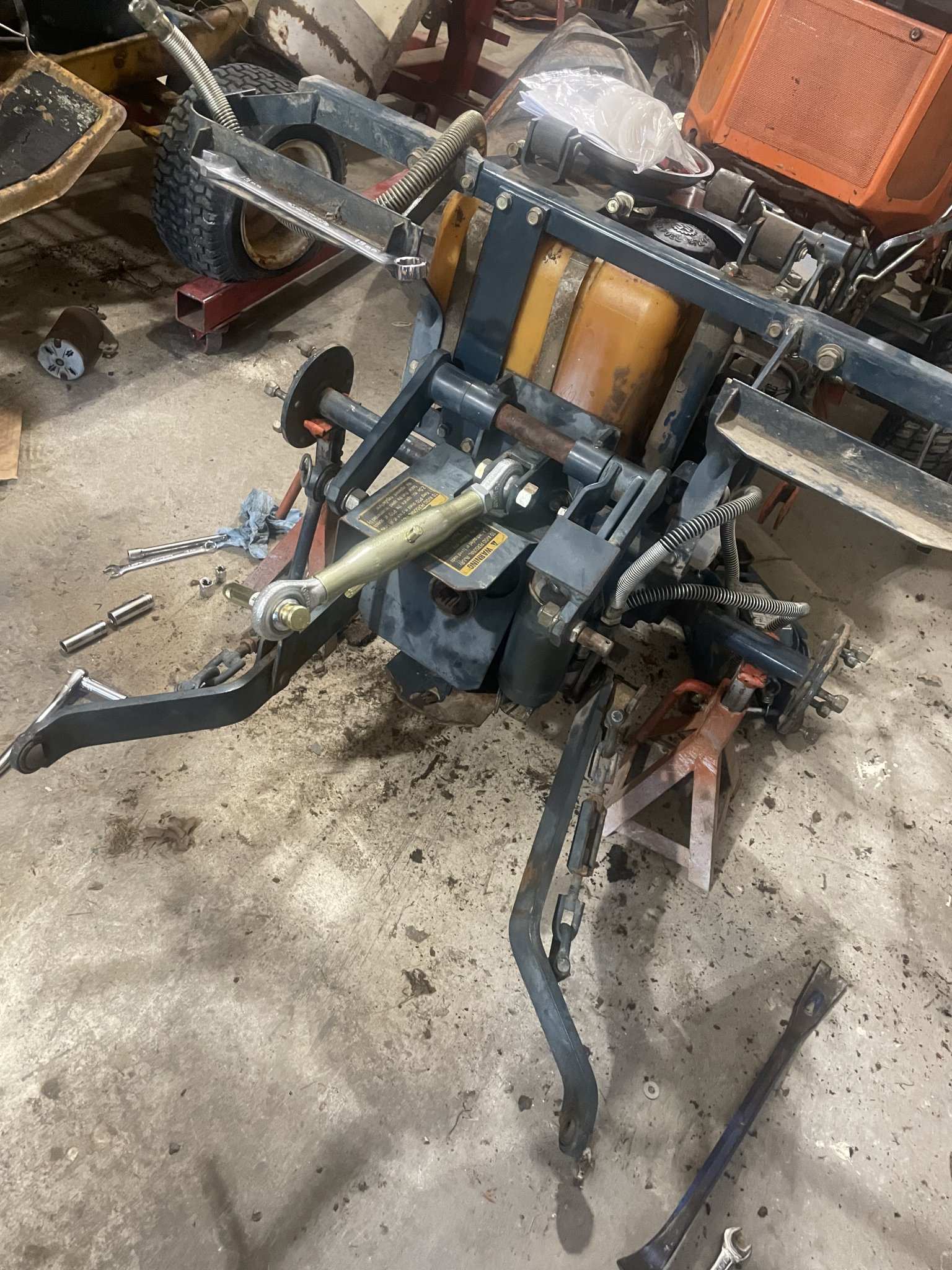

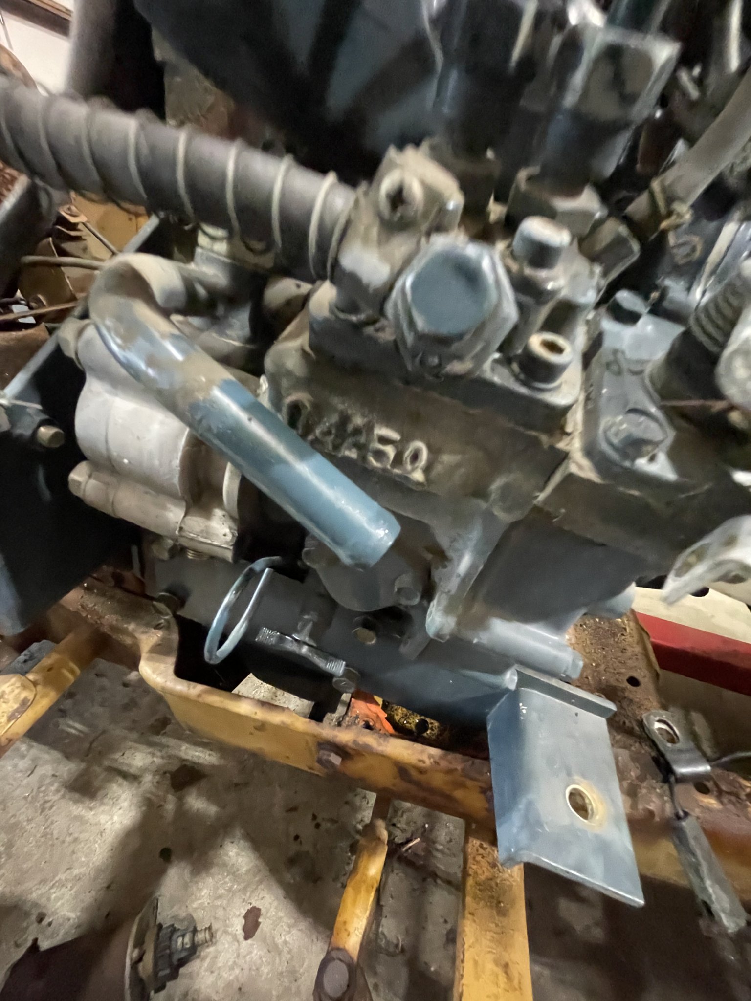

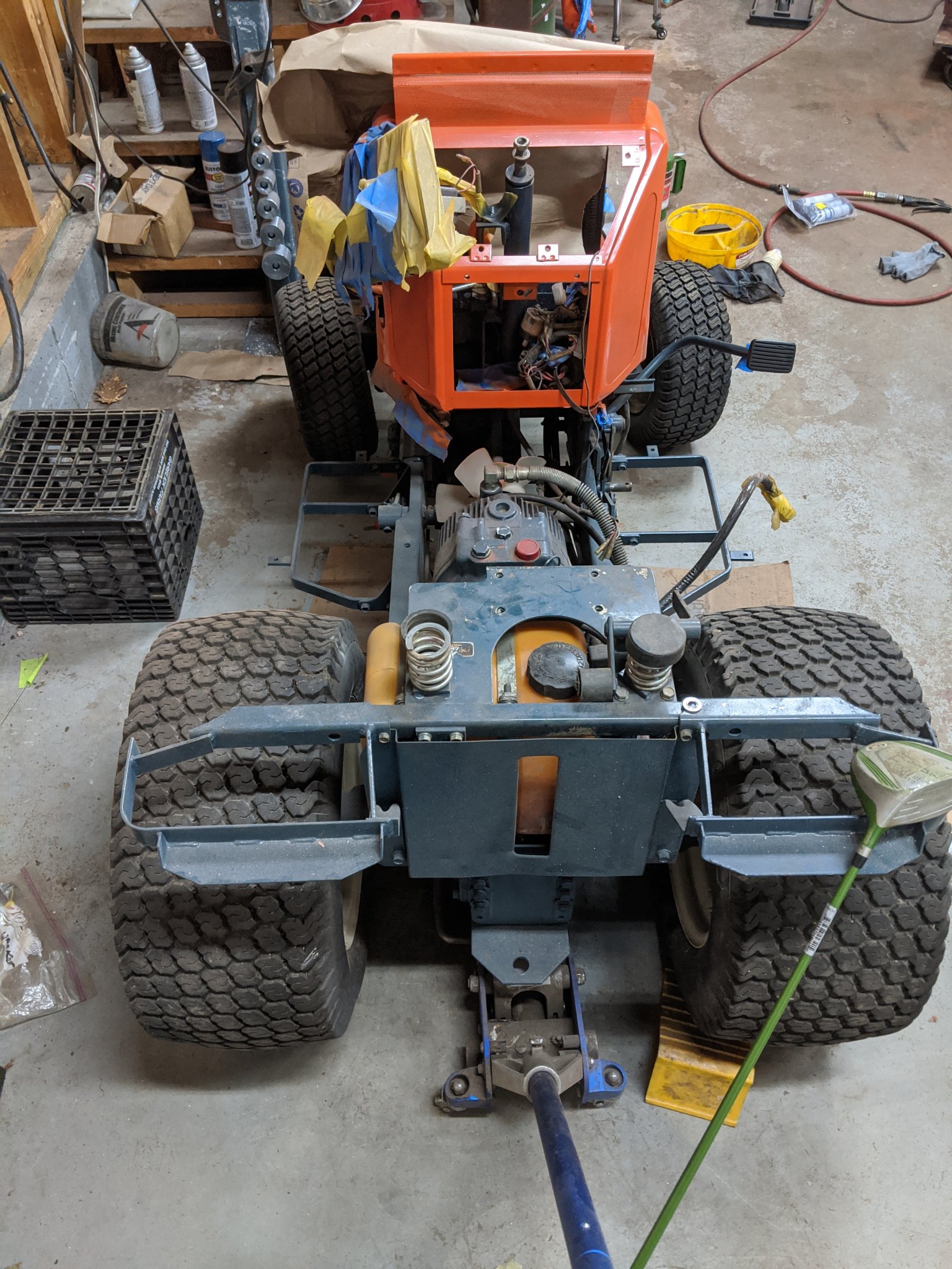

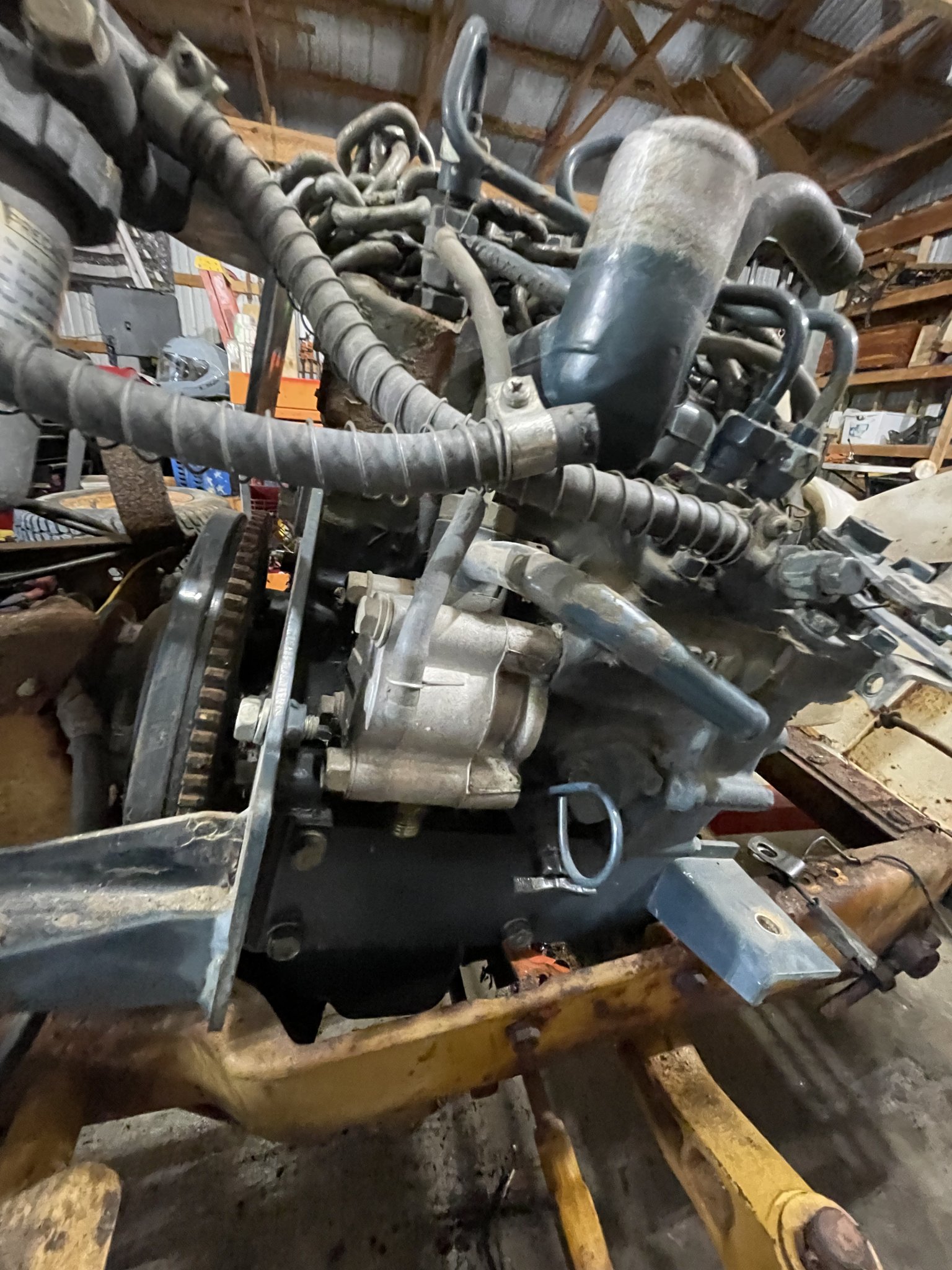

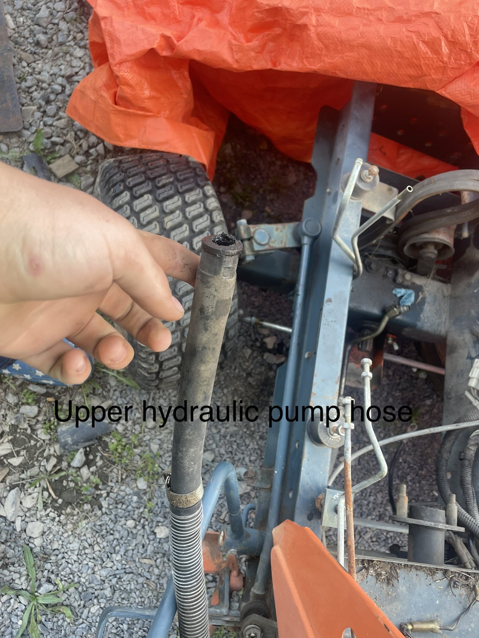

Good afternoon everyone, I’m hoping someone can help me out here. So I have a G5200 that I’m trying to install the rear three point hitch onto. Everything’s going on fine. The only problem I’m having is my hydraulic lines. As this three point came off of a G4200 which has a standard transmission. My first question is do I need to install the hydraulic pump that is mounted on the injector pump onto the G 5200. The reason I ask is because I was told since the G 5200 is a HST, it already has a hydraulic pump. My second problem is that since the G 4200 as a standard transmission, the line coming from the screen at the bottom of the transmission right by the oil filter doesn’t go up to the front underneath the transmission like the HST. In the pictures, you can see the rubber hose goes into that line that leads down to the screen, it wouldn’t work like that on the 5200 transmission as the hydrostatic has that line that leads back up to the under side.
If someone could help me out with this problem, it would be greatly appreciated! Also, I’m looking for a drive shaft for the rear 2000 RPM pto so if anyone has one I’m interested! View attachment 102111 View attachment 102105 View attachment 102106 View attachment 102107 View attachment 102108 View attachment 102109 View attachment 102110 View attachment 102111 View attachment 102116
