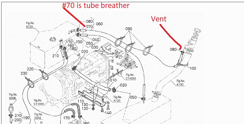

Two tanks are tied together for venting and then one tank has a line tied into the fuel cap assembly.

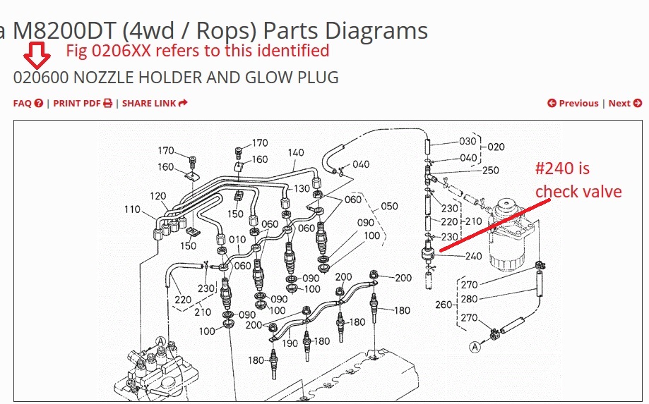

Hey dave, I tried to figure this out earlier this year when I had a line blockage; What does Fig. No. 0206 do? I think is it some kind of check valve but never found out for sure.
Dave_eng
M7040, Nuffield 465
Oct 6, 2012
5,123
931
Williamstown Ontario Canada
The trick to the parts illustrations lies in the Fig number.
In this case Fig 0206XX
This is a reference to a particular parts page which is below.
The exact item you are asking about is #240 on this particular page which happens to be a fuel check valve.
It is in the line providing drains for each injector so it is probably stopping fuel from backing up into the drains.
This is an educated guess not fact,
