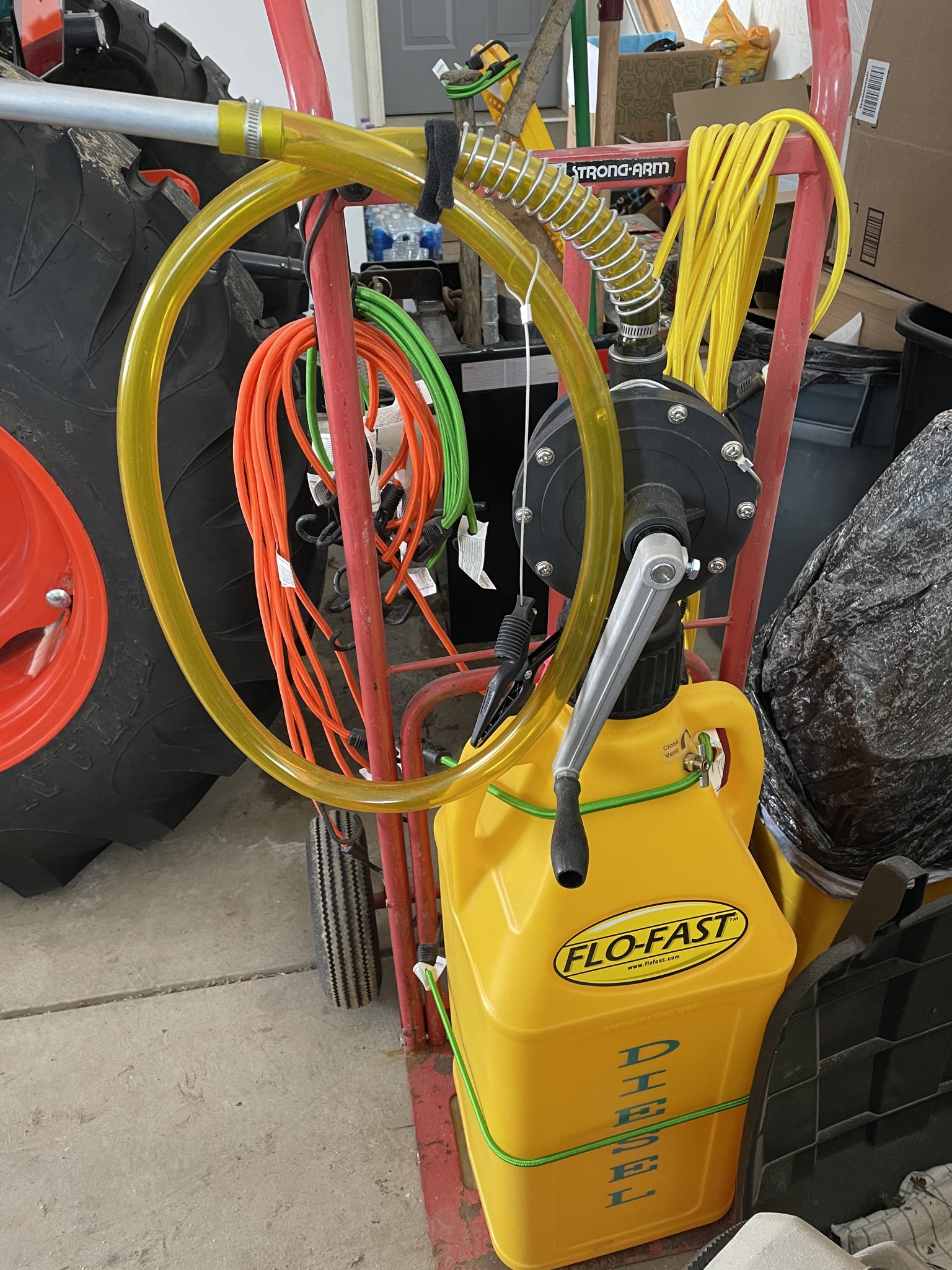

I have been using one of these for a couple of years now. In fact, I liked the first one so much, I bought another. So now I have one for the gas cans and one for the diesel cans.
Comes complete with an automatic shut off that kills the pump when the fuel level gets to the nozzle tip. No more spilling starting and no more overflowing at the end.

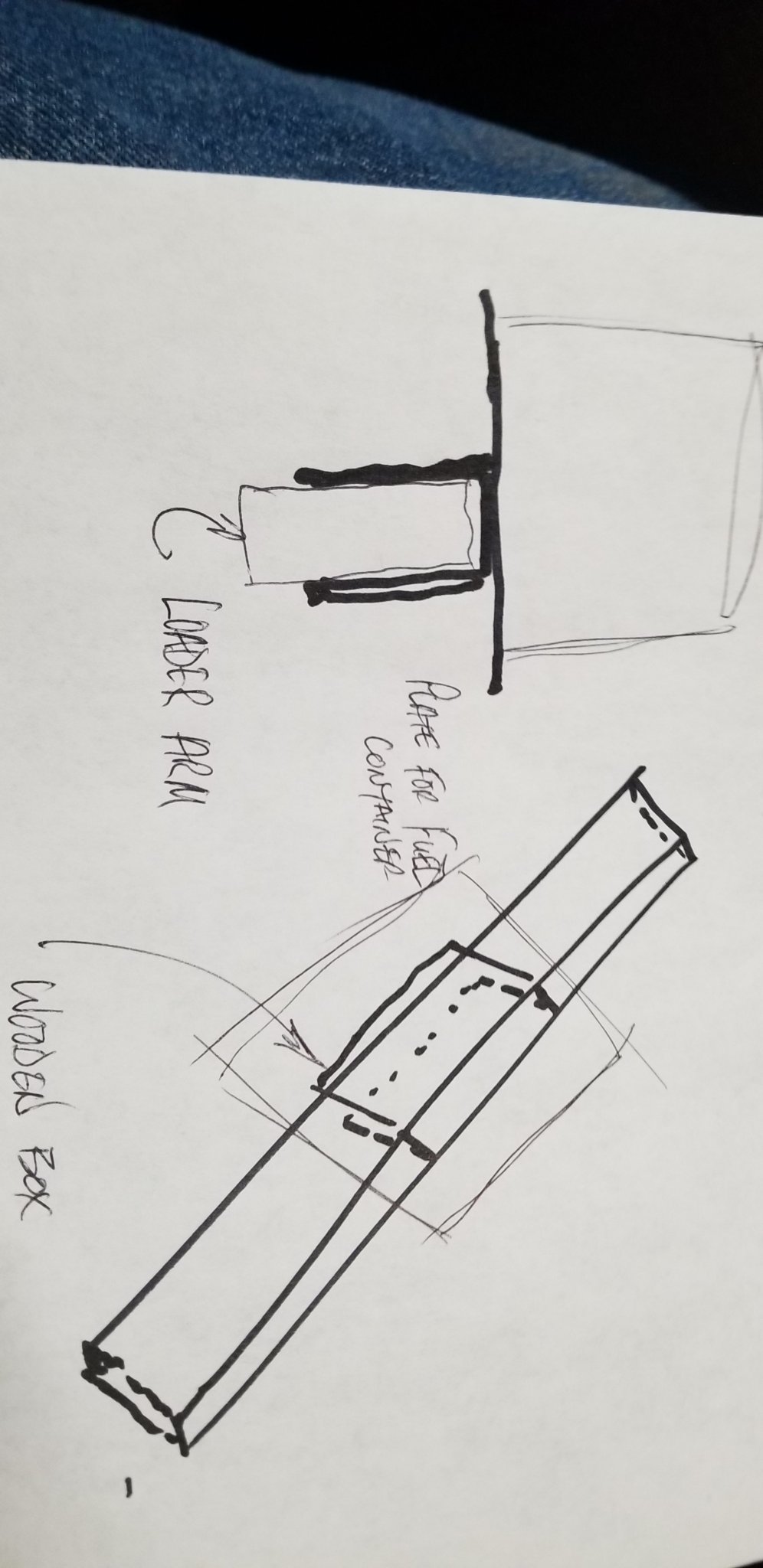

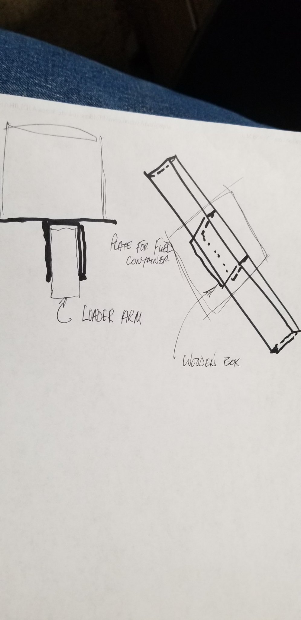

Skeets here's something you might be able to fab up and make pumping fuel easier. I made one out of steel, but you can make one with wood and screw/glue it together. It's simply an upside down "U" that set over your loader arm. There is a flat board on top to set the fuel can on and stays there without support. Then you can use a siphon pump or any inexpensive pump to easily fill the tank.
You could use 2x4 or 2x6 on the sides, 1/2" plywood on the top. I made the U wide enough to allow a piece of inner tube to set on the loader arm to prevent scratching. Just a thought.

Thanks guys, lots of good ideas, and the one for the bucket that is thinking outside the box thanks. I would like to see how it works D2, a couple pics would be cool ;)
