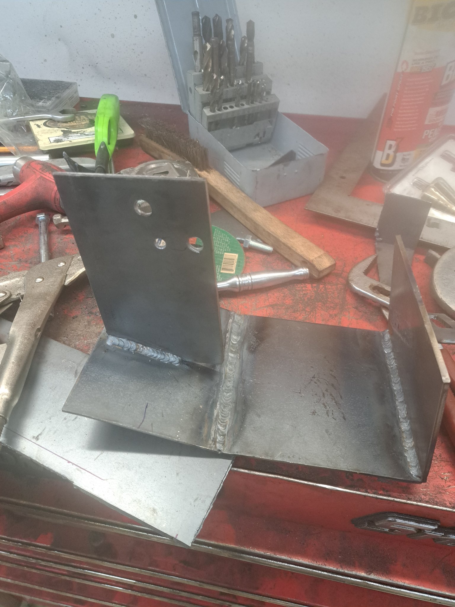

Started out with a piece of 10 guage A36 and basically bent, checked, cut....bent, cut and checked until I had the initial shape.
1,791
1,900

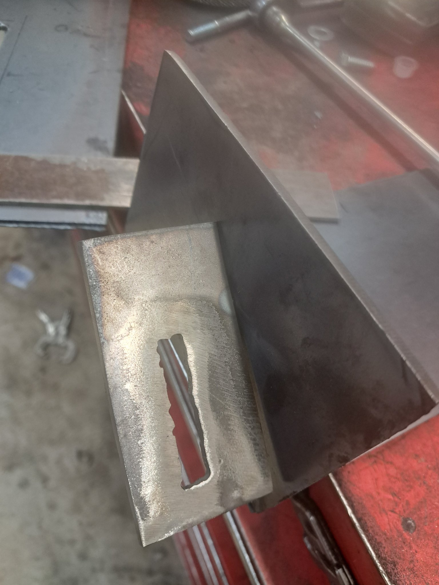

Then I decided to attach it using the 2 studs that hold the hood skirting in the front and the top bolt of the steering linkage in the rear.
Having that plasma cutter made quick work of roughing out the forward mounting hole.
1,791
1,900
After welding on a tab for the rear mount I soon discovered that the angle was going to be too steep to get it to bolt up properly. I decided to go with a different mounting plate so I cut the tab off and decided the remaining part of the tab was going to be a "decoration"
I decided to used the mounting bolts for the fuel filter itself so I located the holes and welded her up
1,791
1,900

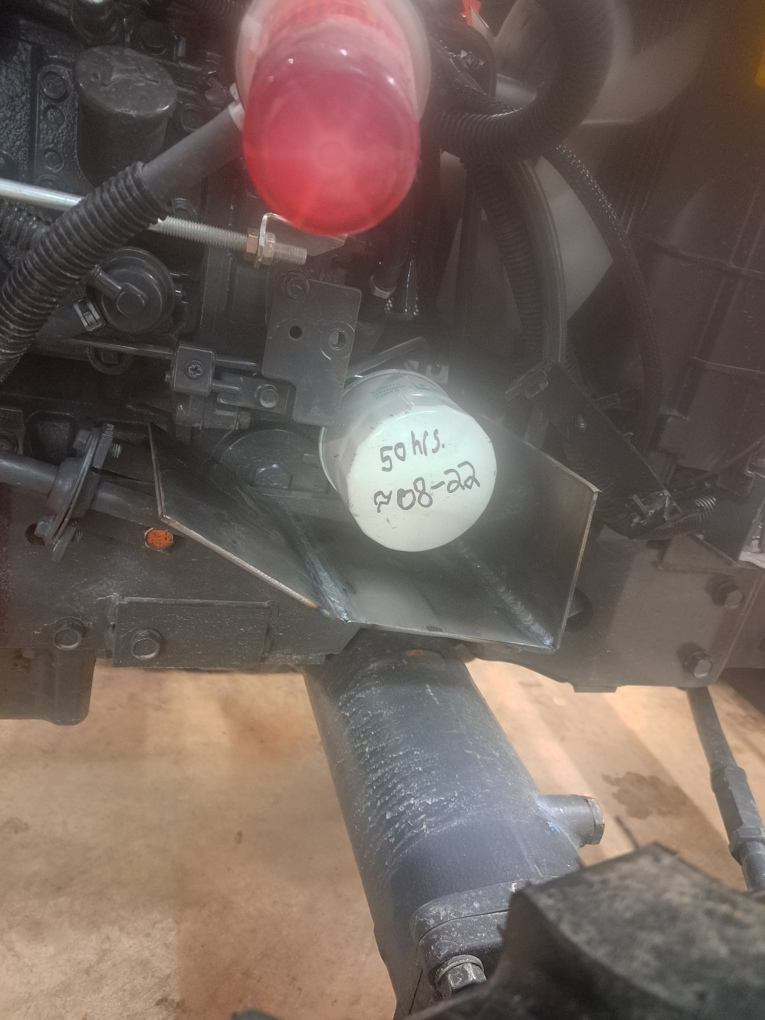

On the fly, I decided that I wanted some "side ways" protection yet I still wanted to be able to see the filter.
I had some expanded metal laying around from the brush guard build so I figured this would be a good use for it.
Then the top part was bugging me. It looked unfinished, and had all those sharp edges so I found some small square tubing in the metal bin.
Wait for it.....Wait for it......
Yes after welding it all together I went to go fit it it up and I'll be damne#!!!!!! I forgot to fit it up with the filter installed, so now it bolts up perfectly but that top bar is in the way of installing the filter. DOOOOH!!!!!🤬🤬
1,791
1,900
No photos of it (because I was ticked off about the stupid mistake)
but I cut the bar off and had one scrap of tubing left that was just long enough.
So off to the press I go and bent it into a U'ish shape to allow for the filter and tacked it in place.
While fitting it I then noticed that the fuel line was going to rub/hit the guard so back to the plasma cutter to freehand a cut out for the fuel line. Then a little work with the grinder and vinegar bath.

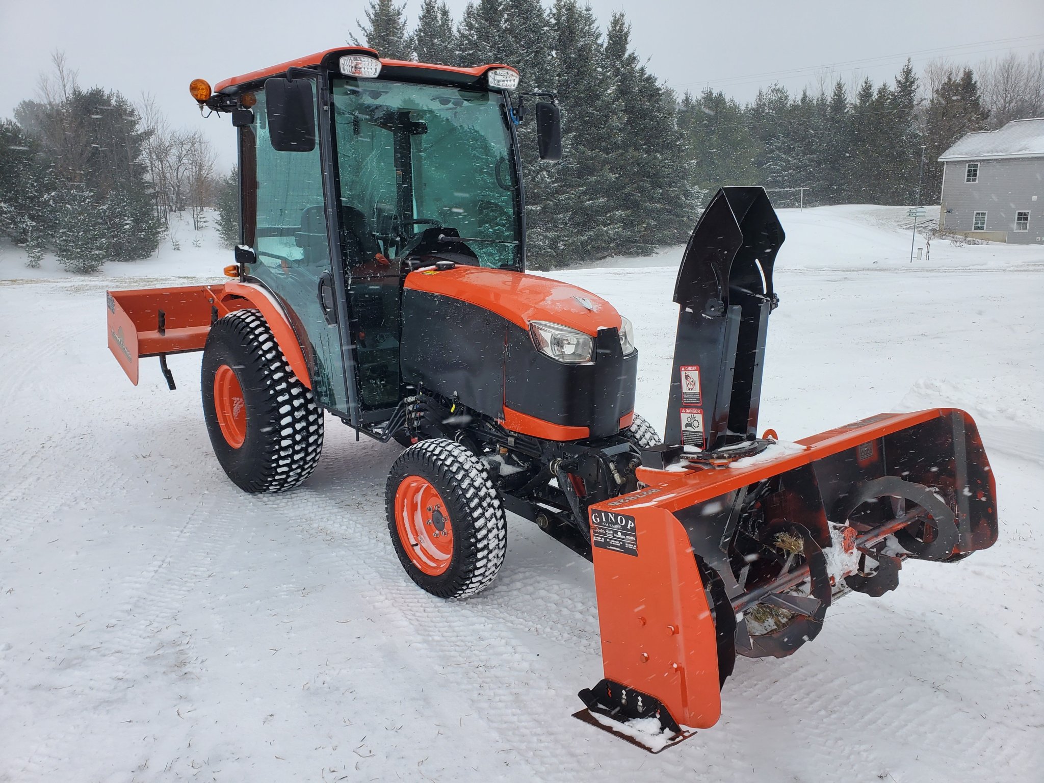

Nice job problem solving with your own fabrication skills. I see your Ginop Sales sticker on your tractor, I have that same sticker on my B2650. View attachment 94989
Very nice tractor!
Ginop's were nice people. I would not hesitate to deal with them again.
