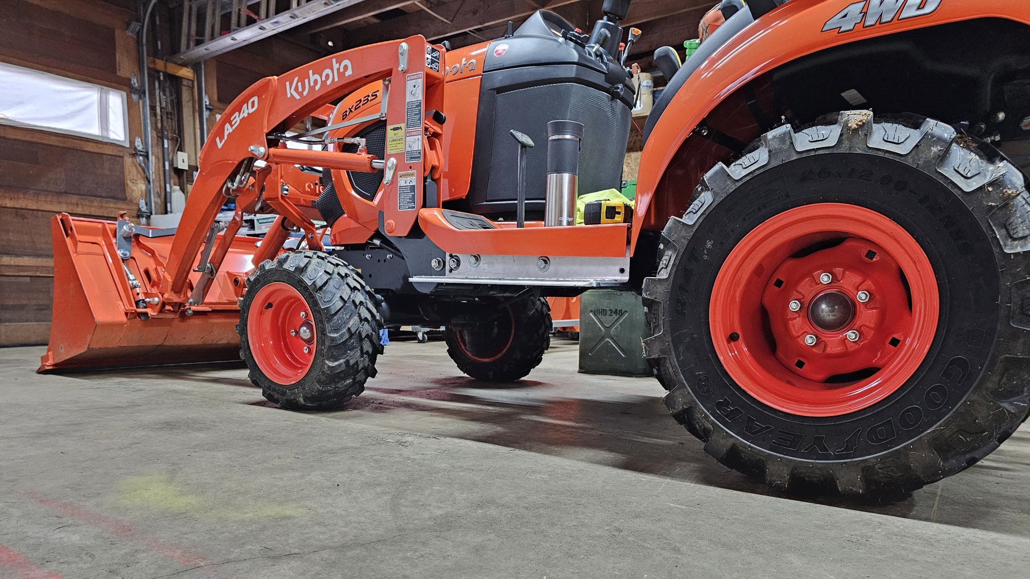

Hope not. I had all the wheels off, when I added (now highly polished since the image seen here) center caps. I forgot to torque the right front, and lost a bolt in the grass. Now I have spares.
