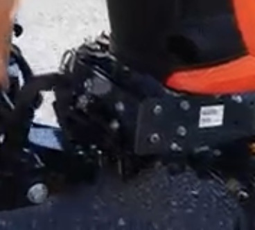

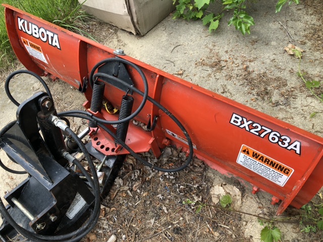

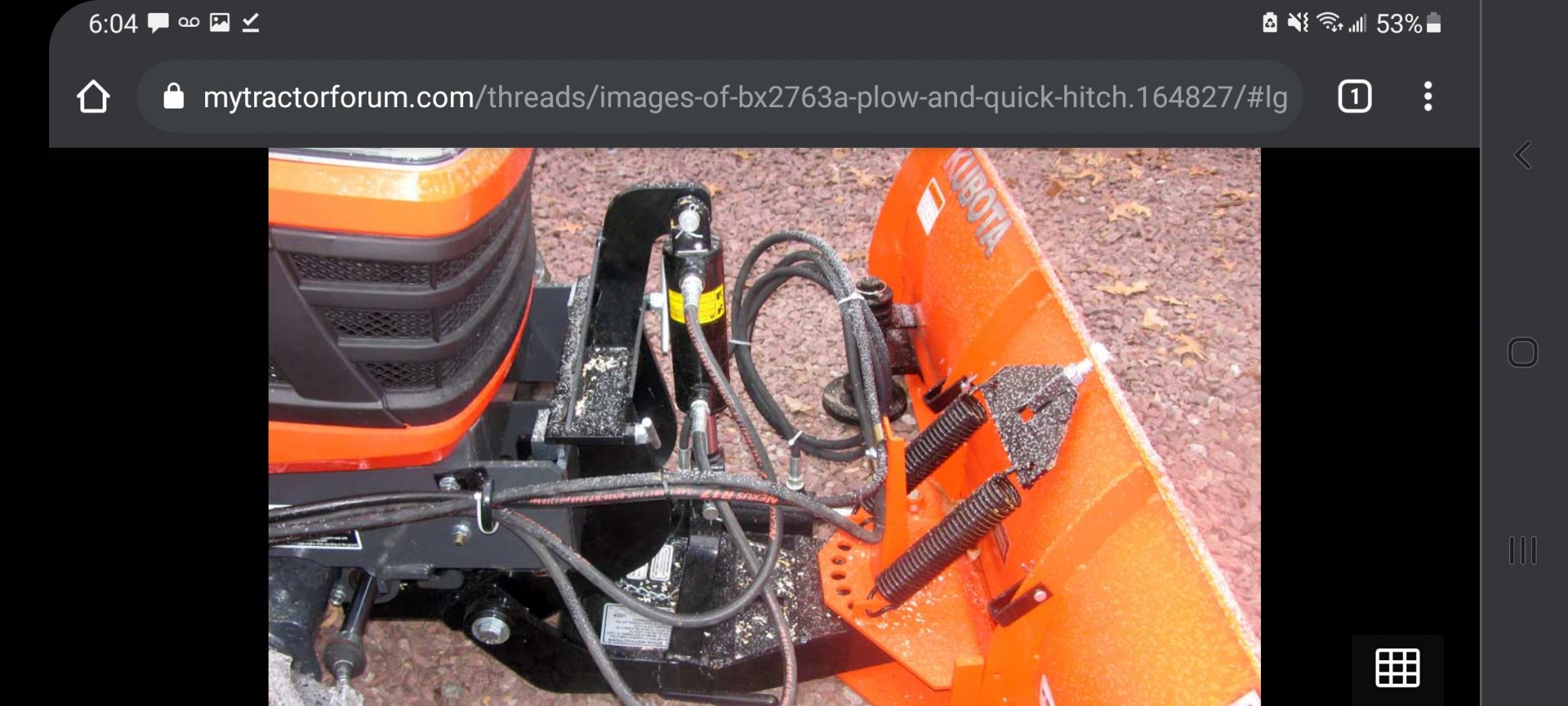

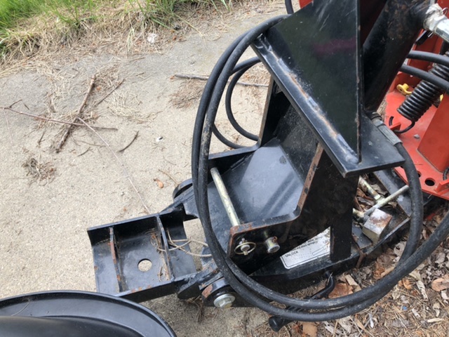

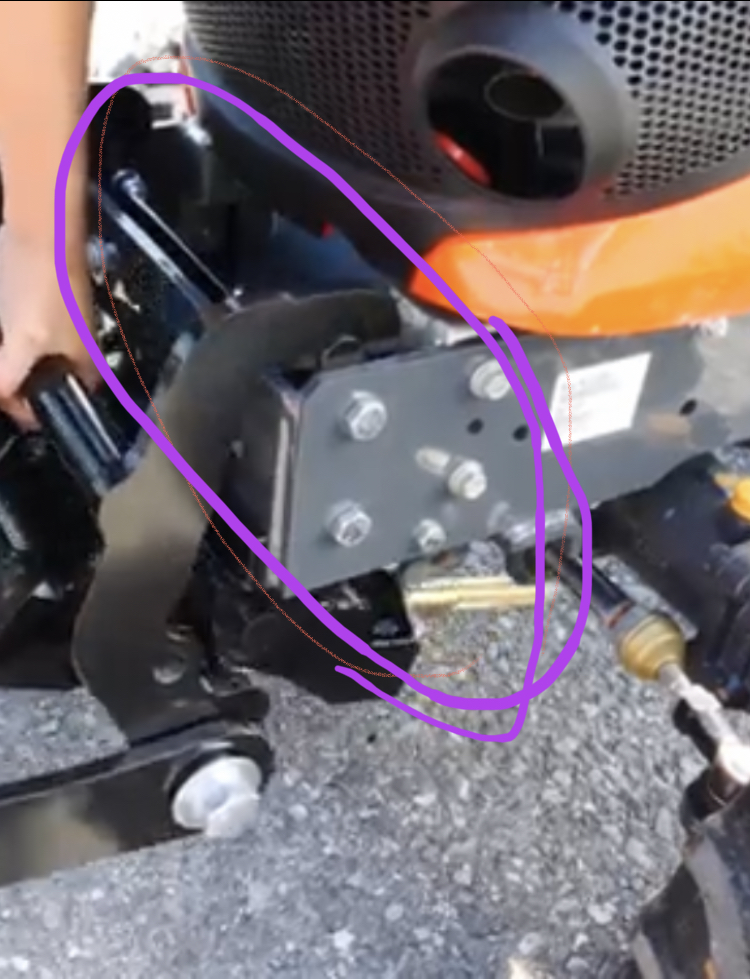

No it’s not a loader. The first 2 pictures are mine. The other two is from a video showing how to attach from Messick’s. I circled the bracket I’m wondering about in the third photo. I’m probably not using the right name for it.

BX2751 was the subframe and quick hitch for that tractor. It looks like it attaches differently than the pictures you posted above and you may have all the parts you need. If not, here is a link to all of the parts in the kit.

It looks like the same one I have. It hangs over the frame and the two pins go through where the m.m. mower goes. Only the mower OR the blade can be on the quick connect part is only for the blade. Hope this helped. Imine has two screw mounted to the top of the frame too forisky leveling for the pin mounts and to stop it from falling forward. Let me know if you need pictures. Or you succeed with the information I gave you.

It took me a lot longer to get out and look again but from the info you gave and just watching more videos I’ve figured out I have all the parts I need to attach it. There were two pieces that weren’t attached and figuring out what they were used for made it click in my head how to do it. They are what holds coupler onto the tractor on the part I circled in a previous photo.

Just hand tight and don't remove them when taking it off.
