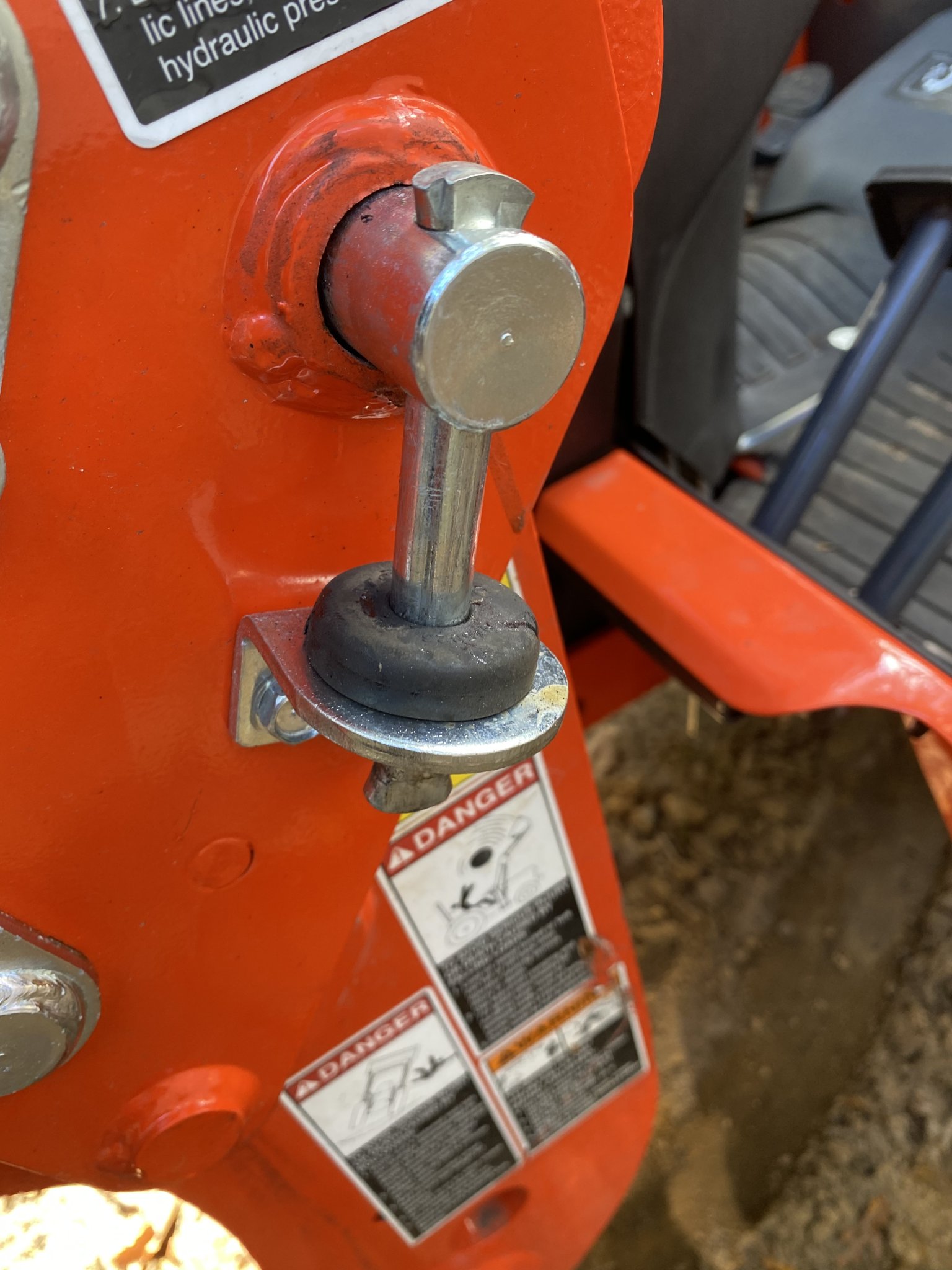

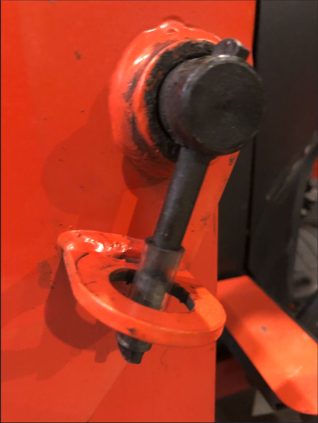

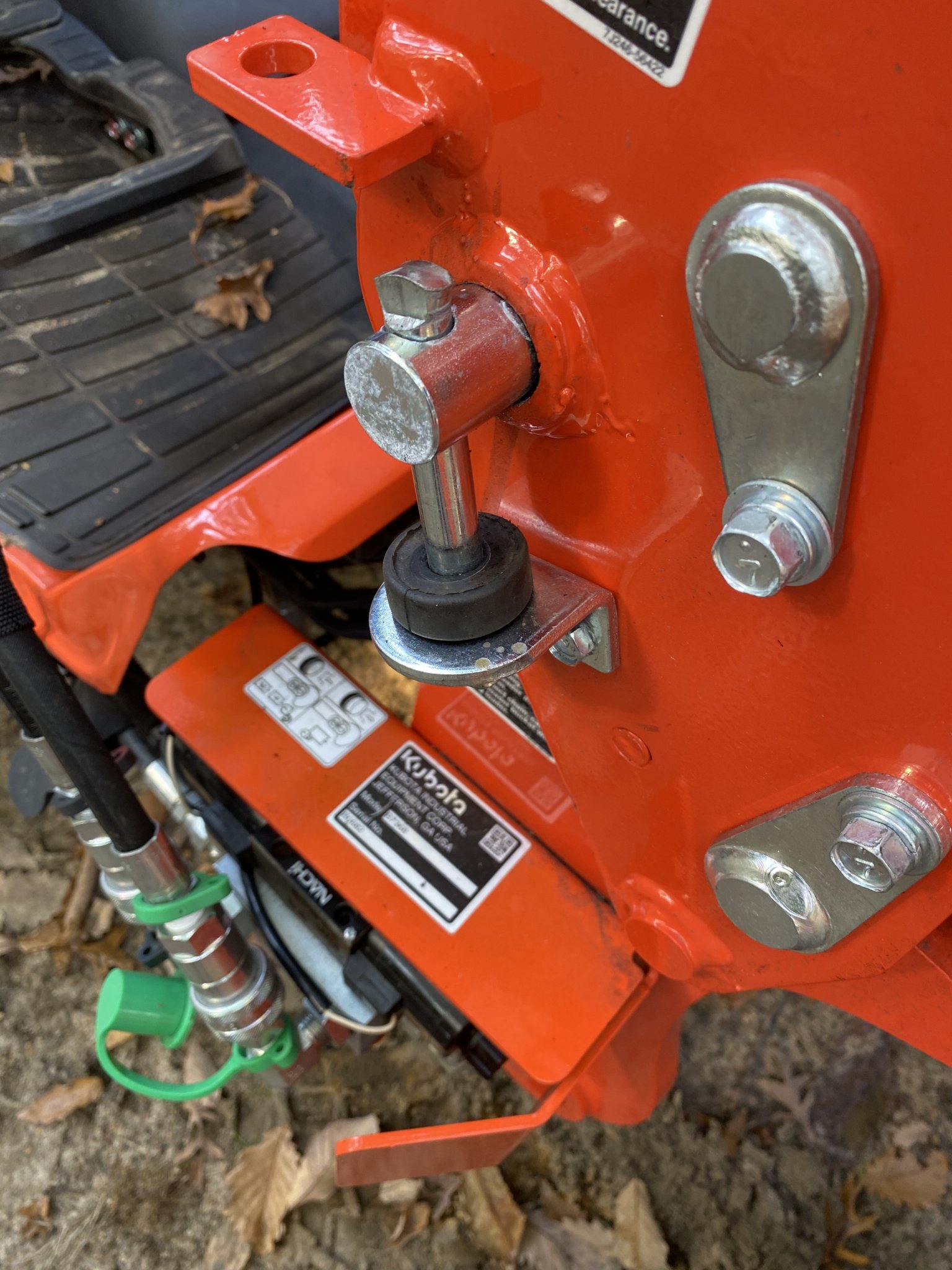

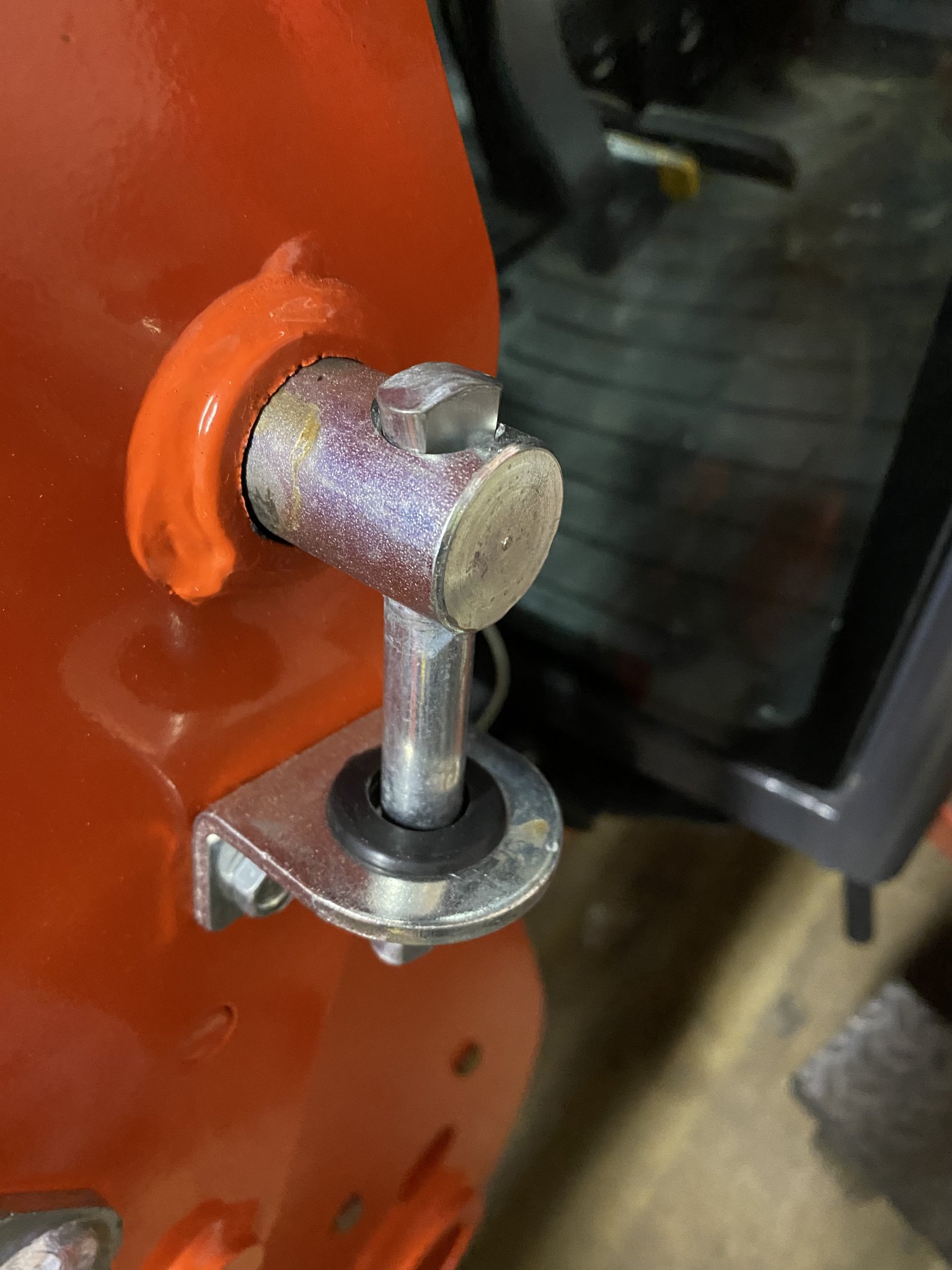

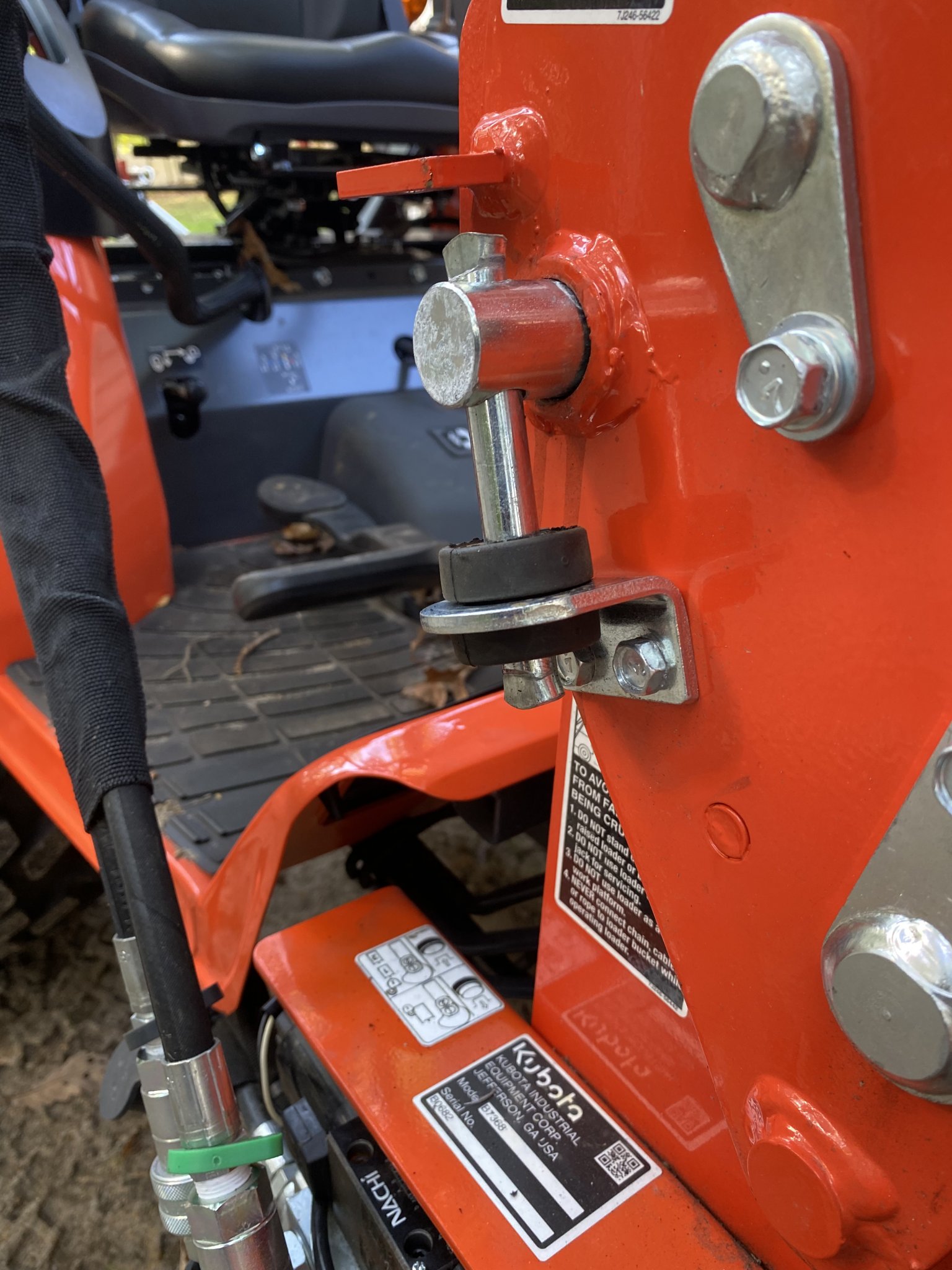

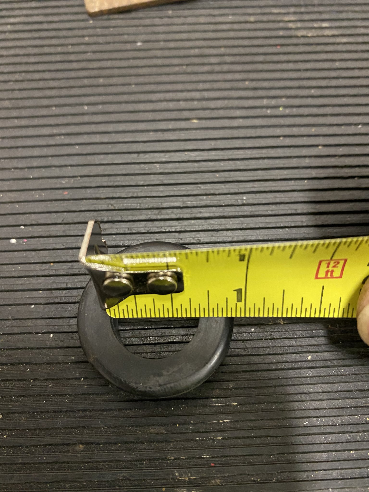

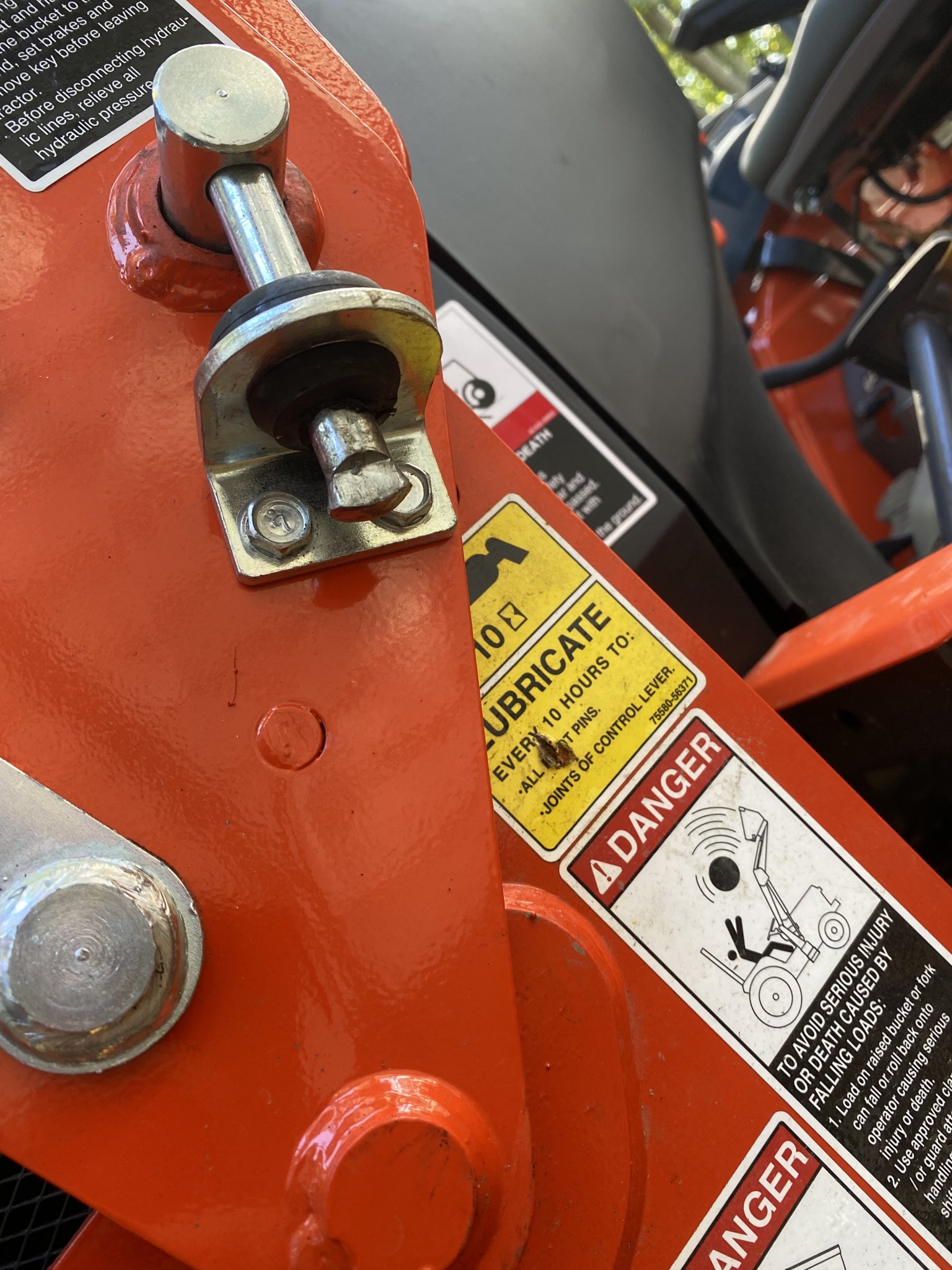

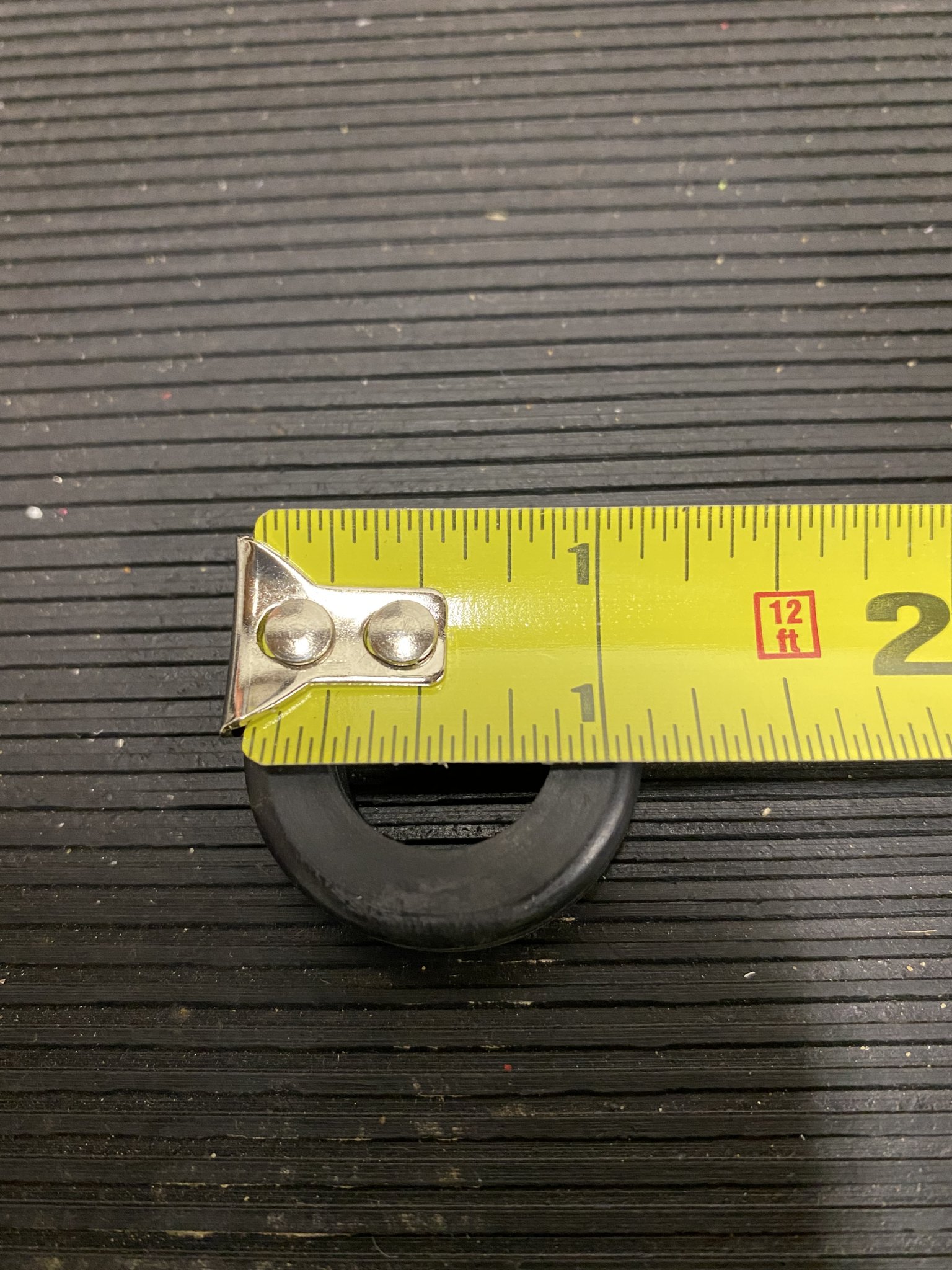

For those of you with the short pin problem, or just tired of that constant rattle all the time. This is a simple cheap easy fix. The first pic is a grommet from harbor freight out of their grommet kit. The last four pics are old radiator mounts. A friend of mine came up with that idea with stuff he had laying around. They can probably be found in the help isle at the local auto parts store. 269530DA-64C2-41E0-B5FF-747AA5E06049.jpeg CC8F4F7C-8290-443A-9F8D-A0FD942BB17E.jpeg 1C1BD4F7-4416-4170-88F8-1A671F50E429.jpeg C708BAE8-FB09-4E54-8108-9FD49724C477.jpeg 15E02C6B-8619-4DD2-B8AC-CBDFA14D38D0.jpeg CEA307CE-96F7-495C-B3FA-F4CCB2D8B495.jpeg 6C5BFB9B-D153-4FCA-85C4-5574B0AA8AA0.jpeg

Whelp, I used option B.
I cut a piece of fuel line approx 1.5" long and slid that up the lock pin. Short enough to allow for removal but just long enough to stick up through the pin keepers. I don't have the short pin issue, just some rattle. That should take care of it for me.

ok, well, not real exciting...
point was that the hose doesn't have to be removed to get the pin out...that's what I was going for. Just hope that it quiets it down a bit. Perhaps most of the noise is coming from the large pin rattling in the bore?

Perfect to stop the rattle, the piece i had Was a big piece that filled the hole, i have The short pin problem and rattle problem lol. The hose you have should work well.
