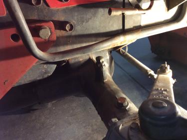

I was changing the front axle oil and noticed the bolts that limit the front axle tilt are not set the same on each side. I hadn’t noticed it while operating and believe they have been like this a long time. Maybe I am OCD but it seems they should be set equally. So do I move one up or the other down?

When I rebuilt my front axle, I found (after power washing 35+years of dirt, grease, & grime) that I only had the stop bolt on one side. I replaced the missing bolt & nut, and adjusted as above.
But it made me wonder how necessary they really are; mine had obviously run for decades without it. Food for thought.

I agree this adjustment does not need great precision. I have about an inch more tilt to the left now and never noticed! Maybe it was set custom for driving across a slope - one way only?;)
