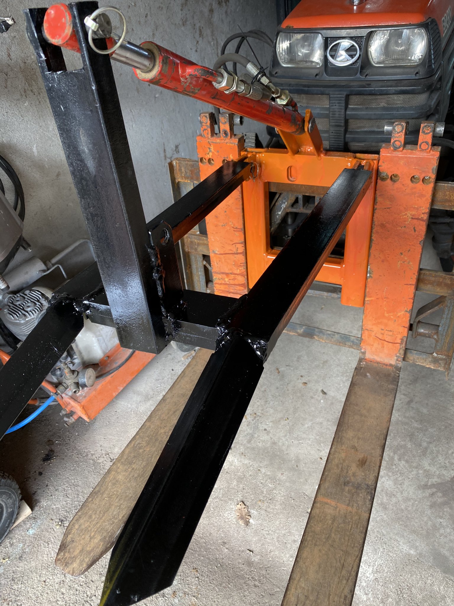

Hi guys, made this multi-use front and back harness or whatever one might call it... So far I added a quick removable car hitch, small forks that slide sideways (90cm)...
Planing to add flamer for under the grape trees (almost done, 130Kw),
All materials used are from my junk pile or junk yard. I got a good deal on the quick-release car hitch (I think it was originally used on a BMW 7series).
Some photos below, work in progress. Please comment and advise if you think something could impreove it.
Thank you.

So-far cost 30 euros. I already did my balast weights for the front, made them out of two scrapped forklift forks. I found at the dumpyards, 60 kilos but I can easyly add more. I use it for when I have the 250 liter sprayer on tha back or when I pull the grapes out of my vineyards during the harvest... i made a good bucket that can be dragged or lifted... so I can load up about 18 crates with no issues.
See link and photos below.

Progresed quite a bit today with my limitd collection of tools ***128557;***128514; and my amateur skills... but I am willing to get cut with the angle grinder that is what matters... i will post photos tomorrow and hope you guys can give me ideas to make it better.
So far:
- built a very rugged frame out of parts from a pallet roller and a fork lift that was dismantled.
- recilcled 3point connection point added
- front triangle works like a peach
- bmw x5 removable ball hitch welde all together.
- tested the forks, they slide sideways...
- built part of the grapple that attaches to the forks (this is only to be used to remove grape vines after pruning... but built it for other purposes, 7mm C profile
- tweeked the repourposed hydraulic cylinder position for the grapple
Sold my MIG welder today (Telwin 210 synergic), gotta pouse untill my Kemppi three phase mig arrives.

There aree a bunch of solutions out there for weed control, we have a small operation, family worked... lots of those solutions are not affordable and I can not justify the expense. So for the most part I fabricate what I can and need. :)
The Carry all was hit, I have been using it more than I would have imagined, sometimes I have it hocked up front when I need something else on the three point hitch in the vineyards... when I get there, I just lower it on to the casters, do the work... pick it up and go back home...
