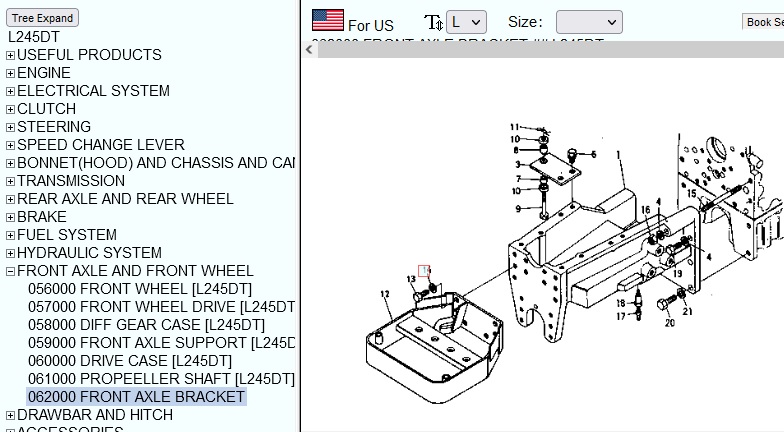

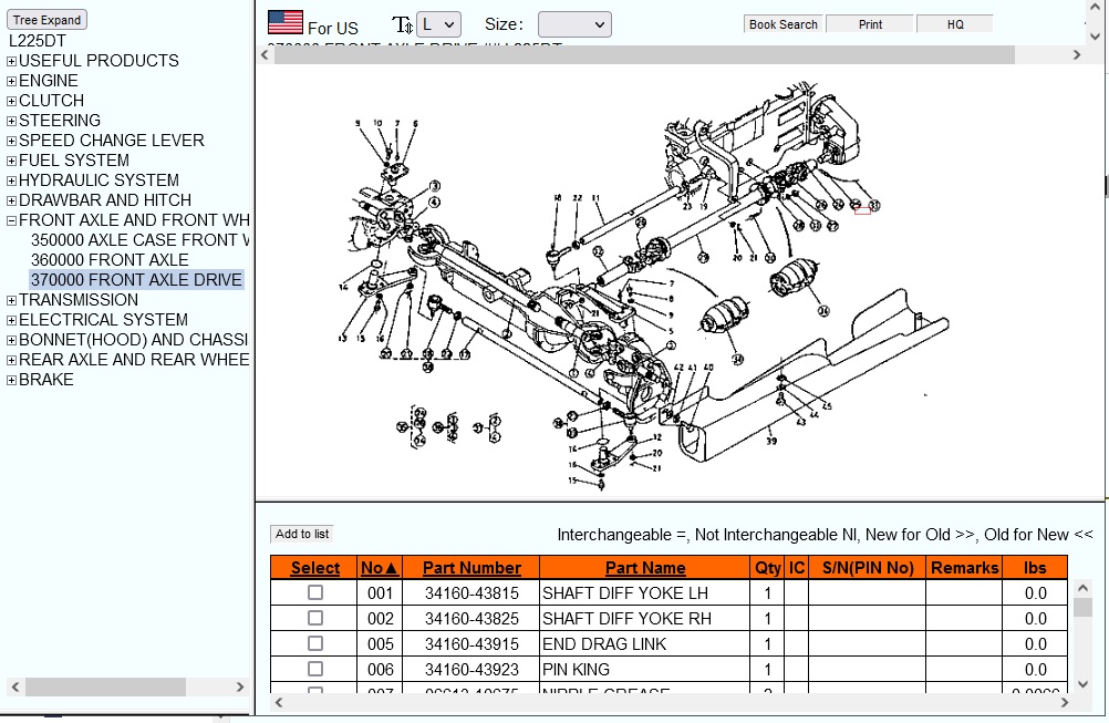

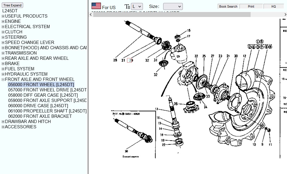

Two quite different tractors from the 1970's. Front wheel drive was an after-thought on the L225. The differential was off-center, with a driveshaft coming from a side gearbox on the transmission. The axles had u-joints.
The L245DT got a completely redesigned system - with centered differential and driveshaft. The kingpin drive feature was added (giving better ground clearance and tighter turns) .
For a time around 1976 both models were produced - but the L245DT general design idea became the standard.
View attachment 68572 View attachment 68573 View attachment 68574
