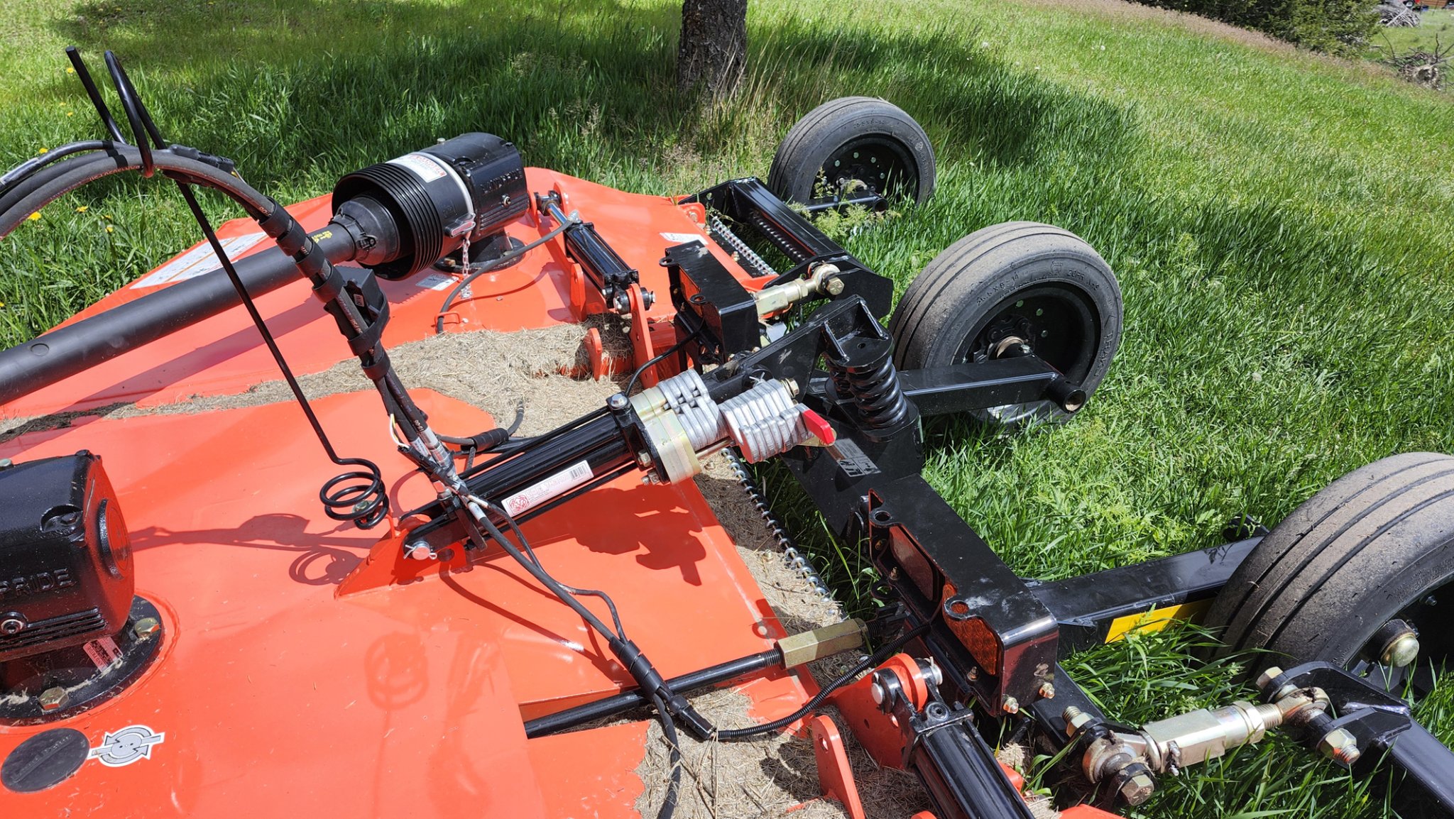

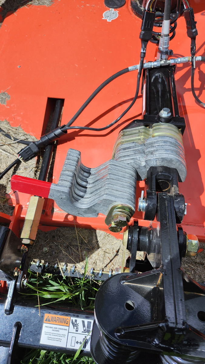

On my folding cutter there are two wheels at the rear of the center deck and one each on the wings. The minimum height of the center deck is controlled by a series of spacers that can be in or out of the stack. The main deck hydraulic ram bottoms out on the stack.

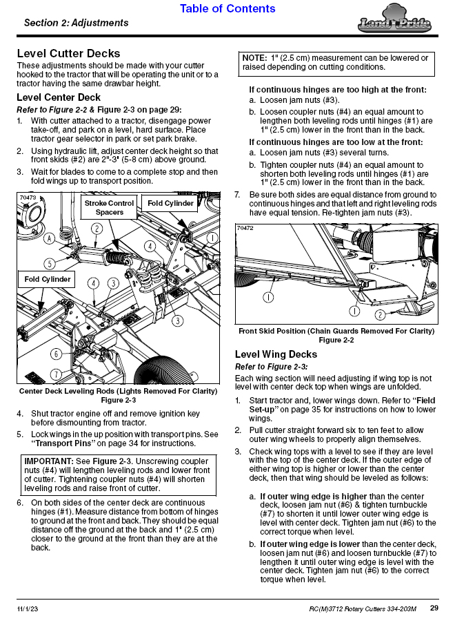

There is also a rod that connects the rear wheels to the front hitch. As the wheels move up and down, so does the hitch. This is keep everything level throughout the height adjustment range.
I'm 99% sure that the long/large bronze colored nut, with the similar colored jam nut, on the left side of mcmxi's 2nd picture is the adjustment nut for his leveling rod. Can also be seen in the first pic towards the bottom-right.

Exactly. You can see the how the leveling rods connect to the hitch A-frame. They're adjusted to get the correct angle of attack of the center deck relative to the drawbar. I included a page from the owner's manual detailing how to adjust the center deck and wings for a particular tractor and drawbar combination.
