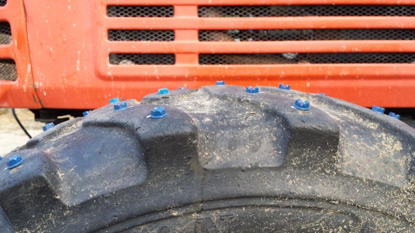

I love mine! Also allows you to do crazy things like stud them!
They ride just a little rougher than air filled but, the added weight is a nice feeling, and really helps with traction!
One disadvantage to keep in mind when the tires wear out you'll need to not only do new tires you'll need to get new rims too. You'll probably recoup that cost in not having to do a ton of flat repairs.;)
