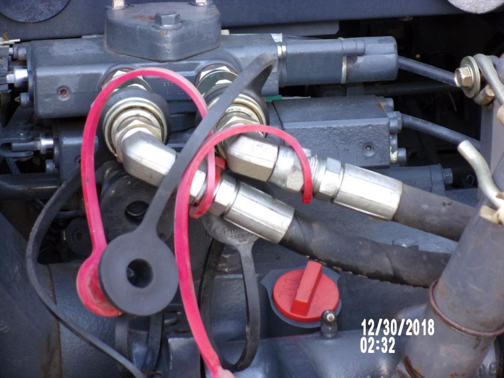

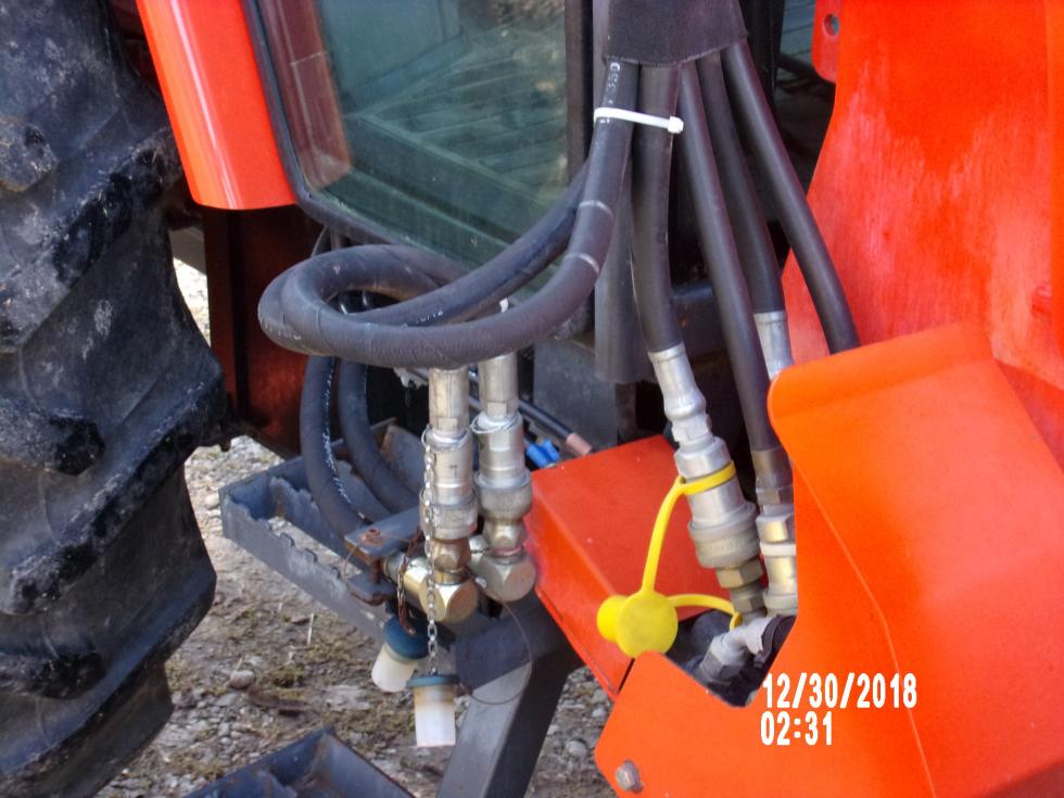

Did you ever get the actual couplers changed so that ALL the female ends are on the tractor and ALL the male ends are on the hoses? :confused:
I just insisted on this. I am being told that it's typical in the smaller tractors to have pairs of male-female for each implement.
I have reviewed the 3-Valve Stack Kit installation manual and the Top N Tilt Kit installation manual. Each has numerous contradictions with what sex couplers go where, depending on whether you look at a photo, a diagram or the text!

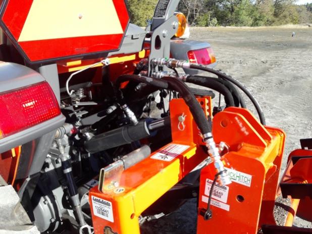

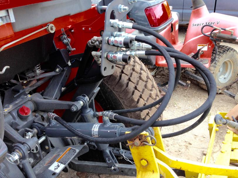

Post a picture of your top cylinder if you would.
Does the side cylinder react the same way?
Again, your dealer is an idiot. Every single Kubota starting with the BX, B, L other than yours, Grand L, MX, M series tractors all have the female couplers on the tractor for the rear remotes. Why would Kubota say to have it any other way? And honestly, even if for some unknow reason they have mixed installation instructions, there simply is no good reason not to switch them around and easily get rid of your issues.
Since your dealer refuses to do this, why don't you? It might take all of 45 minutes and ALL of these problems that you are having will go away by simply switching hoses around. You would no longer have the problem of this hose won't plug into this outlet.
If for some unknown reasoning you insist on having the male-female sets on the tractor, simple switch the male female couplers around on the hoses them selves.
Simplify things, you are making this FAR more difficult than it is.
I understand that it might be the principle of the thing, but just take care of it yourself and get on with life. Why make things harder than they already are???? :confused:
