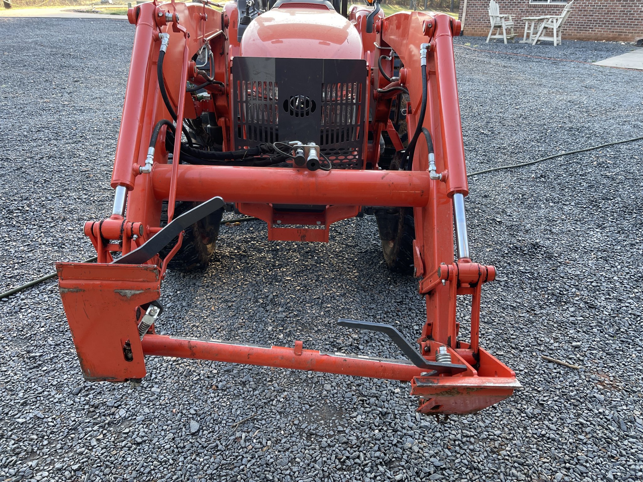

Well, if you saw my previous thread about the grease fitting, I told you my next issue wouldn't be QUITE so easy to fix...
My used B2650 is wonderful, but does come with a few issues I'd like to correct. The current issue is the SSQA, which as you can see in the picture, has the "feet" out of alignment. My goal is to try and fix it.
So, wrong answers include:
  • Buy a new SSQA
  • Cut it and reweld it
If those are the only options, then I'll just live with it like this. I don't like it because it DOES make attaching stuff more difficult than it should be. I sometimes have to step on the bucket or forks to get it to align enough for the pin to latch. Annoying, but bearable.
I did find a video showing them un-bending their SSQA using the hydraulics. Unfortunately, my FEL doesn't have that configuration, so I can't simply mimic what they did....but something like that seems do-able to me, if I can figure out a safe way to do so.
Youtube: Easy way to fix a bent SSQA

Just fixed mine about a month ago. Just bumped the forward one against a tree until eyeball straight. Works like new again. Don’t need to overthink this one
Wouldn't the hydraulics fight against being pushed in?
Obviously not, since it worked for Yooper. You don't have individual supplies to each cylinder; pushing against one will just force some hydraulic fluid into the other cylinder.
Yes. That is exactly what you want to happen.
I know how I bent mine. I was using my bucket hooks to lift something heavy and it got off center and caused the left plate to bend forward. Bending it back was easy with absolutely no drama.

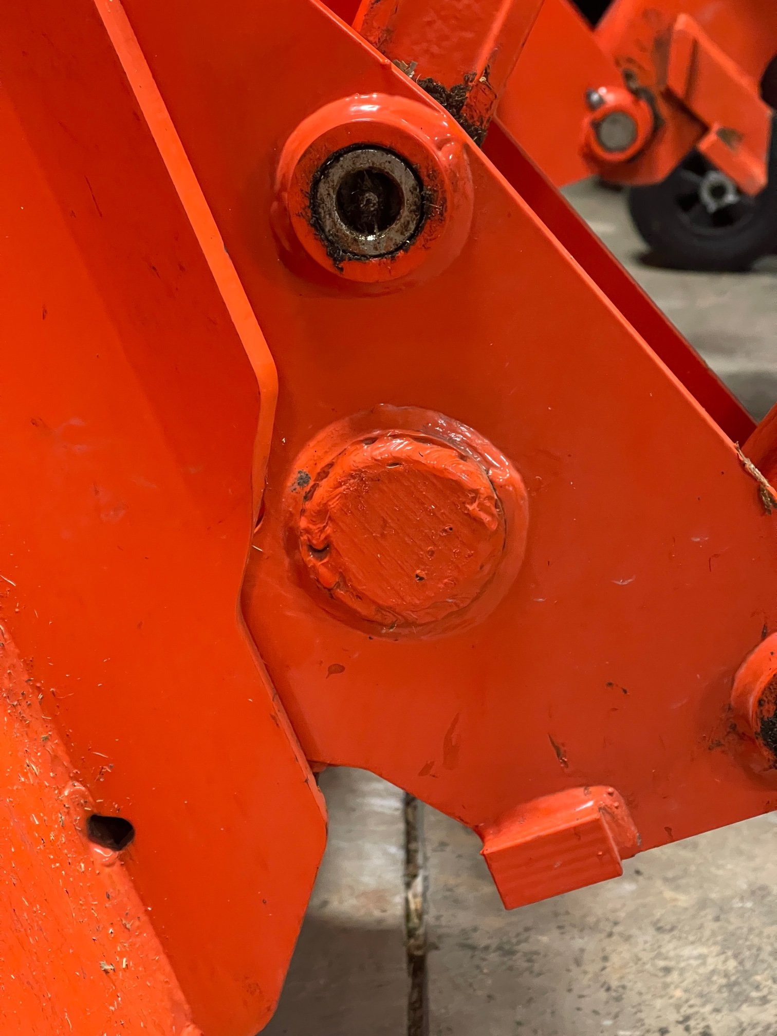

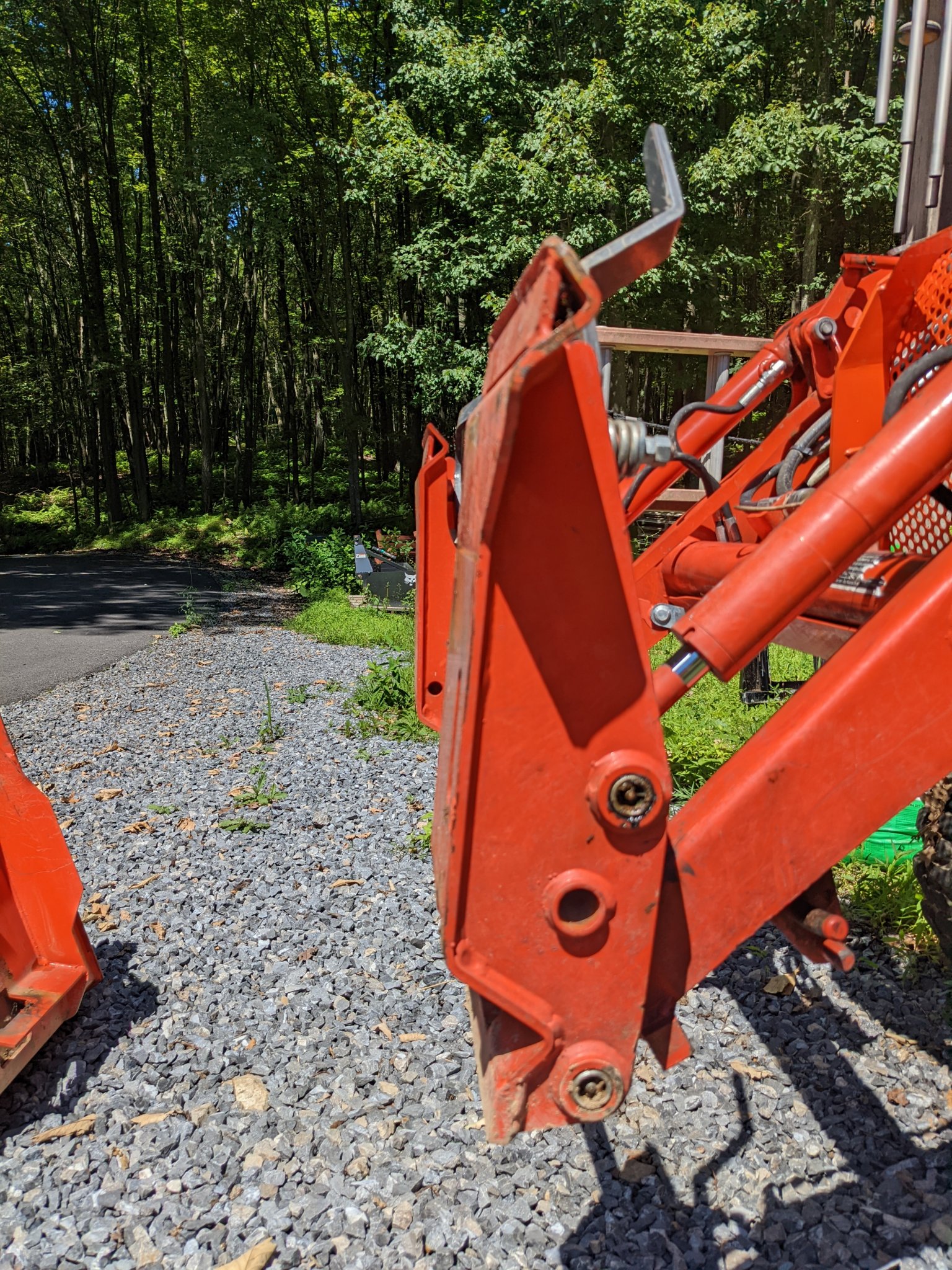

My SSQA was bent much worse than shown in your photo and could not be straightened
( Photo Left ).
KTAC replaced SSQA and I took damaged SSQA ( I asked for it back and Dealer said no problem) to a local welder that had experience repairing tractors, farm equipment. He had repaired damaged SSQAs several times. In my case we took several measurements off of new SSQA he then cut off the torque tube at loader frame on both ends of tube set everything up on his fixture table and welded in a 2" hydraulic cylinder rod (Photo Center). On the new SSQA torque tbube he inserted a full length piece of 2" round stock and welded round stock to torque tube (photo Right).
I would get your SSQA straight like shown in video or as others have suggested and then sleeve the I.D. of the torque tube with the proper size round stock.
You are a genius. A little driving into a tree and they were inconsequentially out of alignment. Hooking up the pallet forks was SO MUCH EASIER. Thanks!
And for the record, there's nothing I don't overthink. I think....

I believe a wise man once said "there ain't nothing bent that can't be unbent!"
nbryan
Jan 3, 2019
1,161
705
Hadashville, Manitoba, Canada
