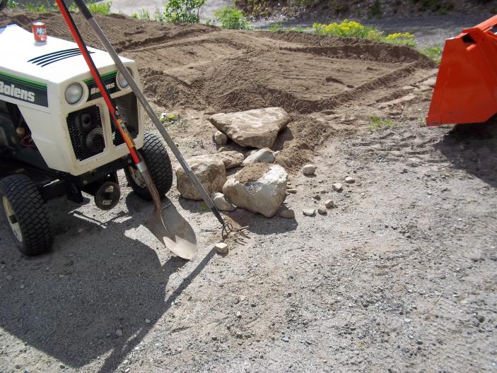

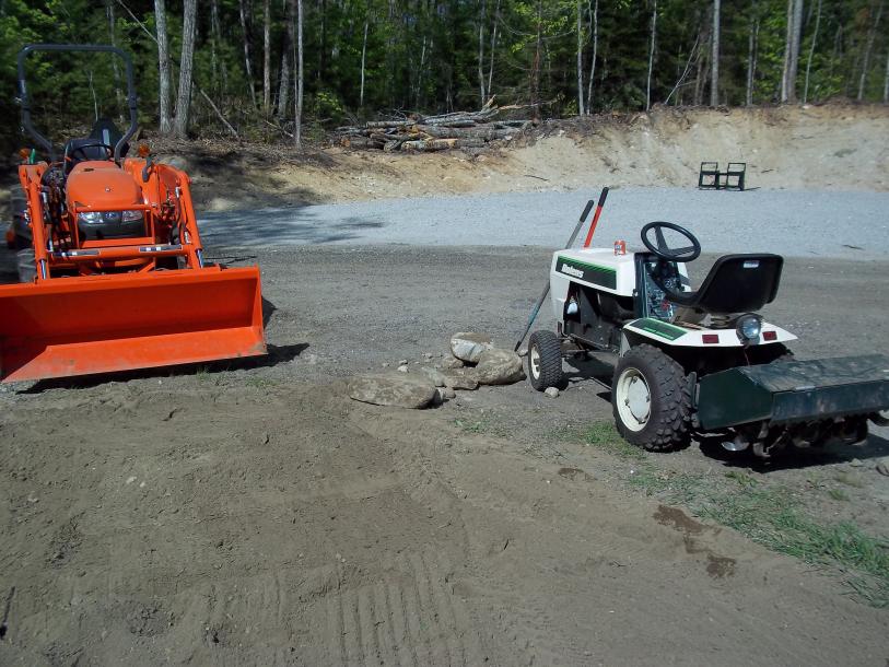

I was working on my garden today, its a huge thing , if you actually took a tape measure to it , I'd say it would be 8'wide x 16' or so long. I was tilling with my Bolens 1669 tractor, at the end of the garden I'd bump a rock, going back bump...bump..so I got the shovel did some digging,,,,.well it looked kinda big...so out comes the L3800....ya there was a rock there all right. Here's a couple pics....

first keep the attachment at recommended rpm. and adjust your speed for conditions and the load you place on the attachment. if the cutting results are less than desired, slow down…
those pebbles are a sure thing to dull tiller blades...
