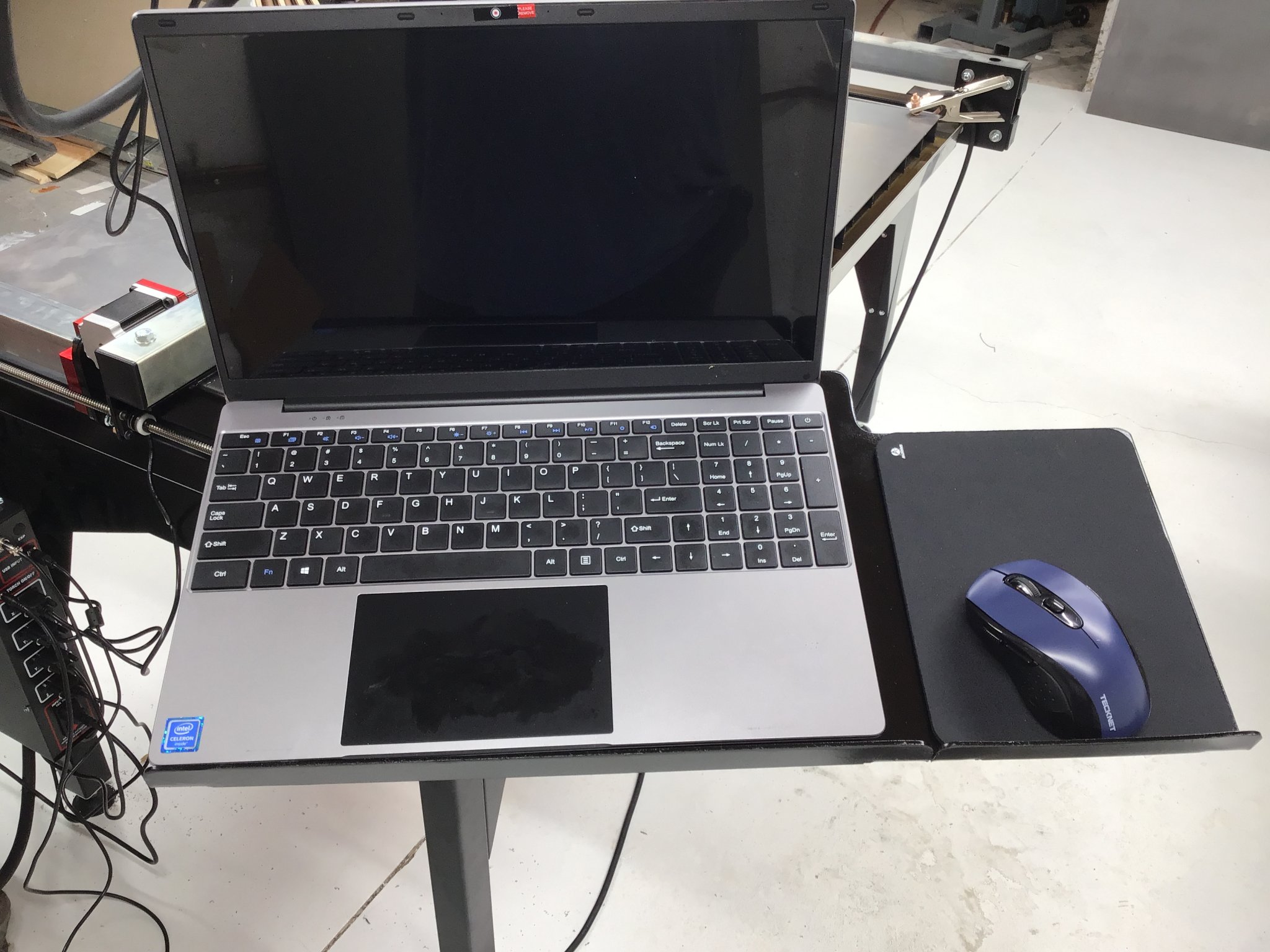

I decided that the laptop stand I ordered with the machine needed an “upgrade”
I am hopelessly addicted to using a mouse, so not having one when working was not going well.
So yesterday, I decided that remedying that was going to be my first project.

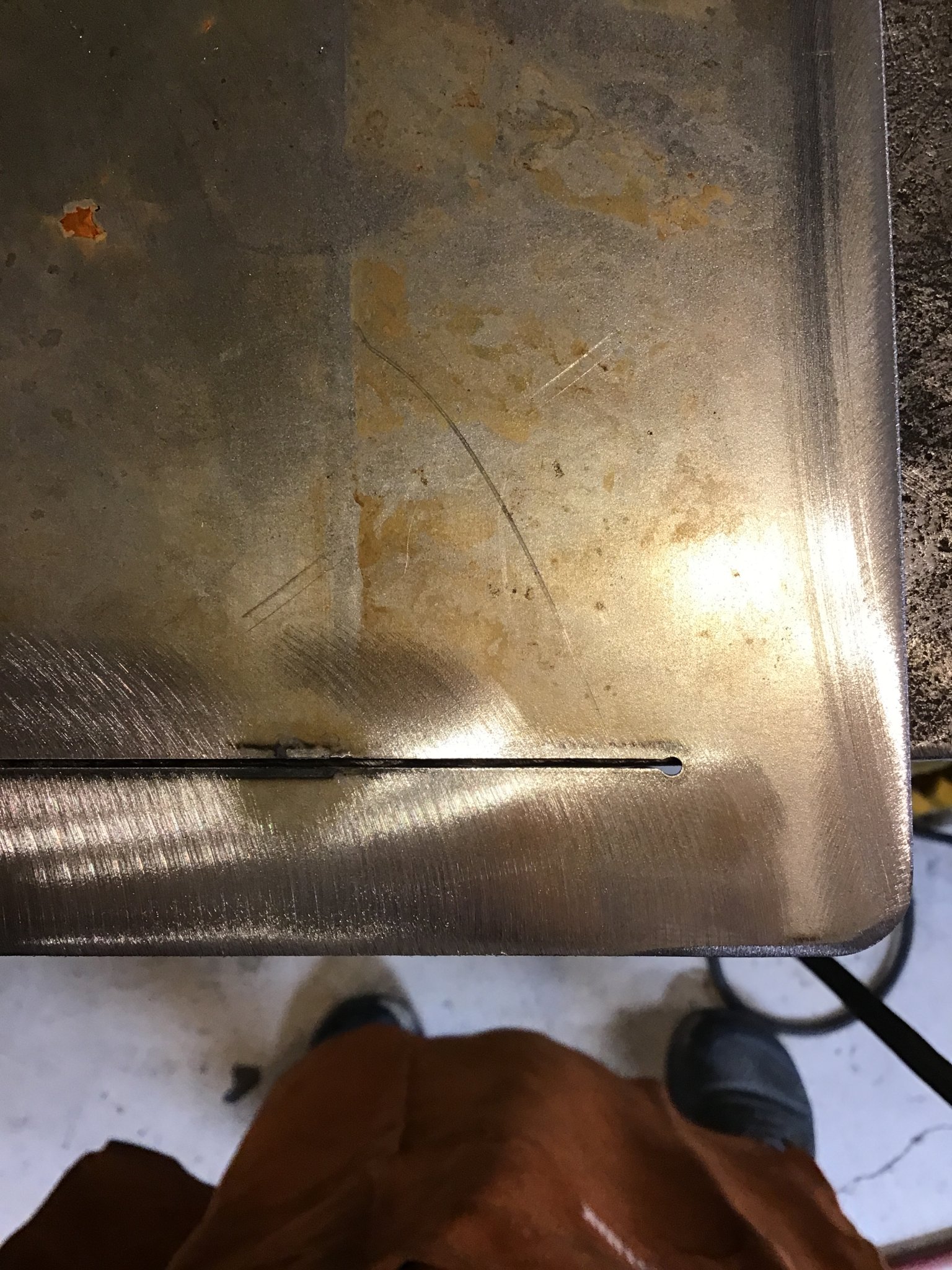

I drew it out, and after the guys on the Langmuir Forum "straightened me out" and 'learned me' how to start in the corner of a sheet, here is the first project cut.
Took about 75 seconds to cut it out.
What a "game changer"
I gotta figure out what I screwed up, but the holes turned out "poor"
They are "located" properly, but the"lead out" should have been eliminated(?)

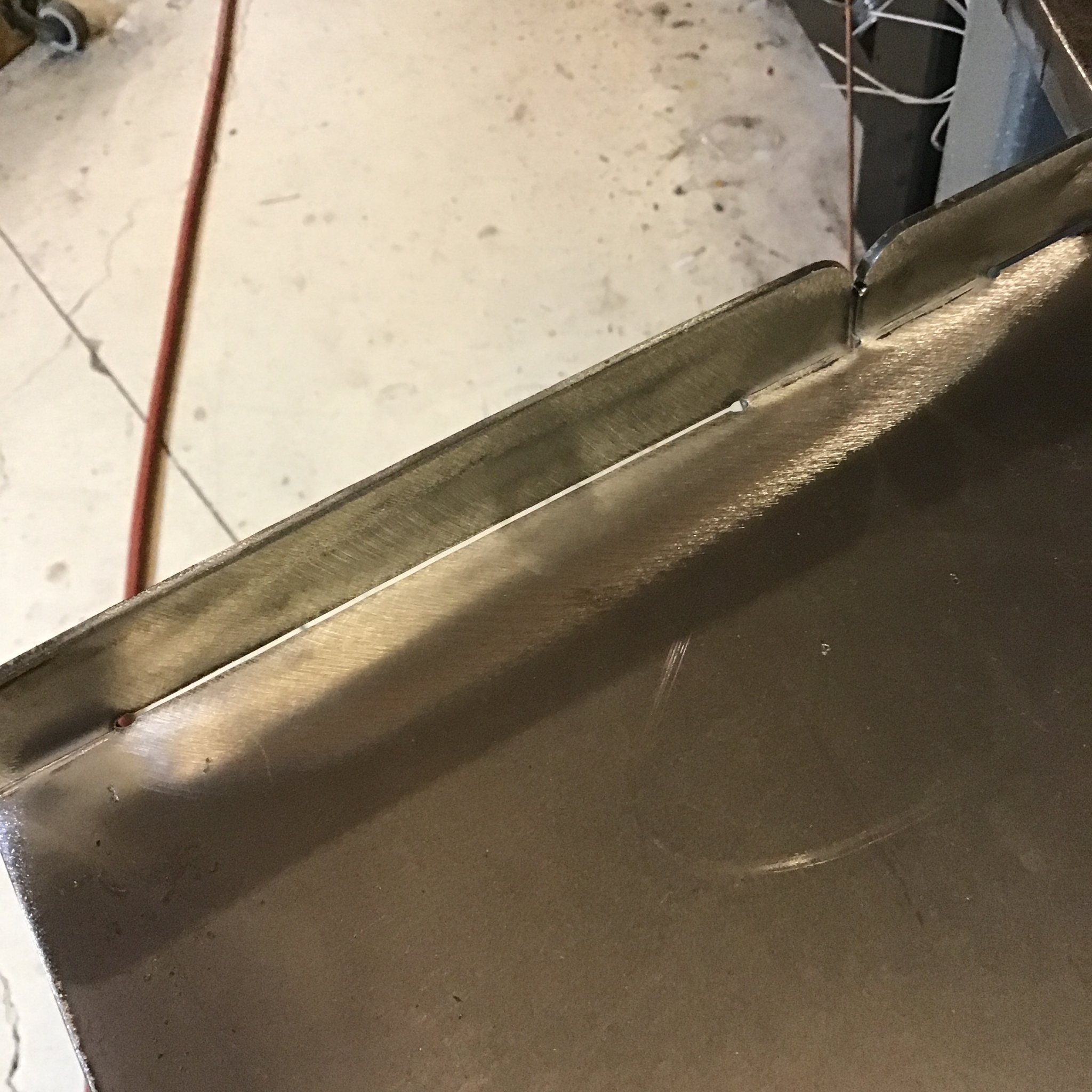

Turns out to be a little to large for any 'brake' I have, so I just clamp it to the edge of the welding table and "have at it" with the ball peen.
But those holes are mocking me........
So I decide to break out the TIG machine and grinder.
and a little work with the countersink, and the holes are "good nuff"

Ahhhhhh......there we are. Life is good with my mouse again.
The end.
