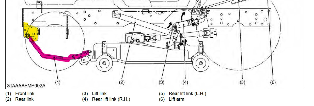

First - welcome to OTT!!
Assumptions:
1) You acquired/have an older used tractor
2) None of the linkages 1 through 6 shown below came on the tractor
(note: picture is for my tractor not yours, but you get the idea).
3) You do NOT currently have a MMM.
4) You DO have all the 3 pt. parts on the tractor.
Option 1 (my pick) - get a finish mower, and maybe a Quick Hitch for easy on/off. Might be challenging if you're mowing around lots of obstacles but gets the job done.
Option 2 - Buy All the linkages, buy a used MMM, fix, install and adjust everything, mow to your hearts content. More labor involved and possibly cost, but doable.
If you DO have a MMM with the PTO shaft and are just missing the Front Link and bracket (highlighted) then I'd try to find one and go with the MMM. An easy fix. Never looked for a front link so not sure if they are even available for that tractor or what it would cost.
