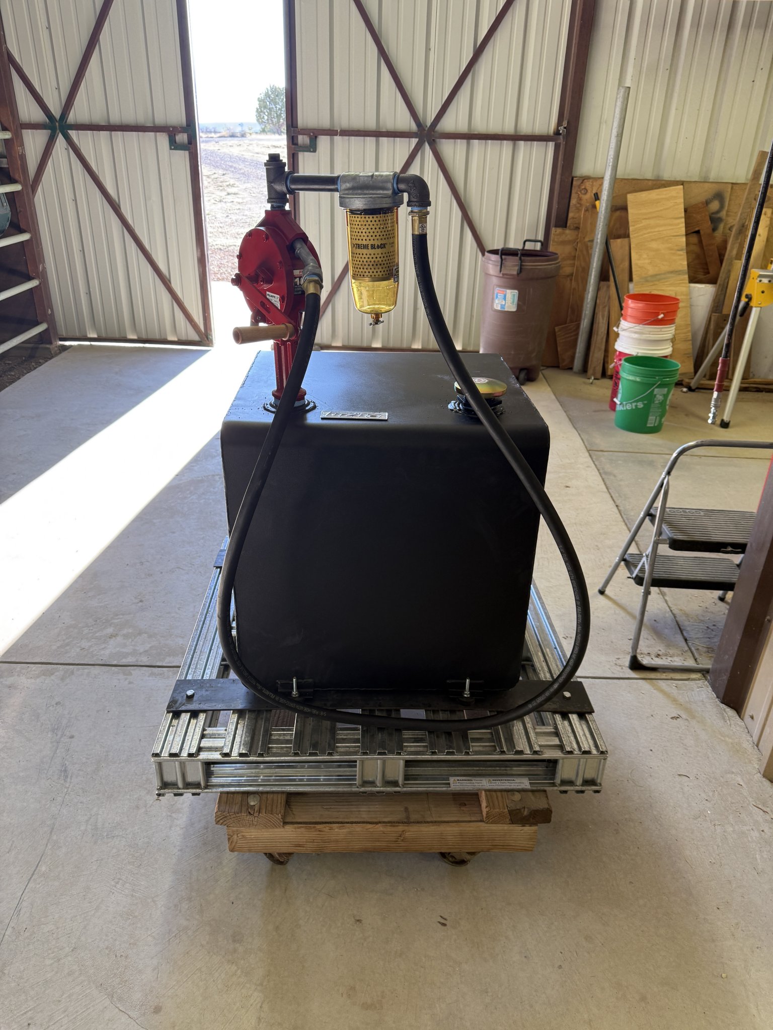

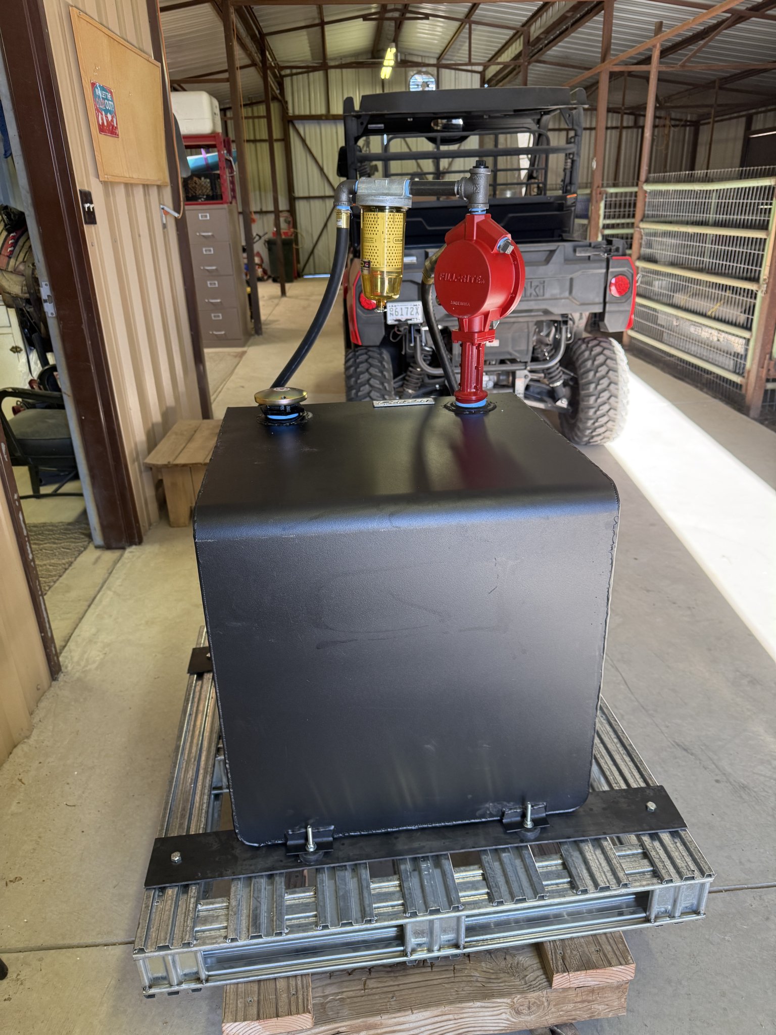

55 gallon tank mounted to a steel pallet, sitting on a steel wheeled dolly. Rotary pump and water block/particle filter. Easy to load in/out of the truck with pallet forks. IMG_2531.jpeg IMG_2528.jpeg

Looks nice.
I have a similar pump but I get aggrevated with it because it leaks at the handle seal whenever I pump. Wish they had a better seal.

Mine is a Fill-rite pump and it does have a warranty, so I’ll see.

Nice setup. I would like to get some of those galvanized pallets.
I have a 100 gallon Freightliner tank set up with the same filter and a 12V pump. I just have the fuel delivered but I haven't had as much use since I finished digging all my stumps out and sold my backhoe.

I ordered the steel pallet from Home Depot. I’m sure there are other buying options.

@jyoutz : That’s a nice set-up…. And that’s a Very Good Filter set-up.
Don’t worry about changing that filter element…. EVER. (no joking) The amount of fuel you’ll use in your lifetime will never task that filter.
(I have mine on a 40-yr old converted propane-tank that had questionable internal cleanliness and that filter has really been Superb now for over 6 years. A tiny bit of debris has accumulated / settled in the lower “glass” …which I dumped and wiped out the glass…but the filter was clean and so I left it in place. It’s a good setup.)
Congrats.
<edit> The fuel comes out of the tank and enters the outer-area of the filter-container…allowing anything (water/debris/etc) to Fall to the bottom… then the fuel must rise to enter/pass- thru the filter-element….before exiting toward the hose/nozzle. It’s a good method.

Thanks for that information. I was expecting annual filter changes.
