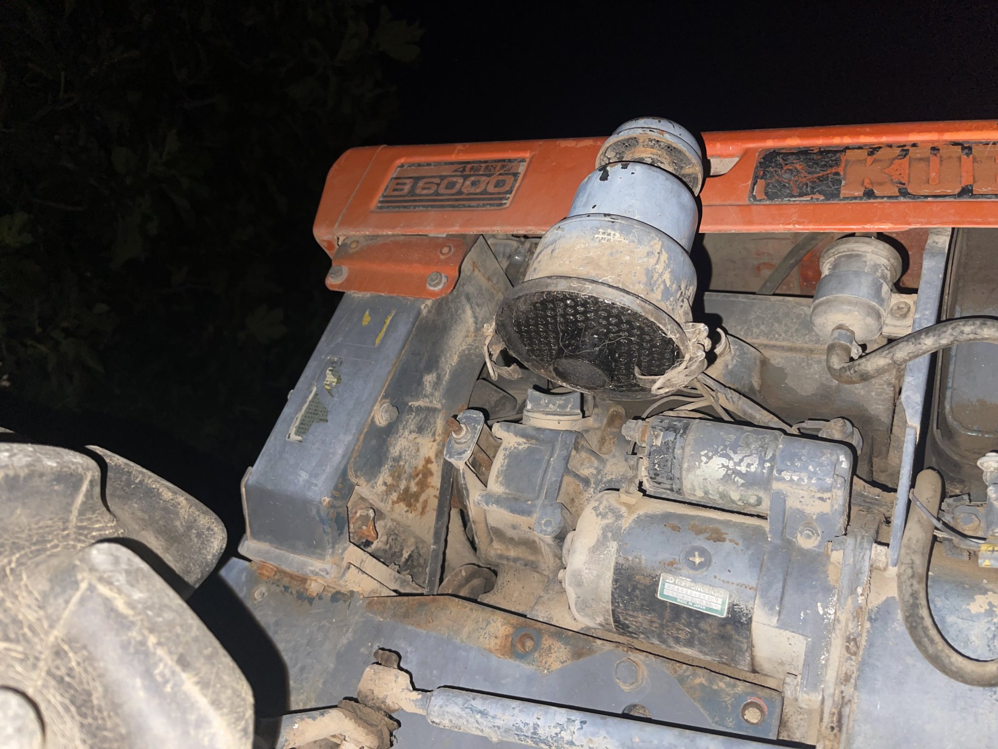

Hello, good evening. I'm Jesús, in the group, and I'd like to share the problem I'm having. I purchased a Kubota B6000 tractor, and the lower part of the air filter was lost by the previous owner, and now I can't get it back. This filter is oil-bathed, not paper-based, so I don't know how, but I'm without a tractor due to the problem I'm having with the air filter. Does anyone have any used parts to sell or know of a supplier where I can get this filter? I don't care if it's used or new; I need it. Thank you.

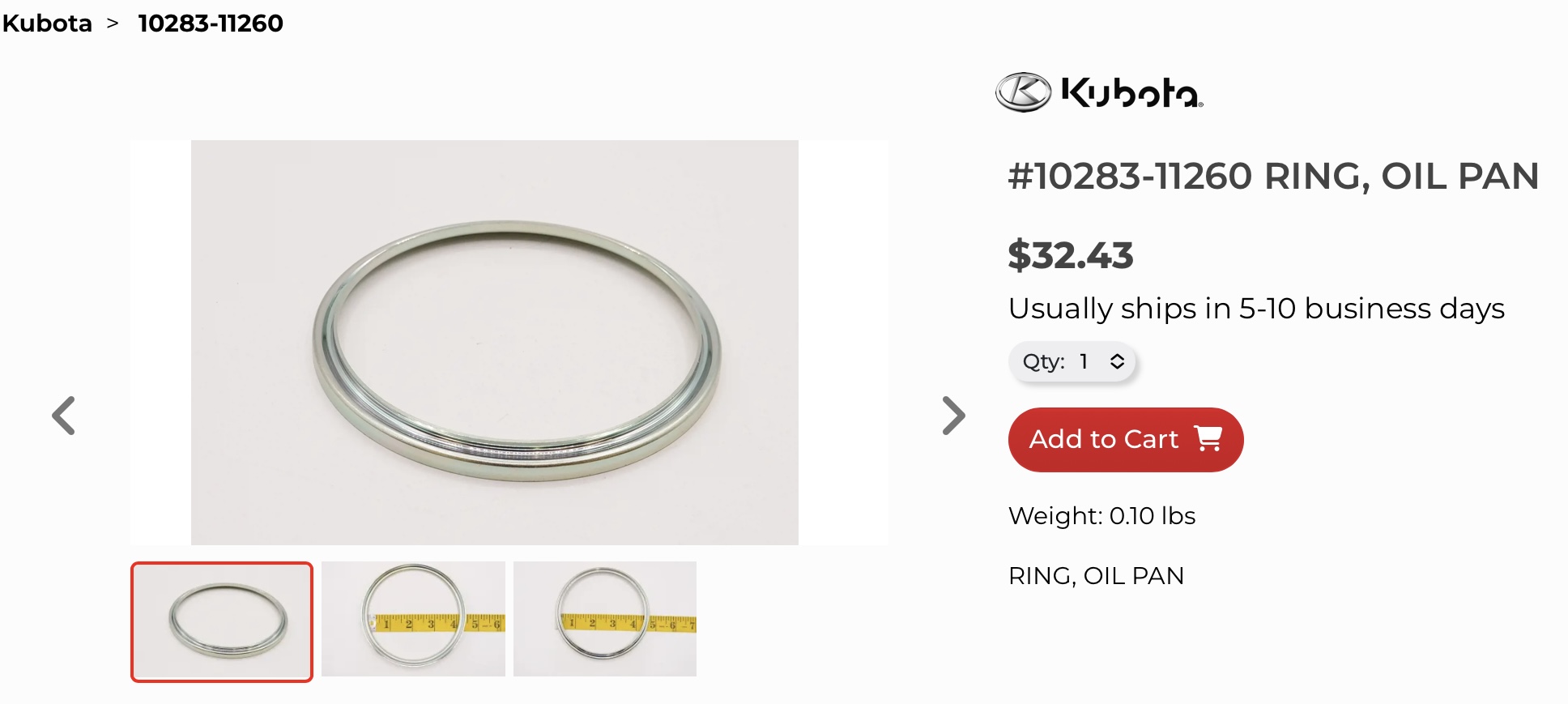

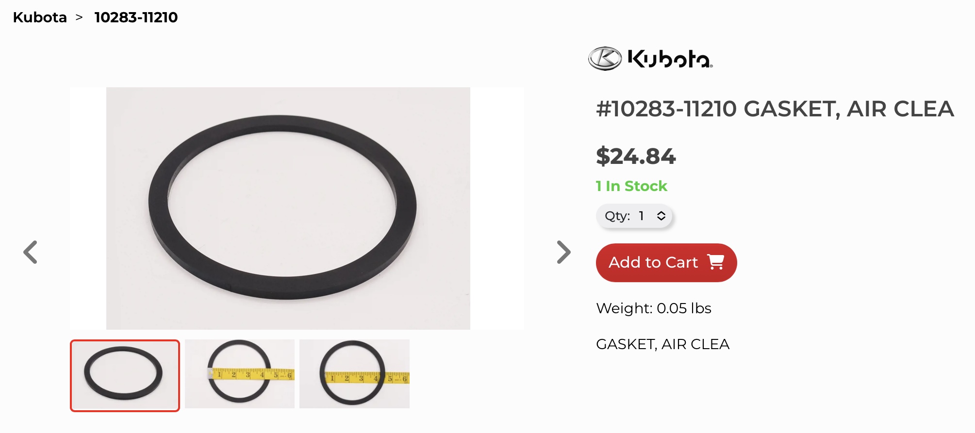

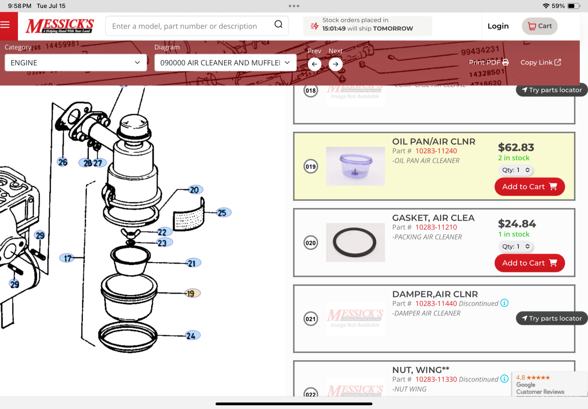

Here are some of the parts that are available (19, 20, 24). The others (21, 22) are obsolete though. I don’t think that our dealers can ship to Spain though! Ask your dealer to check if they can get these individual parts

A good machine shop can make the nut part, someone can cut the gasket. The small cup inside is just a damper to keep the oil from splashing around so could be made out of some plastic cup or bucket with some holes in it. The wing nut and washer are some standard hardware in Europe (probably).
But you might just want to find a filter housing that holds a paper filter from some newer machine and adapt that to your machine.
