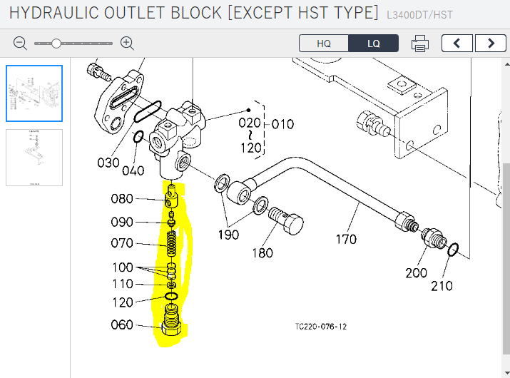

No, but I pulled the 22mm plug just forward of the filter thinking it was a drain. There was a metal “cone” that sat on top of the plug. I don’t know what it s function is.

Sounds like you took the pressure relife apart!
Did you make 100% sure all the parts when back in in the proper order.

Do these assembles come apart as two units? That is does everything between 090 and 060 stay together when you take it out of the tractor? I didn’t find any “spare” parts but I put two pieces together when I screwed it back in place.
28,664
5,094
It might stay together you just really need to make sure that Part #80 and #90 are installed in the proper direction. if either is up side down or not properly seated then the system will not work right.
