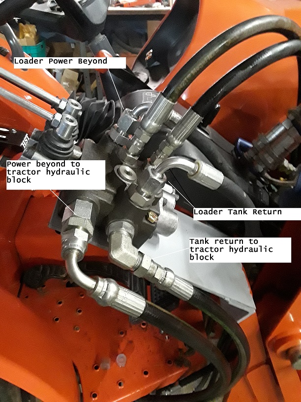

It seems like people post almost daily looking for help adding rear remotes to their tractor. Everyone seems to want a "kit" so here is my contribution to the cause. This is fitted and tested on an L3901 but should work on most "newer" open station L series machines with loader. It comes with a 1, 2, or 3 spool valve, valve mounting bracket, and all fittings and the two custom fit hoses needed to hook it into your loader circuit. Thats right - you only need 2 additional hoses and you should be able to install this in roughly 30 minutes. You don't have to know jack about hydraulics - just how to connect up 4 hoses.
