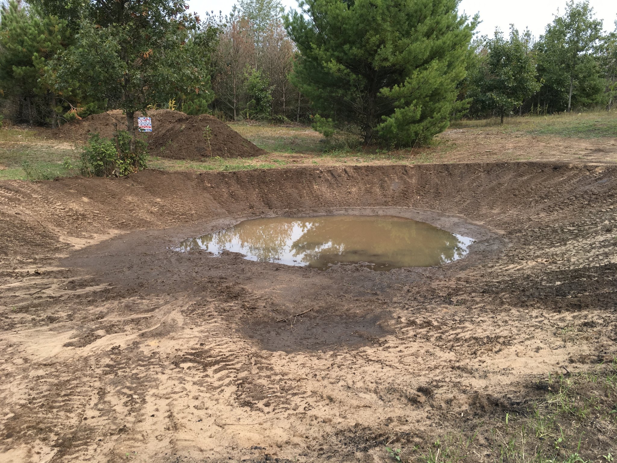

13k not being a option at the time I waited till I had the L2501 and dug a small wildlife pond in my 100 yard rifle range area. I used some of the excavated soil to build up my backstop berm. Even though I have not trucked in clay yet for a liner I have enough standing water for a while that I am already attracting wildlife. Digging this small pond has given me the confidence to dig another next spring on the far side of my land.

13k not being a option at the time I waited till I had the L2501 and dug a small wildlife pond in my 100 yard rifle range area. I used some of the excavated soil to build up my backstop berm. Even though I have not trucked in clay yet for a liner I have enough standing water for a while that I am already attracting wildlife. Digging this small pond has given me the confidence to dig another next spring on the far side of my land. View attachment 48731 View attachment 48732 View attachment 48733
Looks nice. All I have is clay as far as you can dig. It is in three states depending on the time of year. Frozen solid, too wet and heavy to get a good bite with my small tractor and too dry to get in more than an inch or two at a time.
