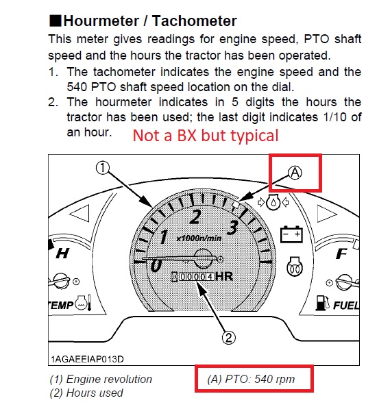

You don't mention a specific BX but in general, on the rpm dial there will be an indication of the 540 rpm pto speed which, by design will also be the correct rpm for the MMM.
Dave

As mentioned for loader work, operate the engine at whatever RPM you feel comfortable with.
According to the Operators and WSM for the BX1870, for the MMM, to get the 2500 RPM for the mid PTO it is 3043 engine rpm. Also for the rear PTO to be 540 RPM it is 3142 engine rpm. Unless you have a digital tach, being close to those engine rpms for required pto speeds will work.
