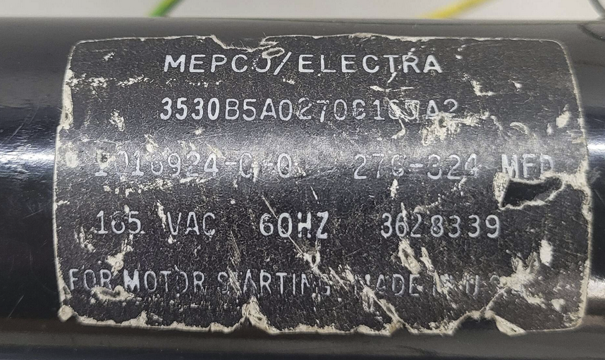

This one has the capacitor and the capacitor does indeed show 276-324 MFD.
Dustball, Thanks for the great response! I need a new search engine as I could only find one picture online of the motor…..and with no capacitor included.
The link in your post definitely shows it to be the exact same motor. And definitely a standard “electrolytic” start capacitor. Apparently, this motor was designed to get by with using this type of capacitor versus an oil filled “run” capacitor.
Sourcing this as a replacement will be easy….and cheap. However, the pics show something else that caught my eye and piqued my memory. For some reason, I’m sure I’ve seen that same mounting bracket for the capacitor shown. I’m betting the missing capacitor and bracket is lurking in a dark corner in a box of goodies here somewhere. The question is….where? LOL!
Lastly, there seems to be enough evidence in those pics to piece together exactly how the capacitor was connected to that motor’s windings. That should help to keep the magic smoke locked up inside. We shall see, once the new bearings arrive and the capacitor is found.

I do too. But I’d bet (well….almost bet :ROFLMAO:) that they’re all “capacitor start” motors with a centrifugal switch that disconnects the start capacitor almost instantly once the motor is almost up to full speed.
This motor is a permanent capacitor run motor….meaning there’s no centrifugal switch to take the capacitor and start winding out of the circuit once the motor is up and spinning correctly. This type keeps the start winding and capacitor energized as long as the motor is energized. Normally, an electrolytic capacitor can’t take the heat buildup in that scenario. They then require a “Run Capacitor” that is usually oil filled.
But maybe that rule doesn’t apply for these fractional HP motors? Here’s a pic of its rotor without any centrifugal switch mechanism.
When I get the new bearings and find the wayward capacitor, I’ll report back on its health.

Bee-Positive that’s interesting info, thanks! And it jives with my questionable memory of where this motor came from. This motor most likely came out of some equipment we scrapped at work (power company) back in the ‘70s or real early ‘80s.
Yes, it is a start capacitor….but it’s also more technically the "run capacitor" since it doesn’t have a centrifugal switch to remove it from the circuit. See the pic above. That’s what had me thinking it seemed unusually high valued for this motor. But Dustball’s link above with the pictures proved it must be engineered to work in this application.
It is a two-pole motor so nominally 3600 RPMs. A four pole motor is nominally 1750 RPMs,….etc. You might be right on your correlation between MFD and speed requirements. Your guess is as good as mine...or better! LOL!!
