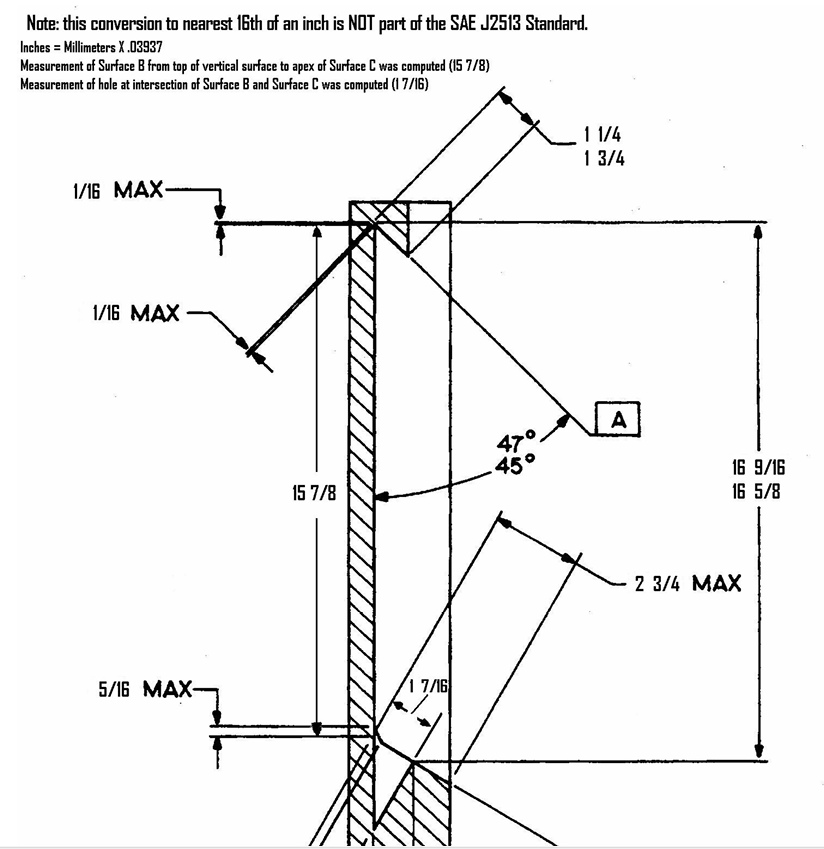

Just received my blank skid steer plate I ordered off eBay. It came 3 days after I ordered it. It is a loose fit and will require some shimming at the bottom. It's about 7/8 inch looser than my factory bucket. I knew what to expect at the time of order because they showed the top to bottom bend measurement at 16.81 inches. My bucket measures right at 16 inches. Most ALL of the plates advertised showed the 16.81 measurement. I didn't jerk on it but pretty sure I could lift it off at the top hooks if I tried hard enough
So much for all of these being a standard skid steer match.
Just giving folks a heads up what to expect when ordering these for fabbing your own loader attachments. I saw another ad showing a measurement of 18-1/8 inches which would leave a 2 inch plus gap at the bottom. No way the pins would engage on that one.

You should be able to add a 3/4 x 1 1/2 x 44" bar to the inside edge of the top to get real close to 16".
try a wooden 1x2 for a test fit.

The standard is 15-7/8 inch so it's a full inch off standard.
I have plenty of steel to make the shim from but I'm thinking I will cut up some old mower blades and stack about 3/4 inch worth. A little slop won't be all bad.

This is incredibly frustrating. I have done exhaustive research and shopping to try and find a plate made to the SAE J2513 standard and it doesn't look like ANY are available. The real mystery is why so many have favorable reviews when all the plates available are advertised to be an inch off in the top to bend measurement.
I was thinking if I could just find one that fits right I would buy that and cut the one I have up for steel.

The easiest fix for these plates is to cut the top lip off and shorten the plate and put the lip back on.

I was thinking ,just add '3/4 x 1 1/2 x 44.25" filler bar', 1 cut, and 2-3 tack welds, done in 15 minutes
NIW takes longer, might warp the steel, 2 cuts plus trimming, 2-3 cutoff blades,grind finishing, painting and at least 3 people will show up asking 'WTF did YOU screw up THIS time......?':)
either way works, whatever works for YOU is what counts....
I tend to agree with this approach. There is no force actively pulling the new "hanger lip" welds apart. The force will actually be pushing the "shim" into the hanger lip. Minor stress on those welds. If anything it bolsters the hanger. .Just MHO. Could change with new information.
Hate buying steel these days though. I do like the discussion before my own project becomes reality. Also glad these plates come with too much material rather than too little...
I wouldn't cut the top off and re-weld since it's already fabricated to the correct angle. Add a shim plate under the lip and weld it on. That will be stronger.

One thing I saw right away was the top needs a gusset plate in the middle. Can picture that getting a bow to it after some time. That is the part of the attachment with the most stress on it.

I have a plasma torch but cutting the top off isn't in any part of my plan. This should be a simple shim job. I haven't taken much time to look at and evaluate it yet but I might get some time today.
@Yooper I do like your suggestion to gusset the top lip.
I am actually going to measure and consider the possibility of making this also fit the JDQA if I can do that and retain the SSQA fit. At a glance it looks like the JDQA hooks would ride right in the middle of the SSQA connectors. Will know better about that when I get my John Deere back from my Son in Law.
