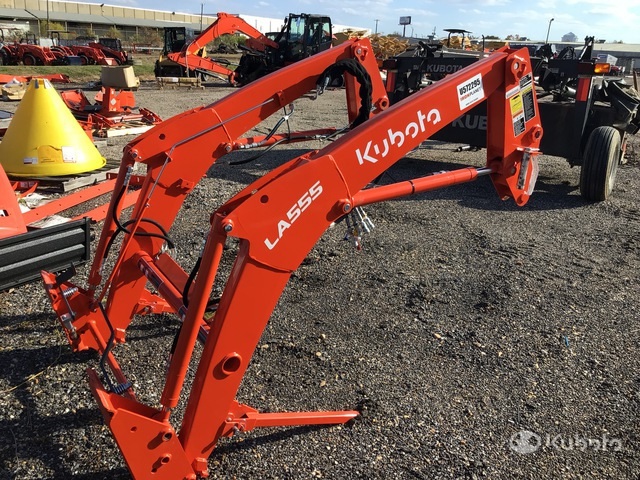

The answer lies in the ease with which the 555 can be removed and re-installed.
Here is a picture of the 555 removed.
The vertical part of the loader frame easily comes off the on tractor hardware.
The LA514 is much more difficult to remove and the two lift arm cylinders are just flopping around once their pins are removed
In my experience having lived with the old style for many years before moving up to quick attach, spend the money now and you wont regret it over the many years of owning this tractor.

You sure about that Dave?
This looks pretty quick attachy to me.

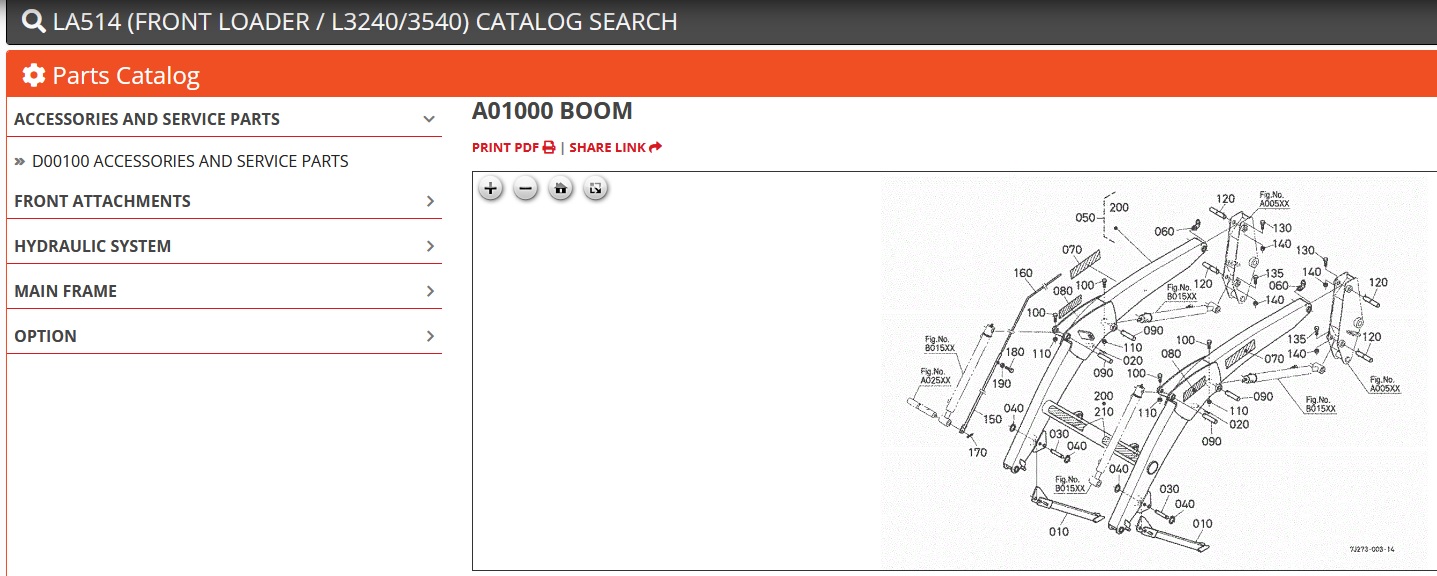

Ok, let me rephrase. There are two types of SSQA front attachments - one is part number 7J290-36100 (which I have seen also referred to as the LA555 or L2217), it is the SSQA for the bucket and implements. It has a square tube welded between the SSQA plates and levers at the top.
The other is part number 7J273-36100 (which I have also seen referred to as LA514 or L2216). It is the SSQA for the bucket and implements, but instead of a square tube welded at the top, it has a pipe welded between a little further back and towards the middle.
Both come up under the LA524 loader parts drawing on kubotausa.com parts website. Drawings Here
One is significantly more expensive than the other, assume that is because it was possibly redesigned?
