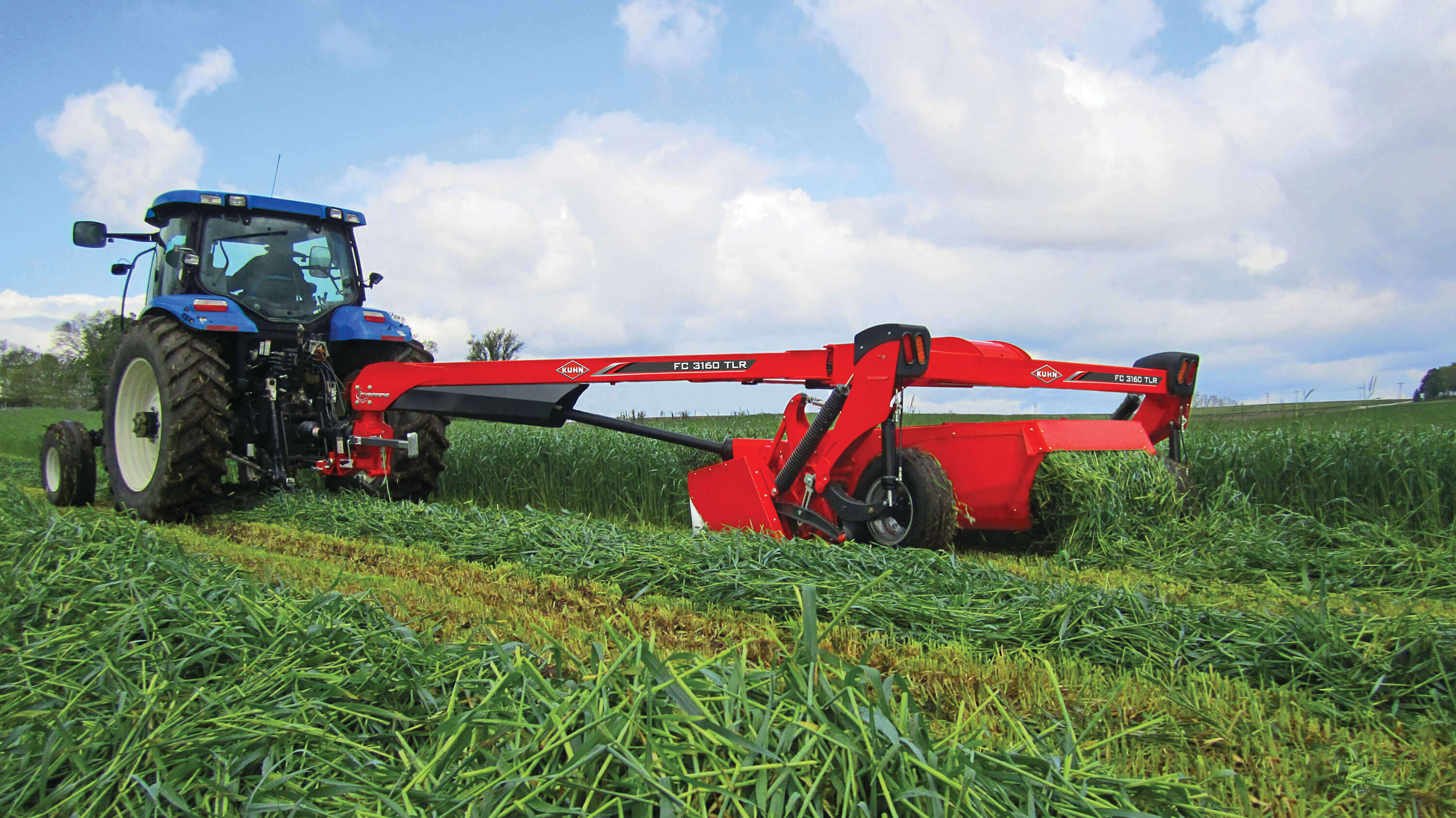

Ibex is an Italian company that has a very good reputation for flails, mowers etc. Kuhn is well regarded too. I've never used or owned a drum mower or a disc mower, just an Italian made flail mower.

Yeah, Ibex is on my list. Hadn't heard of Kuhn, thanks. Do you have any opinions about Titan Attachments?
