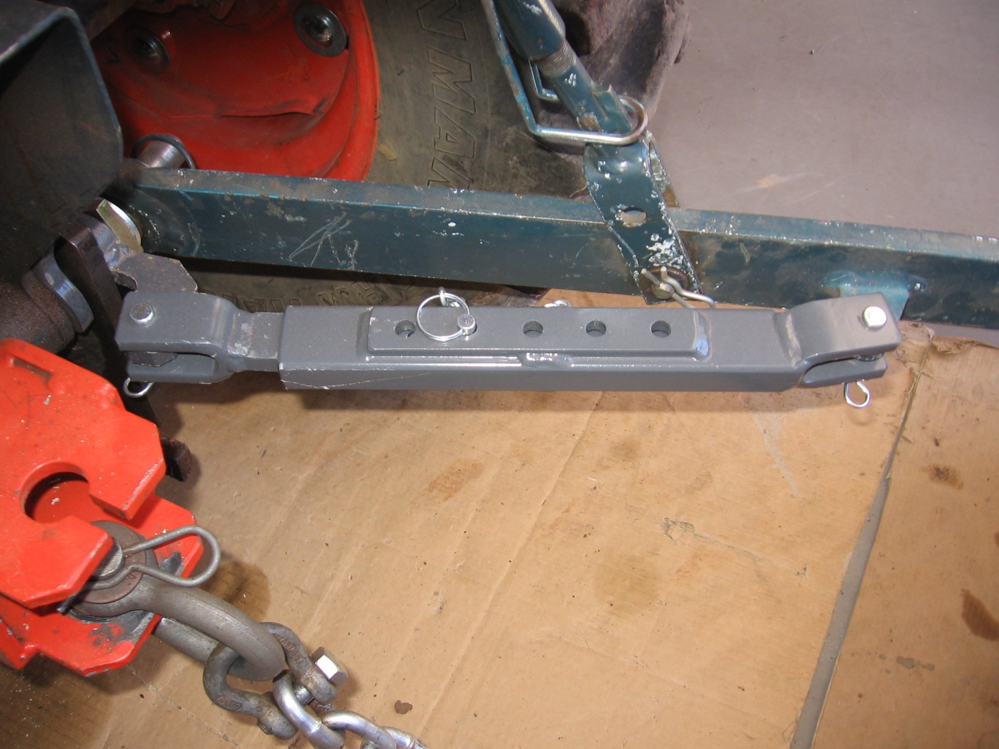

I used a couple clevises (clevii?) to hook a chain on that stays permanently hooked to the tractor.
