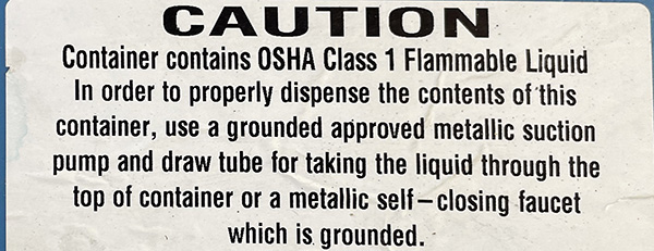

Started to get set up together with pump, hose, fittings. UH OH don't have a barrel bung opener. Well, guess I do, sorta:
So here's the setup. SEE the FLAMMABLE LIQUID label??
OK so 1/2 OD soft copper tubing 3 ft long. 1/2 " heater hose. RV drinking water pump, RV fittings to 1/2" 8Ft long grounding cable..

Here's the pump I used: notice I connected negative lead to metal frame so it's grounded to tractor.

I never knew windshield fluid was flammable! I never messed with a ground wire. Here's how I did it. Jack the rear tires up an inch to take the weight off. The gallon jugs fit perfectly in the fill hole for the 15 gal tank. I bought the fitting designed to fill liquid into the tires at NAPA and never used it. With pump on spray tank each tire took about 10-15 minutes. I pumped a few gallons, then removed the hose to let it burp. Did that three or four times on each tire.
