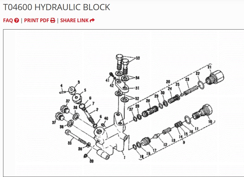

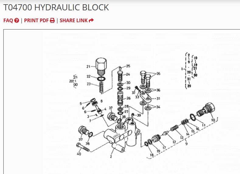

I think he means "Hydraulic Block Outlet type."
It would help to know which model of B8200 he has. HST or manual gear box.
Possibly one of the following two:
How many lines connect to the FEL valve? 6 or 7?
Are there any quick couplings for hydraulic lines on the tractor and/or loader?

Dave I just read your questions, sorry for late response, my block is the T04700 block and my hoses to the FEL are quick disconnects.
