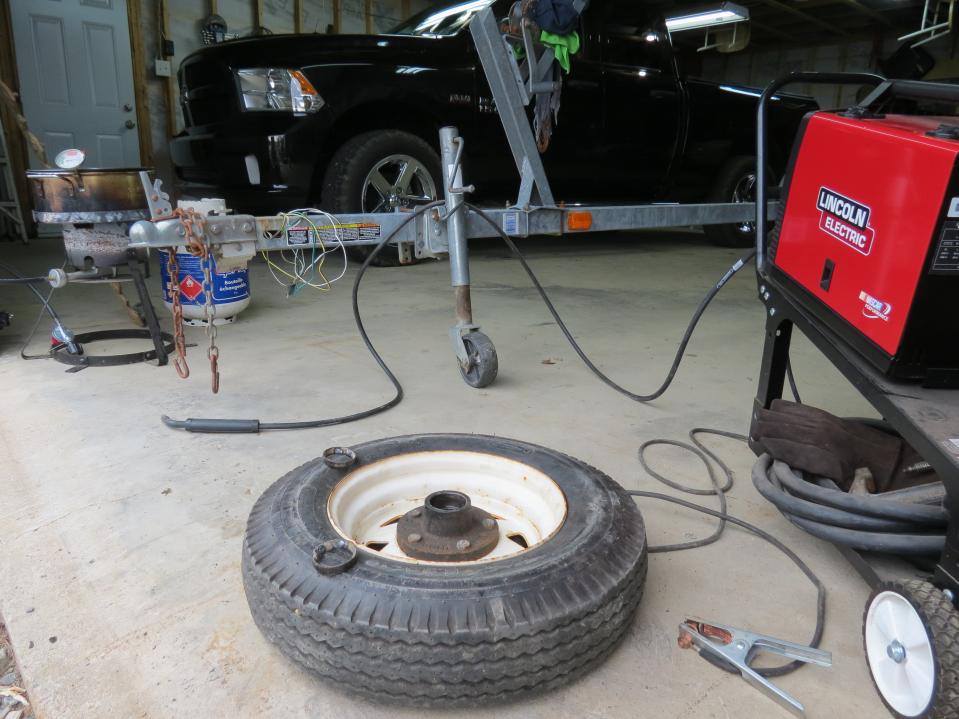

Dilemma, I just started doing the bearings on my boat trailer, just a small trailer and a 16 foot open boat that I've had for years...joked about it for a long time that it's the only thing that I've kept for all these years besides my wife. Anywho I've replaced a lot of bearings in many things but this one is fighting back. There is no way I can catch an edge on the race in order to knock it out. So my question is, is there a way to knock them out that I'm missing or for the amount of time this trailer see's the road, maybe 100 miles or so in a year do I just leave the races in and just replace the bearings. If I had a dermel with a good bit I'd just make a couple notches so I have something to grab. I guess I'm just being stubborn because I've never let anyone else work on my stuff but I guess I already know the answer.

Bearbait, you're about to stumble across the answer for a different reason.
I was shown that trick a few years ago, it's almost too easy. As long as you don't strike the ark in front of the race it will almost fall out on it's own. Weld a bead in 2-3 places on the inside of the race itself, let it cool a minute or so, than tap it out. I had a swing arm bearing in a Honda ATV that I bought a internal bearing puller for, after bending and breaking the puller, I tried the weld trick. I let it cool completely then pulled it out with my fingers!

As already mentioned, run a skip bead around the working surface of the race. As it cools, the bead will contract and reduce the diameter of the race. Removal should be a piece of cake after that.
